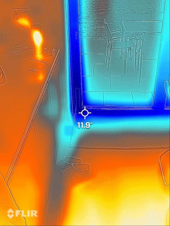

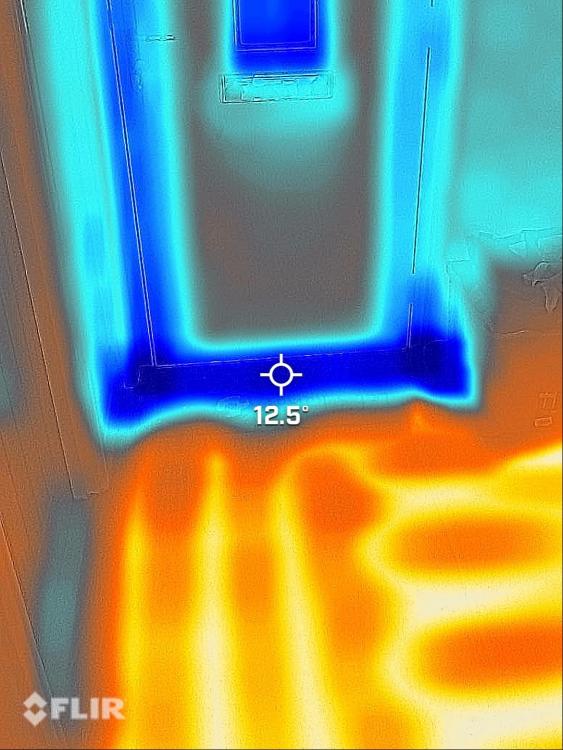

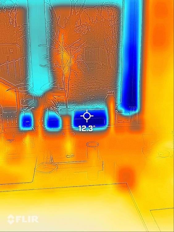

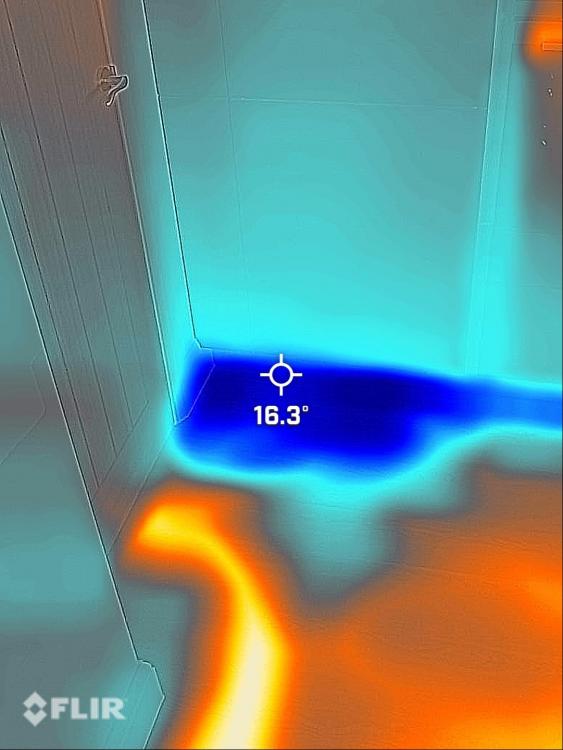

Olf Posted January 12, 2022 Share Posted January 12, 2022 12 minutes ago, rhymecheat said: House just got fully renovated and properly insulated. Downstairs is UFH and it seems to be the only area that never reaches desired temperature (max I can get with 35C is about 19.3C over a period of about 6/7 hours) What is the floor finish downstairs? Do you know the thickness of floor insulation? Perimeter insulation (not 5mm lagging only) present? 30kWh of heat (or x COP, as you were quoting leccy use I believe) is dissipated somewhere each day, so the question is to find where. 12 minutes ago, rhymecheat said: Used a FLIR camera Can you use it to confirm flow and return temperatures, in case ASHP have sensor/wiring/mapping fault? Link to comment Share on other sites More sharing options...
rhymecheat Posted January 12, 2022 Author Share Posted January 12, 2022 11 minutes ago, Olf said: What is the floor finish downstairs? Do you know the thickness of floor insulation? Perimeter insulation (not 5mm lagging only) present? 30kWh of heat (or x COP, as you were quoting leccy use I believe) is dissipated somewhere each day, so the question is to find where. Can you use it to confirm flow and return temperatures, in case ASHP have sensor/wiring/mapping fault? Floor is amtico on a 40mm insulation I believe. Not sure about perimeter insulation. I’ve used the FLIR on the pipes. Right now leaving temperature is at 35C. Inlet at 36C Link to comment Share on other sites More sharing options...
Luke1 Posted January 12, 2022 Share Posted January 12, 2022 37 minutes ago, rhymecheat said: I’m hypothesising. I’m asking here to be corrected or validated. If I see two things that are strange I can’t help but think they’re related to the same issue. More probable then there being two separate issues. The unit is a Daikin Altherma 3 H HT. indoor unit is the etbx16ef6v (the wall mounted one). House just got fully renovated and properly insulated. Used a FLIR camera to look for week spots and couldn’t find any obvious ones. the heatpump is new and is replacing a 35 year old boiler that couldn’t even heat the house to 16C in the winter. All the pipes have been replaced, all the rads replaced for bigger low temperature ones. Downstairs is UFH and it seems to be the only area that never reaches desired temperature (max I can get with 35C is about 19.3C over a period of about 6/7 hours). I could increase the leaving temperature but then the costs become even higher. yes, analysis was done but I have no access to it unfortunately. Could it also be that the system is compensating for a big change in your desired room temperature? Are you running the system in Weather Compensation mode and are you generally keeping the house at a steady temperature, minimising the use of any setback temperatures? UFH and especially ASHP benefit from longer run time and not in short bursts, but I'm sure you're already aware of this? Link to comment Share on other sites More sharing options...
rhymecheat Posted January 12, 2022 Author Share Posted January 12, 2022 5 minutes ago, Luke1 said: Could it also be that the system is compensating for a big change in your desired room temperature? Are you running the system in Weather Compensation mode and are you generally keeping the house at a steady temperature, minimising the use of any setback temperatures? UFH and especially ASHP benefit from longer run time and not in short bursts, but I'm sure you're already aware of this? Yes good point. I’m running it at a constant 35C but setting the thermostats to go down during the night. During the night the thermostat is set to go from 20 to 18. At this stage the leaving temp from the heatpump can go too as low as 25C (but not lower). But, in the morning when I come down it read 17.3 and in the evening when I go up it’s never above 19.3. Link to comment Share on other sites More sharing options...

J1mbo Posted January 12, 2022 Share Posted January 12, 2022 You need to understand the building heat loss to draw any conclusions here. My advise (FWIW) would be to contact the installer and get that. Then set the system to run 24x7 for a week and start making measurements after that, as currently the consumption is feeding thermal loss and increasing the stored thermal energy of the structure each day (which is then dissipated outside of the heating period). Coupled with monitoring the outside temperature (e.g. degree days for the location), the energy supplied can then be compared to the calculated thermal loss of the structure and some conclusions drawn from that. Link to comment Share on other sites More sharing options...
ProDave Posted January 12, 2022 Share Posted January 12, 2022 So you had an oil boiler that struggled to keep the house warm. You have replaced it with a heat pump that is probably lower power than the previous boiler (I have failed to find what output power this heat pump is, Daikin don't make it easy to find out) and still have the problem that downstairs does not heat up enough. You are relying on the improvements to insulation to even make the new lower powered heat source work for your house, but don't seem to know much about the insulation fitted. You talk of 40mm floor insulation, if that is all you have it is WAY too little for under floor heating. Did you pay for all the upgrades to insulation and the heat pump install as a package to one company? If so I would be getting them back to sort it out. If you are struggling with an outside temperature of 8 degrees, you are really going to struggle when it gets properly cold. To give us some idea of expectations, how much oil did you burn in a year with the previous boiler? That will give an idea of the heat losses of the house prior to any improvements. Unless they fitted a dedicated electricity meter for the heat pump, or your has it's own metering built in, it is hard to actually measure how much it is using. In our house the heating is only about a quarter of all electricity usage. Link to comment Share on other sites More sharing options...
rhymecheat Posted January 12, 2022 Author Share Posted January 12, 2022 4 minutes ago, ProDave said: So you had an oil boiler that struggled to keep the house warm. You have replaced it with a heat pump that is probably lower power than the previous boiler (I have failed to find what output power this heat pump is, Daikin don't make it easy to find out) and still have the problem that downstairs does not heat up enough. You are relying on the improvements to insulation to even make the new lower powered heat source work for your house, but don't seem to know much about the insulation fitted. You talk of 40mm floor insulation, if that is all you have it is WAY too little for under floor heating. Did you pay for all the upgrades to insulation and the heat pump install as a package to one company? If so I would be getting them back to sort it out. If you are struggling with an outside temperature of 8 degrees, you are really going to struggle when it gets properly cold. To give us some idea of expectations, how much oil did you burn in a year with the previous boiler? That will give an idea of the heat losses of the house prior to any improvements. it’s the EPRA14DV3 on this brochure: https://www.daikin.co.uk/content/dam/dauk/document-library/Brochures/Heating/Heating Installer brochures/Daikin Altherma 3 H HT_767.pdf Heatpump installation was done by one company and house upgrade by another. The property was massively extended so all both companies had to work with was the drawings regarding calculations. Both plumber responsible for the build and the heatpump engineer were in contacting regarding what the UFH should look like but ultimately plumber installed it. Heatpump engineer however, was fully in charge of the rads. With the old boiler, total consumption for last year was 14890kwh if that helps. Link to comment Share on other sites More sharing options...
ProDave Posted January 12, 2022 Share Posted January 12, 2022 So it's a 10kW heat pump then. Probably half the power of the previous oil boiler (that struggled to heat the original house) so lets hope the now enlarged house really has some better insulation. you NEED to pester the builder to find what calculations they did about the expected heat loss of the enlarged and hopefully improved house now, AND find out exactly what insulation has been placed under the UFH pipes. Assuming the enlarged, but better insulated house still needs the same amount of heat, then 14890kWh of heat delivered by a heat pump at a COP of 3 and a present electricity price of 20p per kWh will cost £992 pa Link to comment Share on other sites More sharing options...
