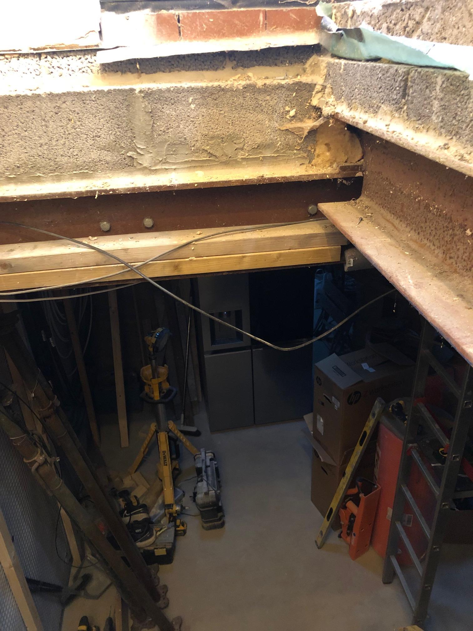

Pocster Posted January 10, 2022 Share Posted January 10, 2022 I'm going to have a suspended ceiling below these 2 steels. So somehow I need to fix plasterboard ( or something ) to them . How should I fix to the steel though?. I assume a timber batton is what I need. But I can't see drilling the steel to be fun ( also can only bolt from one side not the other ). Presumably there's a standard method to do this???? Link to comment Share on other sites More sharing options...
Pocster Posted January 10, 2022 Author Share Posted January 10, 2022 Might want to even tile these returns - so assume glueing battons for tile backer board not really ideal.... Link to comment Share on other sites More sharing options...
Mr Punter Posted January 10, 2022 Share Posted January 10, 2022 Shotfire timber with Hilti gun. Cheap to hire. Link to comment Share on other sites More sharing options...

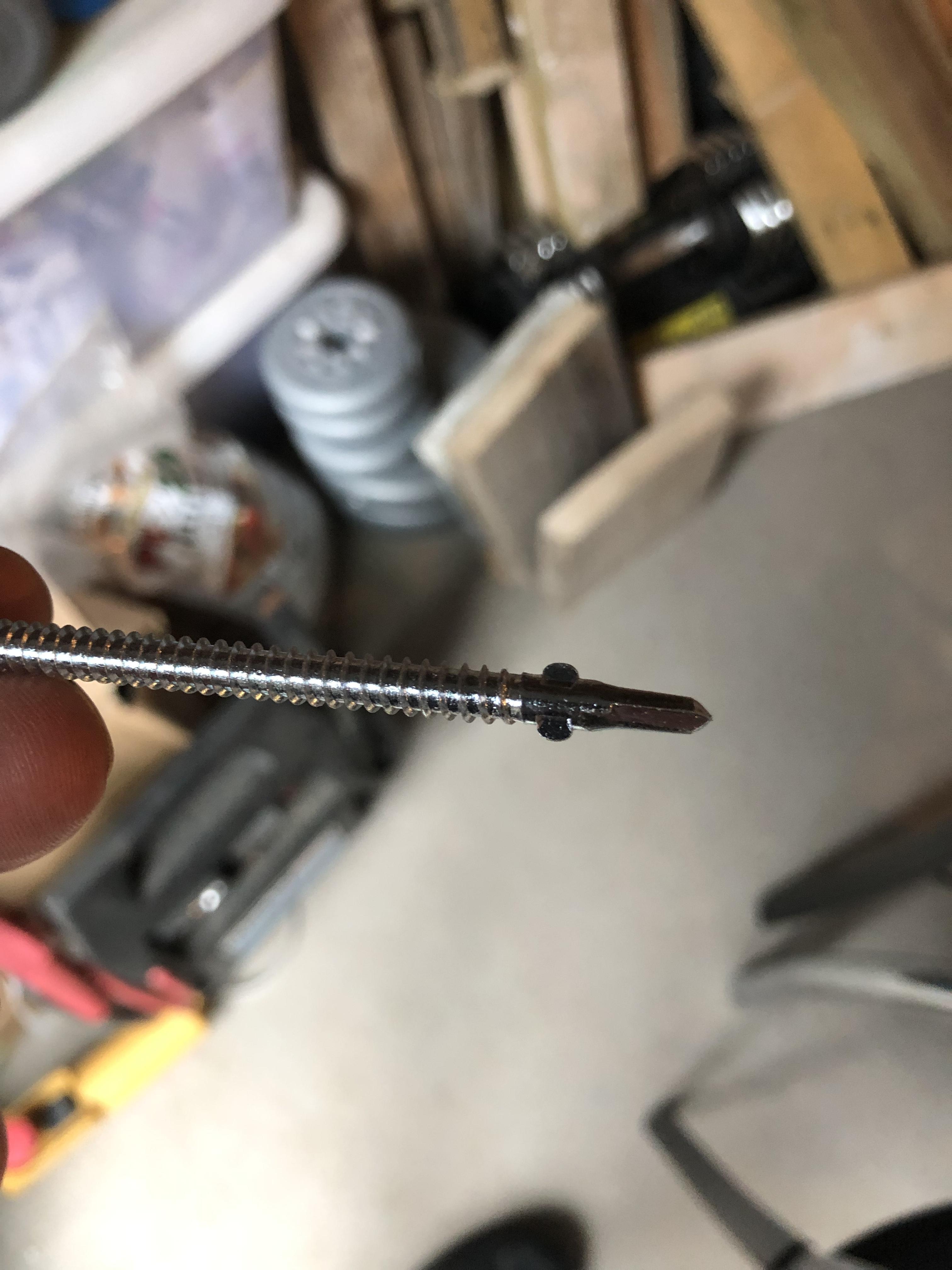

Onoff Posted January 10, 2022 Share Posted January 10, 2022 TechFast screws are designed to fix light timber frames to steel and will self drill the steel. They take a Torx driver. Even a girlie DeWalt cordless should be able to put them in ? 1 Link to comment Share on other sites More sharing options...
redtop Posted January 10, 2022 Share Posted January 10, 2022 9 minutes ago, Onoff said: TechFast screws are designed to fix light timber frames to steel and will self drill the steel. They take a Torx driver. Even a girlie DeWalt cordless should be able to put them in ? We did exactly this and used loads of them. Advice is to pre drill with a 3 or 4 mm bit as it helps these go in really easy 1 Link to comment Share on other sites More sharing options...
Pocster Posted January 11, 2022 Author Share Posted January 11, 2022 18 hours ago, redtop said: We did exactly this and used loads of them. Advice is to pre drill with a 3 or 4 mm bit as it helps these go in really easy Yeah I struggled with these. I will pre drill a hole and test I think Link to comment Share on other sites More sharing options...

Conor Posted January 11, 2022 Share Posted January 11, 2022 I drilled a 6mm hole and used 7.5mm concrete screws. A bit overkill tbh. 1 Link to comment Share on other sites More sharing options...
Pocster Posted January 11, 2022 Author Share Posted January 11, 2022 Found some of these . So will give them a try . Says “ specialist “ on them - I am certainly special ! 1 Link to comment Share on other sites More sharing options...
redtop Posted January 11, 2022 Share Posted January 11, 2022 10 hours ago, pocster said: Found some of these . So will give them a try . Says “ specialist “ on them - I am certainly special ! End is painted black so goto be good! Pre drill makes em perfic. I bought a big multi pack of cheap drill bits from screwfix or toolstation, all different sizes don't last that long but dead cheap and went through steel a fair few times before going blunt. Something like a pack of 100 for not much. Link to comment Share on other sites More sharing options...
