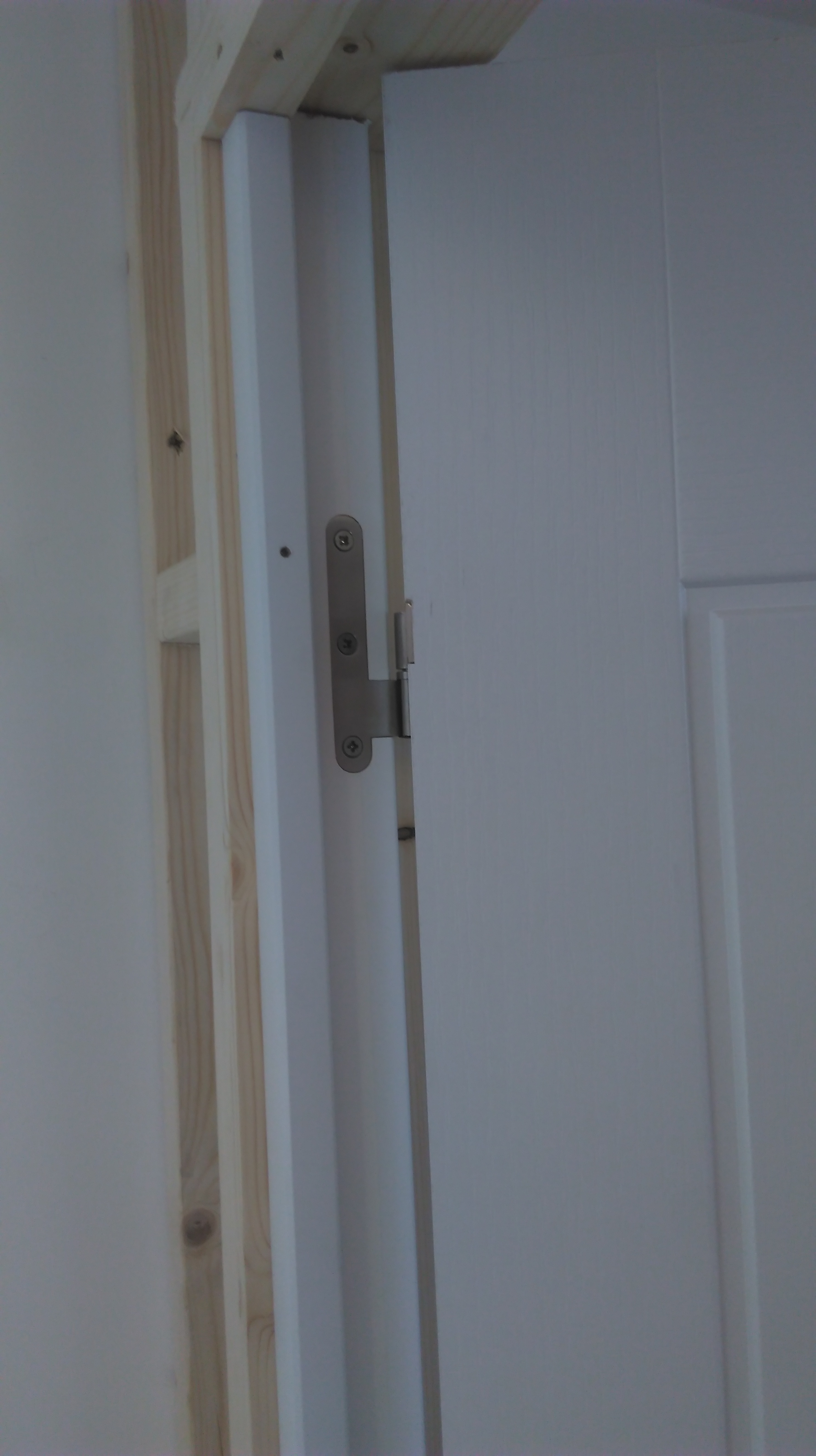

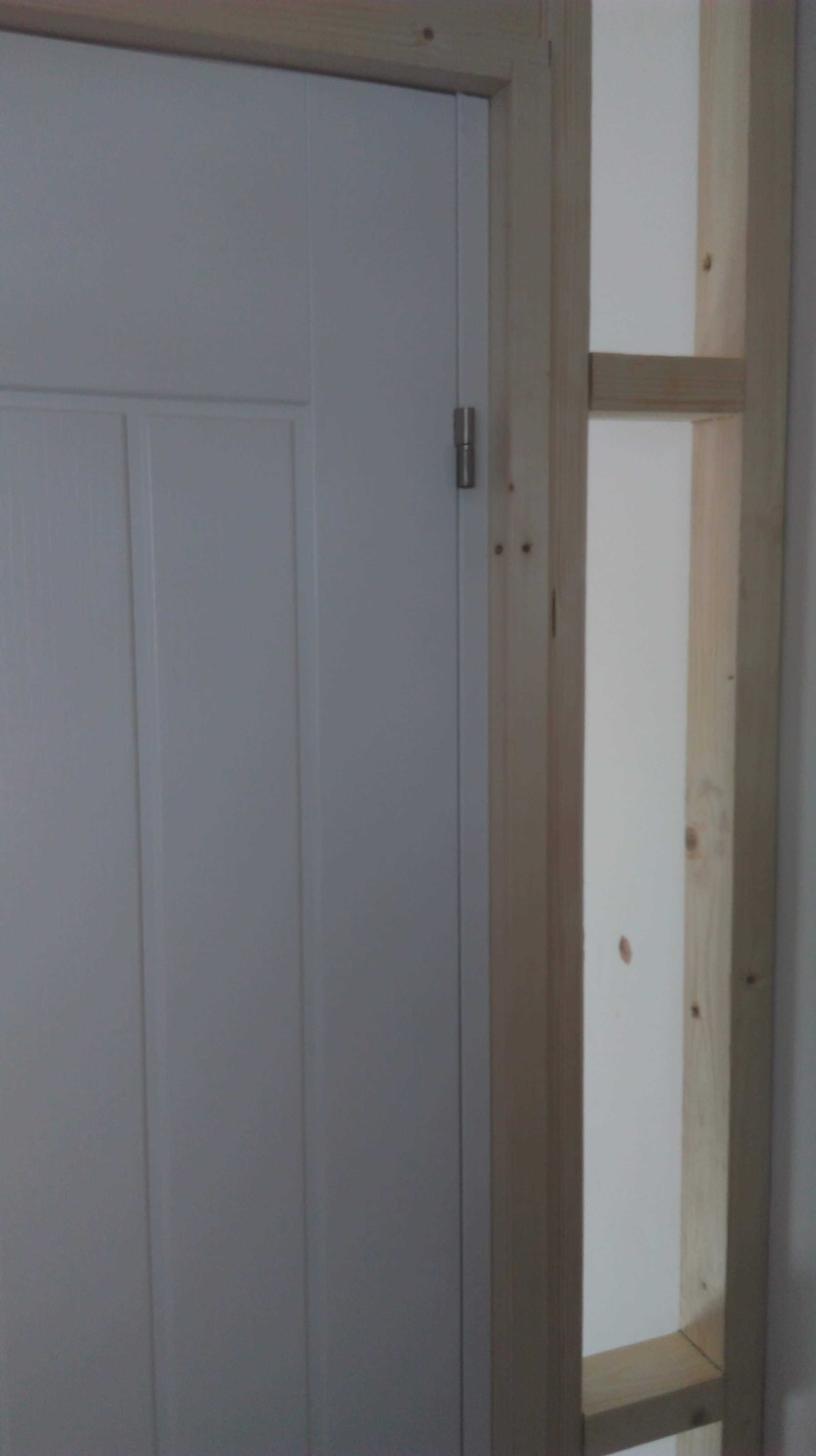

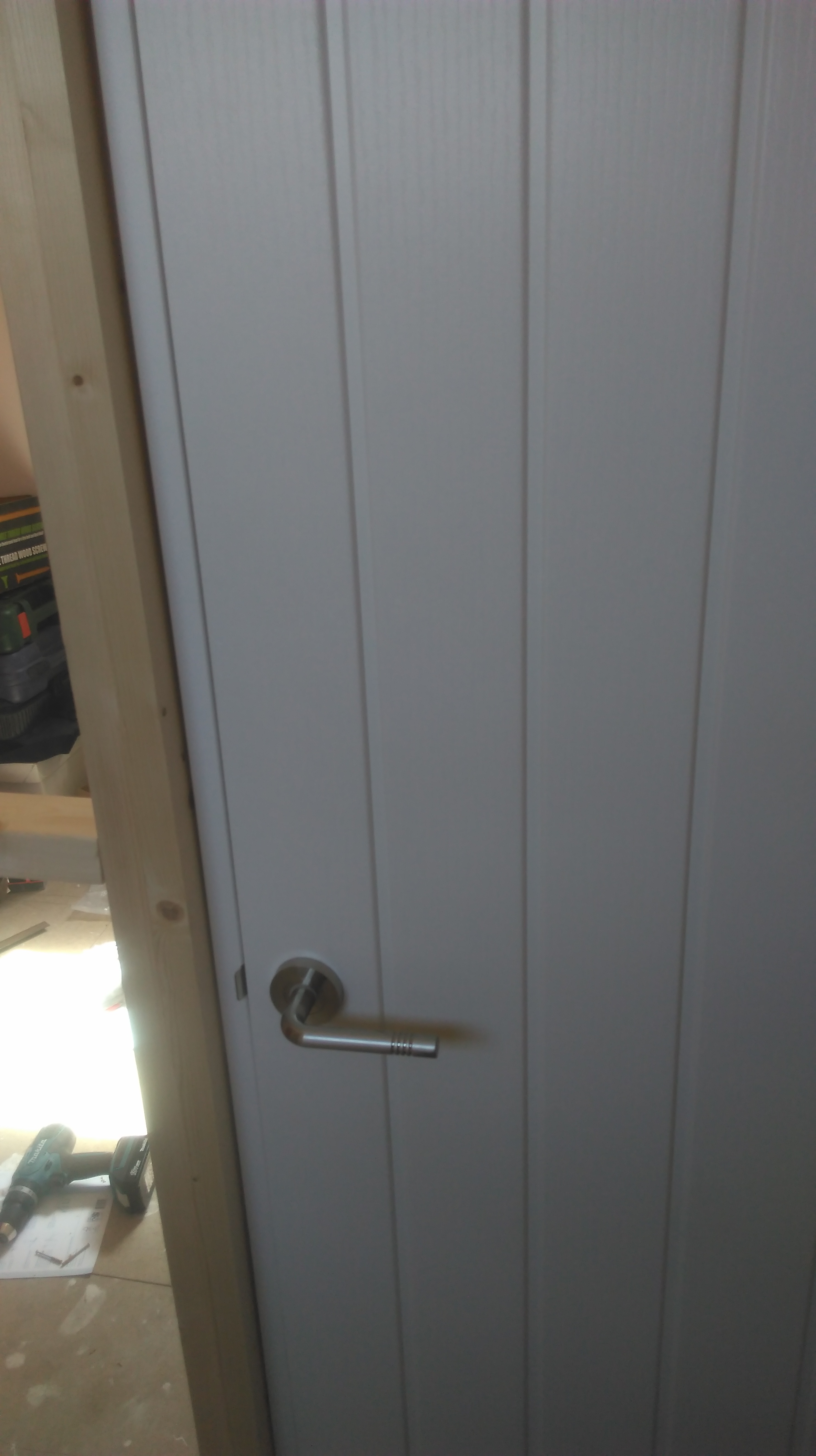

Tennentslager Posted May 1, 2017 Share Posted May 1, 2017 Quick fit said a non joiner could do this in 20 minutes...took me 2 hours. While pretty pleased with the result I think this system is really designed for retro fitting existing doors. Pack comes with door, 2 linings/ standards, pre routed for hinge and door plate (exactly same width as the door they are) and 2 x trim pieces....no trim for the head. I'm fairly happy with the result as the door fits perfectly and the hinge and striker look great being factory made. Not as good as a pro job though. I I also bought a standard door lining kit, so 72 for door, 12 for lining kit and 13 for the handle. 97 squids! Link to comment Share on other sites More sharing options...
Nickfromwales Posted May 1, 2017 Share Posted May 1, 2017 I'm a bit confused as to why the door isn't wide enough for the lining, and what is going on with the head? I think this door is designed to go into a 50mm metal stud wall with 12.5mm PB each side, hence being so narrow. With the surrounding timber work painted white though, I think you'll get away with that no probs. . I do like the hinges. Link to comment Share on other sites More sharing options...
PeterW Posted May 1, 2017 Share Posted May 1, 2017 They are designed to go into an existing frame - nice vid on the B&Q website Link to comment Share on other sites More sharing options...
