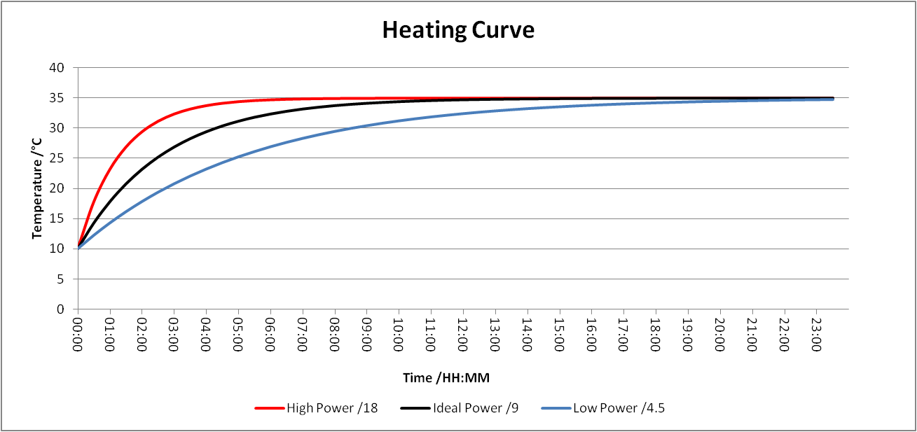

SteamyTea Posted December 29, 2021 Posted December 29, 2021 Just done a quick chart about a heating curve. Assumed 3 different power levels, half power, ideal power and double power, the numbers are for reference and not actual power. Because heating starts rapidly, then slows, for any power input, it should be possible to initially run a heat source at lower power for a set time, then ramp up power later on. This could be useful if using PV to supplement the grid supply as it would reduce imports. It may also be useful to reduce cycling and frosting.
dpmiller Posted December 29, 2021 Posted December 29, 2021 don't you need to consider the Delta as well tho, both across the source (the ASHP's internal heat exchanger) and the "radiator", whether it be UFH or wall panel? The controller we're looking at here is smart enough to consider the compressor and gas combo's efficiency islands and will throttle back based on energy transfer- it'll slow the compressor down, speed the water pump up, adjust the superheat levels and fan speed to keep the gas pressures sensible.
SteamyTea Posted December 29, 2021 Posted December 29, 2021 8 minutes ago, dpmiller said: adjust the superheat levels and fan speed to keep the gas pressures sensible. Is that how your HP controls temperature by keeping the pressure within fixed limits? PV/T = C and all that.
dpmiller Posted December 29, 2021 Posted December 29, 2021 2 minutes ago, SteamyTea said: Is that how your HP controls temperature by keeping the pressure within fixed limits? PV/T = C and all that. All of the above, yes, kinda. Variable limits actually... I think Carel and whoever wrote the GUI show a bit more of the inner workings of these than some of the more mainstream consumer brands tbh and I'm pretty nosey The control system is modular with an internal ModBus between portions- Inverter, fan drive, analogue ins, EV stepper motors. The inverter and mainboard both have stored profiles for the compressor tying expected pressures vs power inputs etc, as an envelope that rest of the sensors and controls work within. 1
SteamyTea Posted December 29, 2021 Posted December 29, 2021 3 minutes ago, dpmiller said: All of the above, yes, kinda. Variable limits actually Seems a simple way to control it. It should stop the HP doing something that is impossible, i.e. reach a fixed output temperature when the input temperature is extremely low. 1
