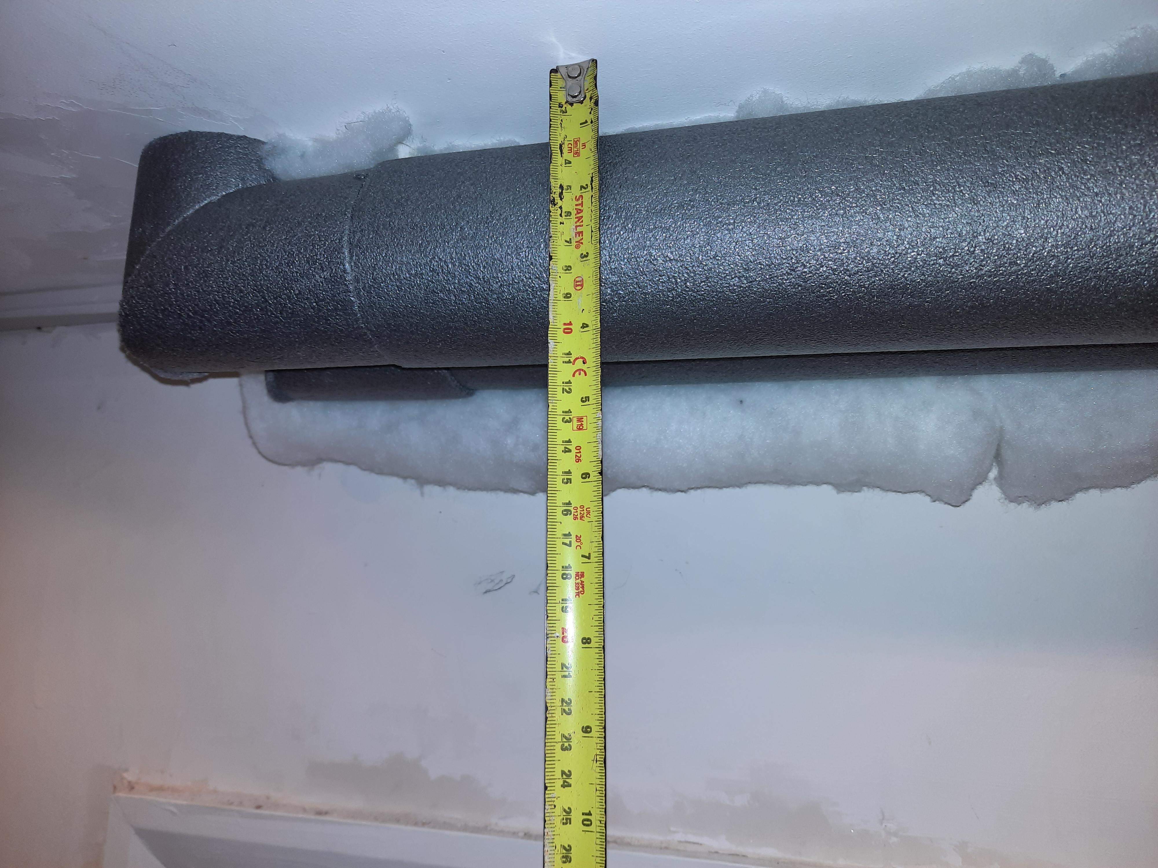

As the ASHP heating water temperature is already lower than that from a boiler every loss from the ASHP pipe work is a greater percentage.  These are some of the other items we have worked on:
  • Made the length of pipe work between the ASHP and hot water tank and buffer tank as short as possible: less than 5 meters in one direction.
  • Insulated the ASHP to tanks pipework to within an inch of its life. 25 -  28 - 25mm walled Climaflex minimum with additional insulation where possible, especially the pipes from the ASHP which are outside the thermal envelope (an additional 100 to 150mm thick fluffy wrapped in EDPM and taped together.)
  • Additionally insulated the buffer tank and hot water tank even though both are within the thermal envelope.
  • Additional insulation to all heating pipework where possible.
Finally completed my RHI application today.
M

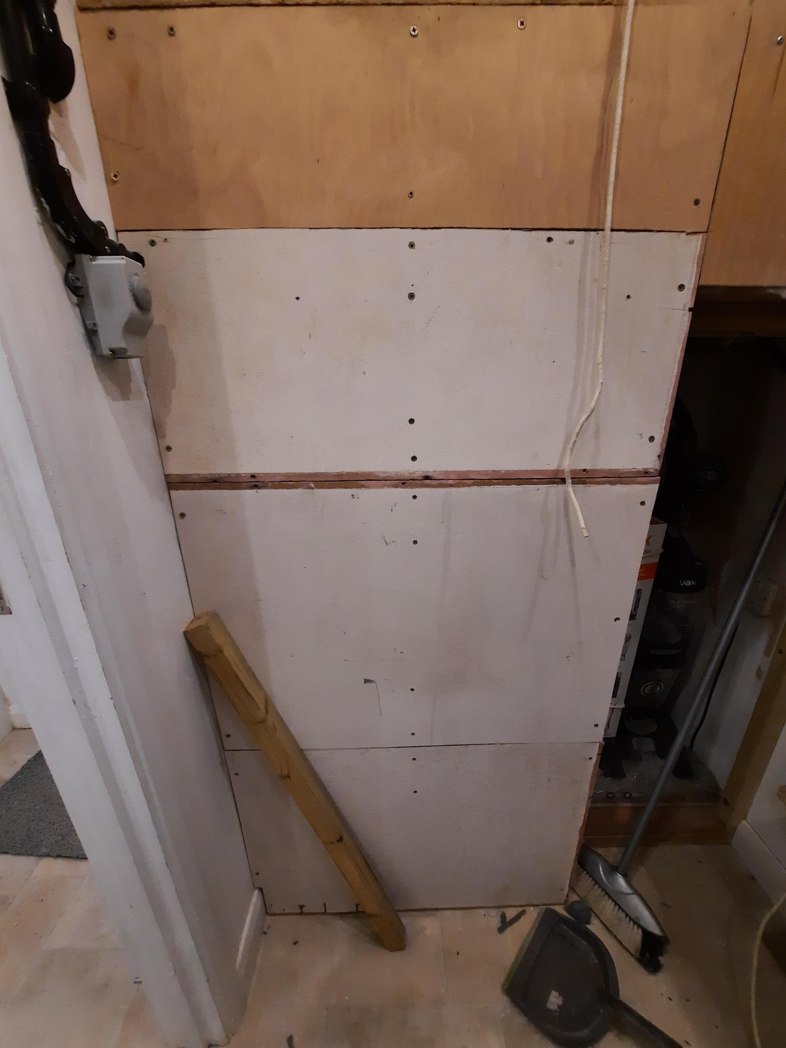

Primary pipework insulation with additional insulation

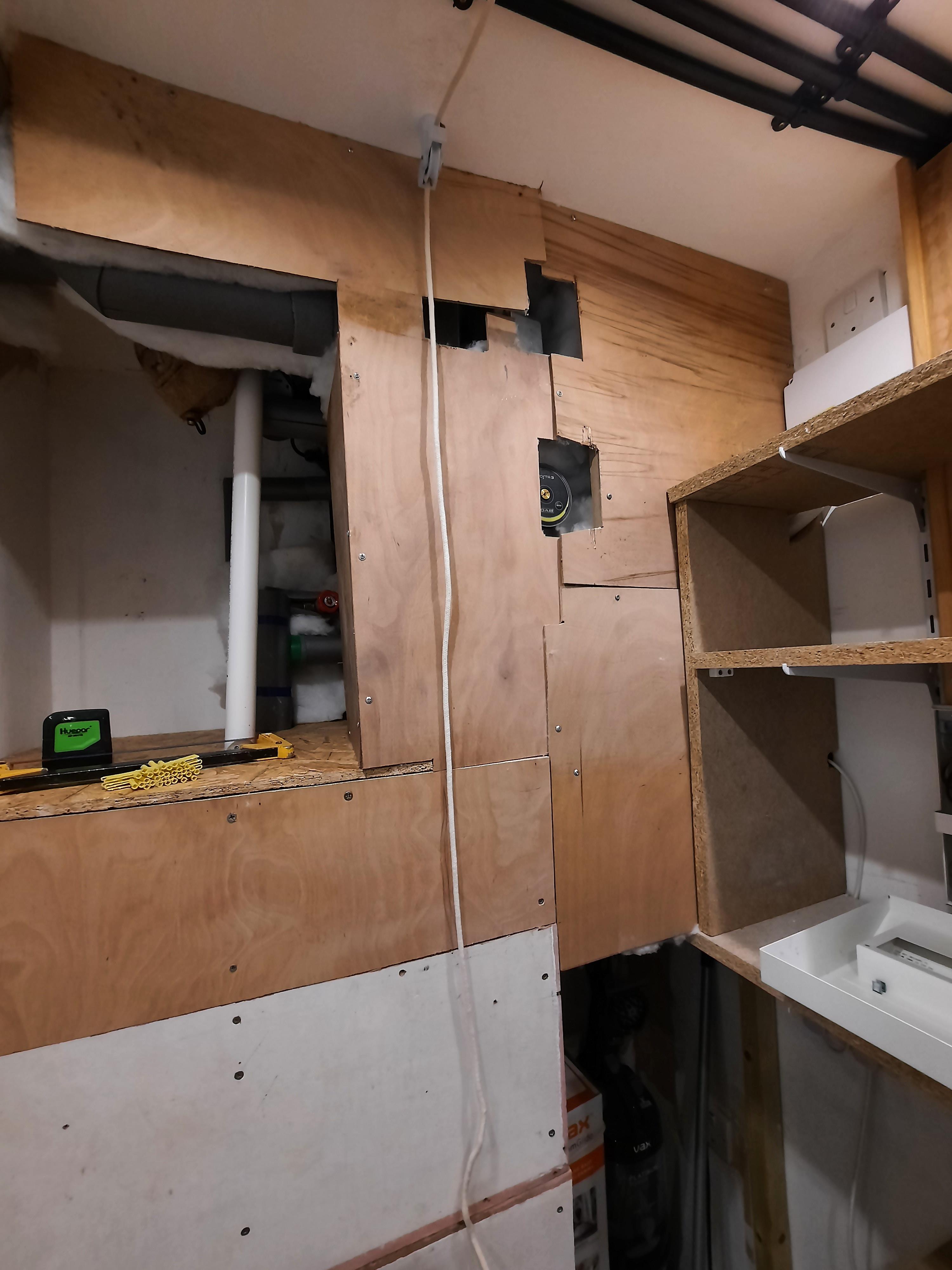

Buffer tank on the right. Gaps for pump and port valves
Hot water tank hiding
