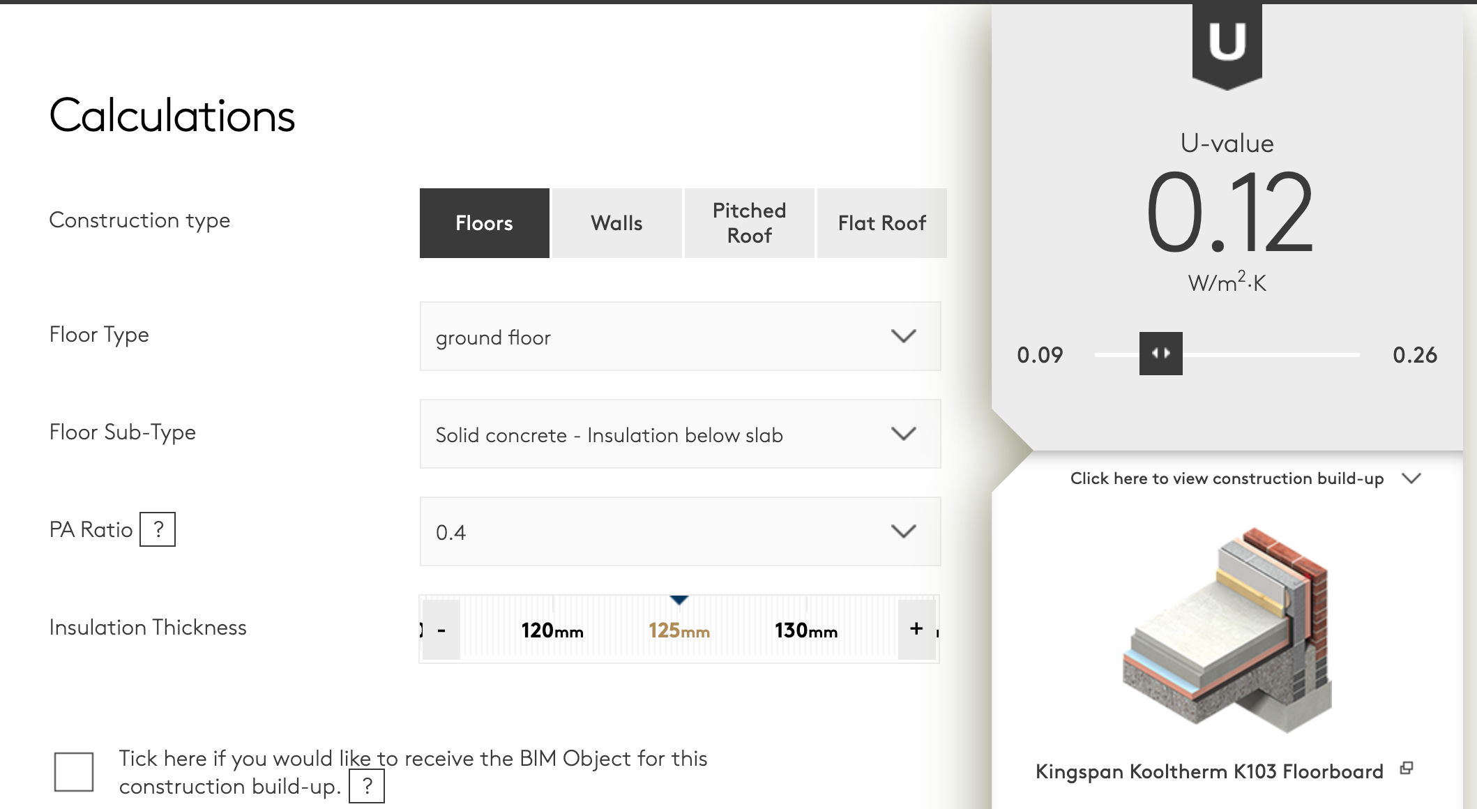

Andehh Posted December 27, 2021 Share Posted December 27, 2021 (edited) This is a useful tool to have a play around with. 100mm is actually 0.14, vs the build regs expectation of 0.25...which drops to 0.18 in next years uplift. So, in a nut shell...100mm is still very good & will give you a very warm house. 125mm is even better....150mm even better....etc etc....hardest point with all of this is when 'enough is enough'. Calculator (uvalue-calculator.co.uk) Edited December 27, 2021 by Andehh 1 Link to comment Share on other sites More sharing options...
Declan52 Posted December 27, 2021 Share Posted December 27, 2021 The ufh will still work. It will just mean you need to run it at a slightly higher flow temp to account for higher heat lose into the floor. You could maybe need a flow temp 3-5 degrees higher. The actual figure will depend on all the heat loss from your house.In the grand scheme of things 25mm less isn't a lot. You can easily overcome this by reducing the air leakage for example. Realistically the savings on 25mm less insulation should cover the extra heat demand for a good few years anyway. Link to comment Share on other sites More sharing options...
KillyfadNewBuild Posted December 27, 2021 Author Share Posted December 27, 2021 2 minutes ago, Andehh said: This is a useful tool to have a play around with. 100mm is actually 0.14, vs the build regs expectation of 0.25...which drops to 0.18 in next years uplift. So, in a nut shell...100mm is still pretty good & will give you a very warm house. 125mm is better....150mm even better....etc etc....hardest point with all of this is when 'enough is enough' Calculator (uvalue-calculator.co.uk) I know - I am literally having this conversation over a coffee at the kitchen table as I type this reply haha I'll have a look at the calculator now - thanks for sending it across, it's appreciated. Link to comment Share on other sites More sharing options...

Declan52 Posted December 27, 2021 Share Posted December 27, 2021 Is PA ratio correct?? Link to comment Share on other sites More sharing options...
KillyfadNewBuild Posted December 27, 2021 Author Share Posted December 27, 2021 We both have achieved lower levels of stress from simply posting this question here - thanks everyone for your feedback, it's been very helpful and hopefully it's help others going forward in the same situation. Link to comment Share on other sites More sharing options...
KillyfadNewBuild Posted December 27, 2021 Author Share Posted December 27, 2021 5 minutes ago, Declan52 said: Is PA ratio correct?? Ahh me being green again - I left it on the default figure when landing on the page. Something I will look into here to get this output tightened up. Link to comment Share on other sites More sharing options...
A_L Posted December 27, 2021 Share Posted December 27, 2021 9 minutes ago, KillyfadNewBuild said: I left it on the default figure when landing on the page. Remember to use internal dimensions when calculating the exposed perimeter and floor area. Link to comment Share on other sites More sharing options...
saveasteading Posted December 27, 2021 Share Posted December 27, 2021 What do you mean by 'polished floor'. Some people mean a beautifully smooth concrete floor with exposed aggregate. Others simply mean smoothed and polished as in an industrial context, for another floor covering. What is the construction of the floor? Raised or ground-bearing? Your 0.4 PA would be right for a 10m x 10m building. If bigger this will improve, but if less square it will be less good. Link to comment Share on other sites More sharing options...
