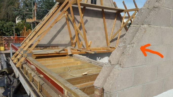

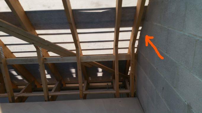

Radian Posted December 26, 2021 Share Posted December 26, 2021 Can anyone suggest how I can retrospectively close the cavity of the internal gable inside this building? Here it was - at the perfect time to close it... Same location from the inside - after it was too late: The gap between the attic truss and wall is too tight to work-in a typical plastic/foam cavity closer while making sure it's a good seal. This last photo was taken above the car parking side of the garage so is effectively permanently open to the outside air and it's obviously leaking air into the occupied side like crazy. I can work insulation in between the truss and wall but the cavity would remain an open route to air movement into the insulated zone on the other side of the wall. Link to comment Share on other sites More sharing options...

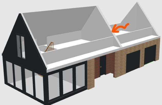

Radian Posted December 27, 2021 Author Share Posted December 27, 2021 It's an empty cavity. But it was just a garage built 23 years ago. The problem with doing anything with the occupied half is it's all finished and furnished now. I would therefore like to do any remedial work in the unused half. There's already a doorway in the gable so the plan is to partition off a further 2m to make a store room that will be insulated. At least this should reduce losses through the cavity. Link to comment Share on other sites More sharing options...
PeterW Posted December 27, 2021 Share Posted December 27, 2021 10mm masonry bit, cheap garden spray, box of gun foam and a decent gun and some patience ..! Drill holes about 150mm apart at probably 100mm from the timber line, then get the sprayer lance in the hole and give a decent squirt of water into the cavity. Follow with the foam gun and don’t be shy with the pressure and you’ll start to create an insulated line along the ridge as the foam creates a barrier. Other option is to get one of the blown bead installers to fill the whole wall - may not be that cheap though for such a small wall. 1 Link to comment Share on other sites More sharing options...

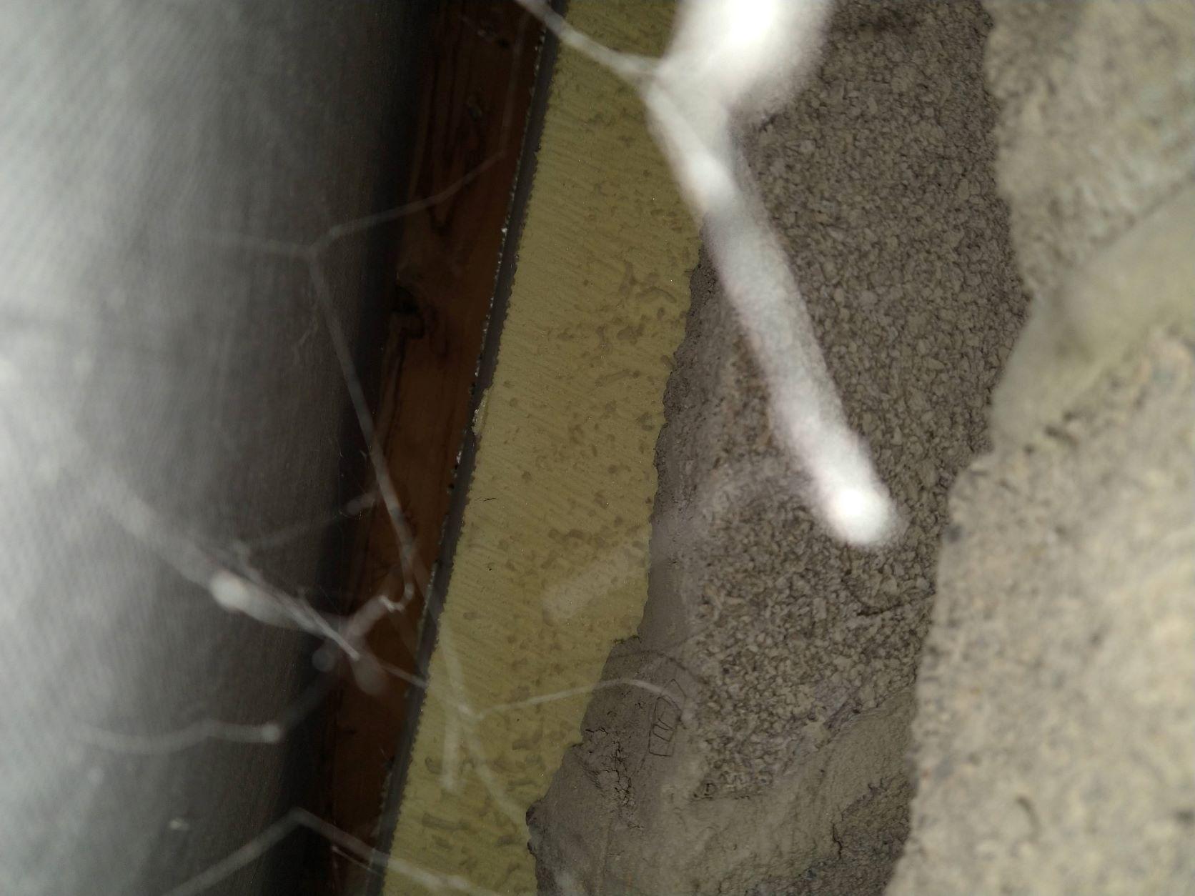

Radian Posted December 27, 2021 Author Share Posted December 27, 2021 (edited) Just poked phone between truss and wall (where the orange arrow is above) to snap this photo: The edge of the outer sheet of roof insulation is visible (100mm Kingspan). There's quite some gap between the edge of the concrete blocks and the underside of the breather membrane because the roof pitch was altered by a couple of degrees. If I could make a right-angled lance to inject the squirty foam I could aim it at the insulation and build off it to close the cavity as well as making a continuous seal - although I can imagine it getting out of control and contacting the membrane. I guess this could also be a possibility if I drilled injection holes and squirted through those instead. But what harm, if any, might there be in getting foam on the membrane? Edited December 27, 2021 by Radian Link to comment Share on other sites More sharing options...
tonyshouse Posted December 28, 2021 Share Posted December 28, 2021 I would use rockwool quilt stuffing it in til no more wants to go in Link to comment Share on other sites More sharing options...
