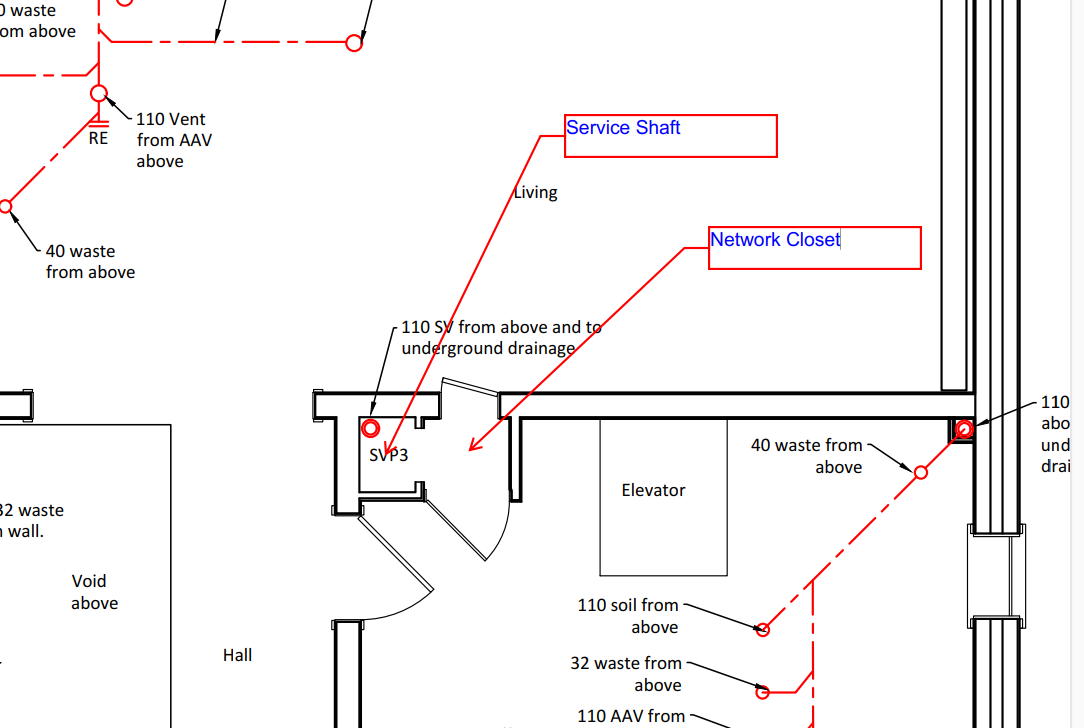

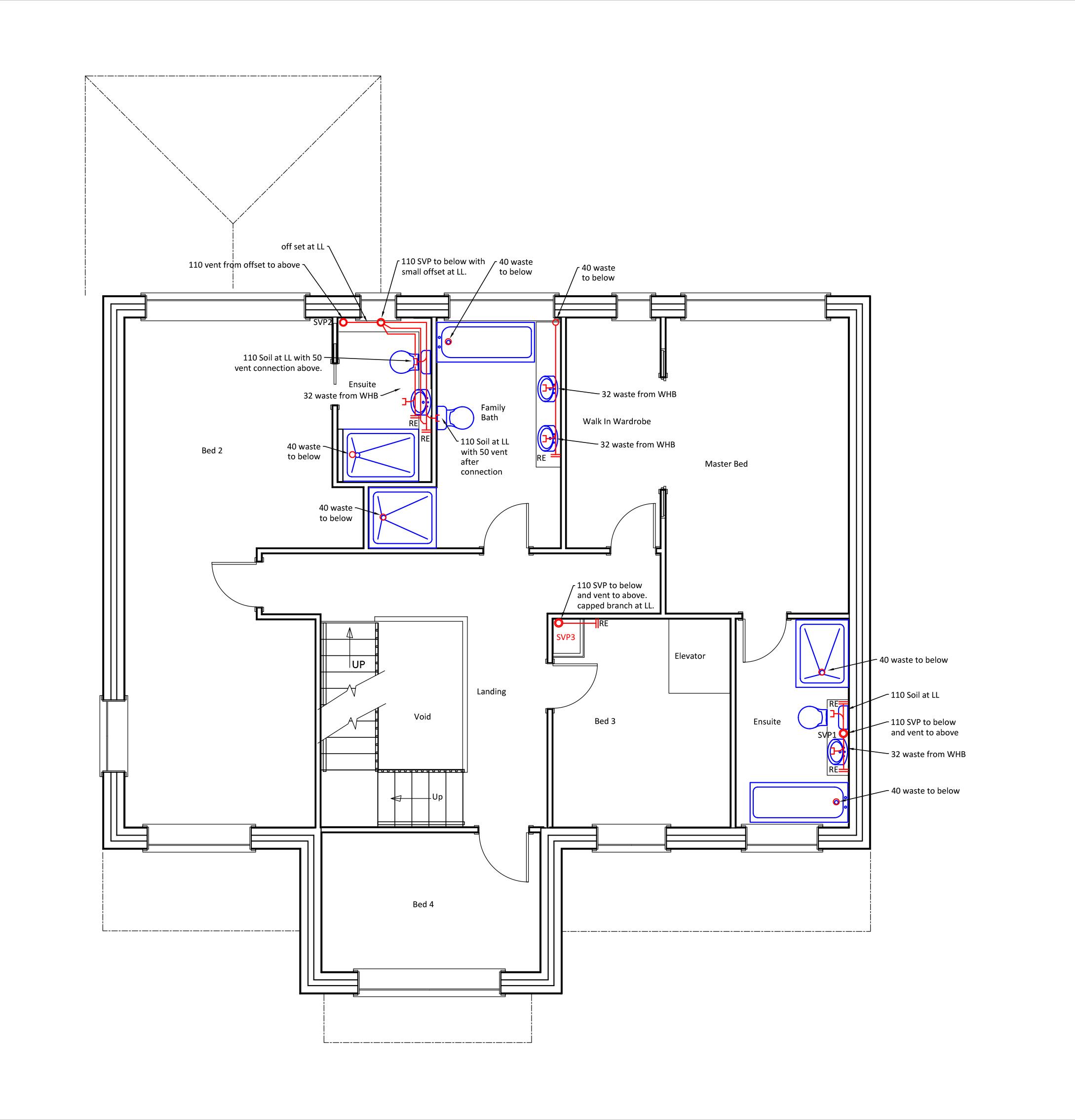

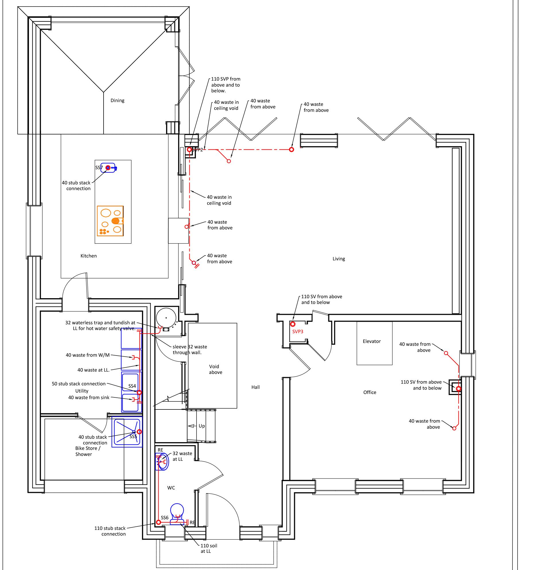

puntloos Posted December 18, 2021 Share Posted December 18, 2021 (edited) My house design's layout is apparently somewhat challenging for the waste side of things. Attached below is the 'current design' but the runs are somewhat long. Is this "okay enough"? I realise that some designs are near the edge of physics, but we can't all have 5% angle - the main question is how often this will start to cause problems "per year". Having a plumber over once every 5 years isn't the end of the world, but once every week obviously is.... One note is that I'm not happy with the far right downpipe, I'd want it in the corner of the room, or if needed, at least further up the wall. Edited December 18, 2021 by puntloos Link to comment Share on other sites More sharing options...
Dave Jones Posted December 18, 2021 Share Posted December 18, 2021 ground floor isn't an issue bring up sewer where its needed, first floor you need to lose them in the stud (unless you want council house style boxing in)which means that stud wall will be wider than normal to accommodate 110mm pipe. Lose the pipe in the elevator shaft and run to it through pozi joists. Link to comment Share on other sites More sharing options...
Bitpipe Posted December 18, 2021 Share Posted December 18, 2021 You'll need to re-think your ensuite to move that 110mm pipe from where it enters the study, unless you have the floor depth to run it horizontally until it hits the corner. Link to comment Share on other sites More sharing options...
TonyT Posted December 18, 2021 Share Posted December 18, 2021 No services except for the lift/lighting are allowed in an elevator shaft… my understanding of the regs and talking to engineers that maintain mine at work. Link to comment Share on other sites More sharing options...

puntloos Posted December 18, 2021 Author Share Posted December 18, 2021 10 hours ago, Dave Jones said: ground floor isn't an issue bring up sewer where its needed, first floor you need to lose them in the stud (unless you want council house style boxing in)which means that stud wall will be wider than normal to accommodate 110mm pipe. Got it. We'll take a quick look if we can accommodate. 10 hours ago, Dave Jones said: Lose the pipe in the elevator shaft and run to it through pozi joists. 9 hours ago, TonyT said: No services except for the lift/lighting are allowed in an elevator shaft… my understanding of the regs and talking to engineers that maintain mine at work. You might be misreading the floorplan, no pipes in any elevator shafts (there actually is no elevator, just a provisional spot as marked) Link to comment Share on other sites More sharing options...
