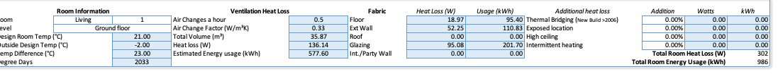

But almost every installer I have spoken to is hand-wavy about the numbers, doesn't want to discuss system design, doesn't really understand things like higher performance building and runs a model that doesn't allow for inputting of all necessary data (such as air permeability or Uw of windows) to produce an accurate heat loss estimate (granted, this might partly be the MCS influence). So I do think the models need checking.
I know exactly what you mean here, but I found once I had signed up and paid a deposit my MCS installer was happy to share the spreadsheet with me, and I could tinker with the numbers to bring it in line with our EnerPHit spec. The MCS model does include room-by-room air change/hr and even thermal bridge allowances
244576008_Screenshot2022-01-05at12_15_42.thumb.png.447453ed8c8de8b06765fc488c650e3b.png
Wish I'd known the the flow temperature was a key determining factor for RHI. We never run ours above 30ºC to protect the wood flooring, but the MCS cert has it as 35.
