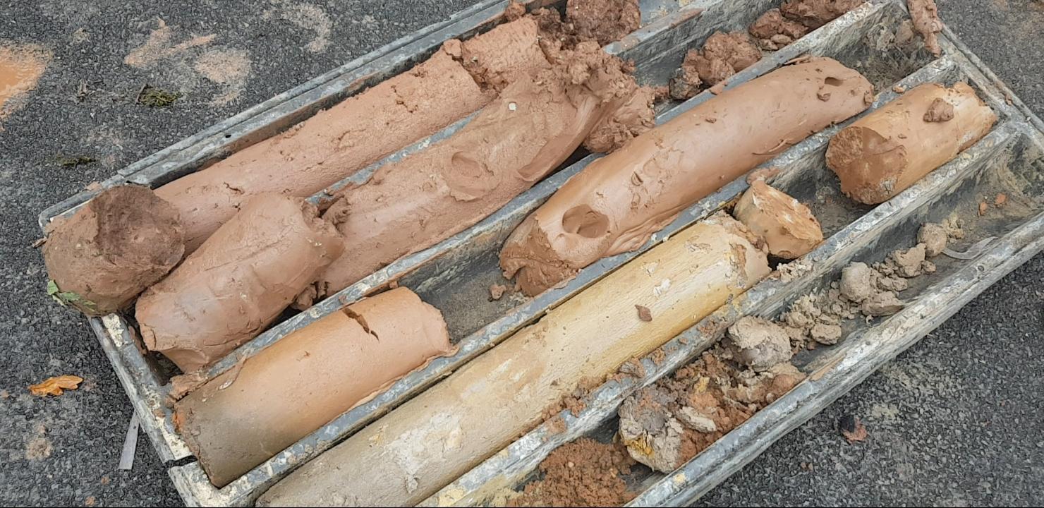

Zak S Posted December 15, 2021 Author Posted December 15, 2021 @Gus Potter really appreciate you providing such a detailed analysis and some great tips. I am very keen to learn however, the requirement for experts would apply at the end. Please see below the picture of boreholes to 5m. They went down to 15m and found more solid stuff at 12m. The clay was very soft and I could easily press. High Water table at 1m. The area used to be a coppice and there is an area wide TPO hence lots of tree but most at least 10m away from the house.

Gus Potter Posted December 15, 2021 Posted December 15, 2021 Hi Zak S. Yes that looks pretty soft right enough at certain depths. Looking at the cores the ones to the right seem to be from the surface, the left ones in the photo from greater depth? The shallower cores look like there is maybe a stiffer crust with soft clay below and that the bungalow founds are using this crust to spread the load out before it reaches the softer clays... The folk that designed the founds for the bungalow may have taken advantage of this crust. I would still expore the raft first. If the water table is high and not likely to drop then the soft clay can't shrink as it will always be submerged. It also can't go anywhere.. it is confined at depth. Once you go down a bit the pressures in the ground from a raft are often found to be very modest so even a soft clay can carry a surprising amount of load with acceptable settlement.
Zak S Posted December 15, 2021 Author Posted December 15, 2021 3 minutes ago, SimonD said: If you dig trial ditches around your existing foundations, make sure you get your structural engineer to look at the soil immediately as if you leave them open for any length of the time the soil will change consistency and may negatively affect foundation design. Also make sure you dig in several places as clay can and does often vary across the site. Hi. Very interesting to see you doing something which I have moved away on the grounds that it was not worth the pain/savings etc. I would definitely not want to waste the existing c200 sqm. I had asked the soil investigation team to check the existing foundation so on the front its 1m and back 400mm. I did not show it to structural engineer as I currently dont have as I have just g appointed a planning/design architect and structural engineer would be down the line but I suppose once I get the GI report at that stage I can speak with SE to better inform the way forward. In remodel, I would be planning for an extension at the back and extension at the front and one side so not much will be left in terms of wall. But remodel is definitely on the cards if the rebuild costing does not work.
