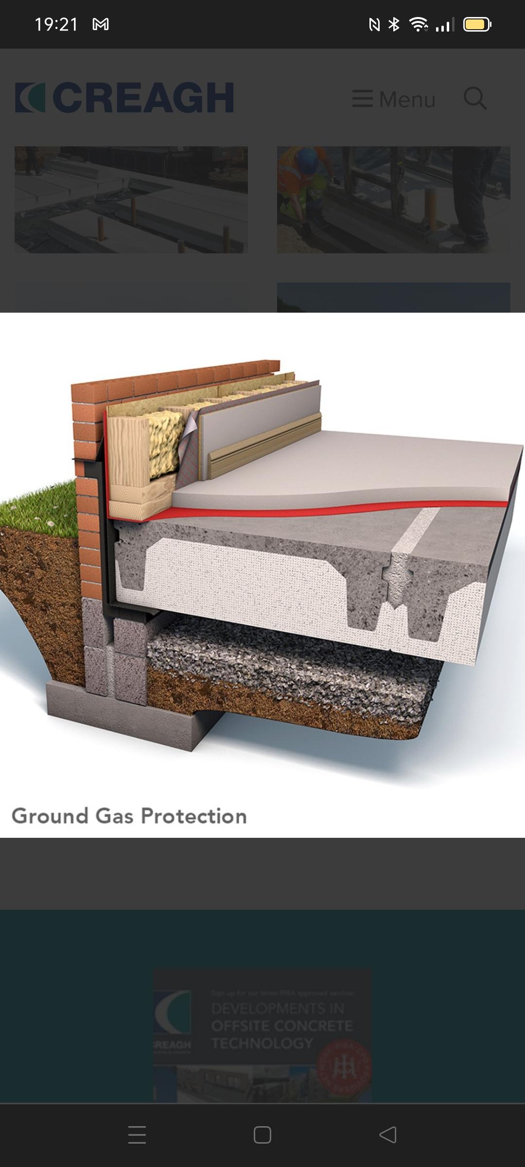

eandg Posted December 6, 2021 Posted December 6, 2021 We have a precast insulated slab which we had intended laying UFH onto then pouring 50mm liquid screed. Had overlooked what appears to be an obvious issue of requiring some form of thermal break to prevent the UFH simply conducting heat below. And ideally one that's as minimal depth and as cheap as possible given we have little wiggle room on the appertures (kit may need to be re-engineered) and budget. U-value of the floor is 0.11 so not necessarily needing any additional thermal insulation just something that'll provide a break and ensure UFH is efficient. Any thoughts?

eandg Posted December 6, 2021 Author Posted December 6, 2021 23 minutes ago, JohnMo said: Do you have a drawing? I do but not on my phone unfortunately. It's just basically a spantherm type slab. But it is basically the same detail as the screenshot (taken from spantherm website).
SteamyTea Posted December 6, 2021 Posted December 6, 2021 So is it basically block and beam, with insulation under it?
eandg Posted December 6, 2021 Author Posted December 6, 2021 4 minutes ago, SteamyTea said: So is it basically block and beam, with insulation under it? Aye, could have saved myself some bother if I'd just said that!

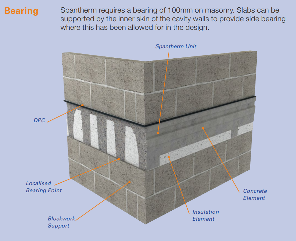

IanR Posted December 6, 2021 Posted December 6, 2021 I don't believe it sits on 60mm for the entire perimeter, EPS couldn't take the loads on such a small area, so the there's concrete going all the way down to the blocks. The brochure gives a 2D Psi calc for the cold bridge, that looks reasonable, but it does cut the section where there is EPS between concrete and block plinth. Would be good to see the same calc done for the section where the concrete goes all the way down to the block plinth. Having said that the overall U value they calculate (0.11W/m².K) includes the perimeter cold bridges. As long as they are not using smoke and mirrors then I feel the UFH could go in a screed straight on the precast sections. I probably wouldn't run the pipes too close to an external wall though, ie. at least 200mm away as there is still a bit of a cold bridge.

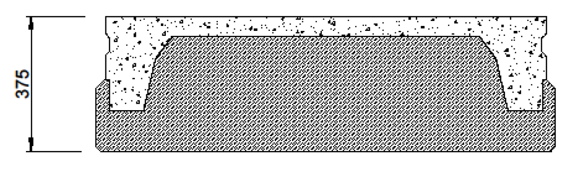

eandg Posted December 7, 2021 Author Posted December 7, 2021 Thanks Ian - from the drawings it goes further but doesn't go all the way to the block plinth with the join to be grouted on site. There's various requirements (needs to be 215mm block for example) and calculations but I'm paying other people to work that out. This is the drawing provided by the manufacturer and from correspondence the thermal conductivity of the EPS is 0.031W/mK.
IanR Posted December 7, 2021 Posted December 7, 2021 (edited) I don't believe that section shows he whole picture, as I mentioned before the EPS can't take the loads on to a 100mm block plinth. This image shows it better While the section you showed is not wrong, If you the moved the section along the span a little it would show pre-cast concrete going all the way down to the block plinth. But, this image also shows that along the length of the pre-cast section, there's only 1 localised bearing point every 1m or so, which isn't bad. Although along the width of the pre-cast section it looks like 100mm of localised bearing point (cold bridge) for every 100mm on EPS. Edited December 7, 2021 by IanR
Olf Posted December 7, 2021 Posted December 7, 2021 With only 50mm to play with it will be hard to find something that efficiently provides thermal break. Bonding screed layer with the slab would be imho beneficial, as you get more thermal capacity (unless you are sold on quicker reaction times). With the cold bridges due to the specifics of the construction method I think you need to adjust the UFH circuit layout: pipes running along the areas where concrete forms bearing points would mean heat is transferred this path anyway (not contributing to space heating), so by avoiding laying near the perimeters you don't loose too much on house heating, yet reduce losses. 1
eandg Posted December 7, 2021 Author Posted December 7, 2021 15 minutes ago, Olf said: With only 50mm to play with it will be hard to find something that efficiently provides thermal break. Bonding screed layer with the slab would be imho beneficial, as you get more thermal capacity (unless you are sold on quicker reaction times). With the cold bridges due to the specifics of the construction method I think you need to adjust the UFH circuit layout: pipes running along the areas where concrete forms bearing points would mean heat is transferred this path anyway (not contributing to space heating), so by avoiding laying near the perimeters you don't loose too much on house heating, yet reduce losses. Thanks; adjusting layouts would appear to make sense.
