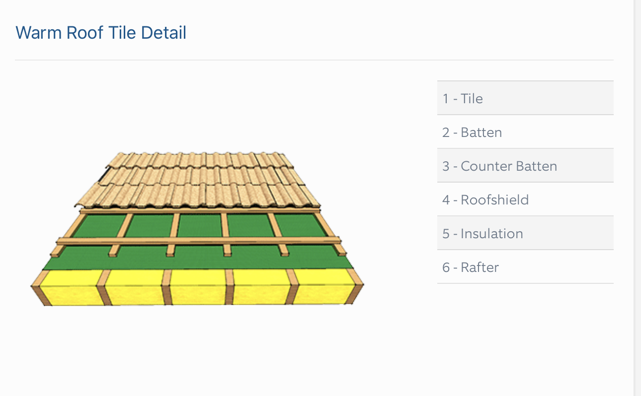

Thorfun Posted December 5, 2021 Share Posted December 5, 2021 29 minutes ago, Happy Valley said: Thanks for all the responses. The roofing contractor says there will be no issue with interstitial condensation but this is beginning to concern me slightly now. So other than foil insulation already mentioned or the expensive and time consuming option of 70mm PIR insulation between the rafters/spars what other options do I have to improve the efficiency of the roof? The spars are 47mm x 200mm spaced with 450mm centres. we used Proctor Roofshield (https://www.proctorgroup.com/products/roofshield) as our roofing membrane. This is allowing us to fully fill our 197mm rafters (actually putting in 190mm due to availability of thicknesses) of Isover Frametherm 32 glass mineral wool batts with 90mm PIR below the rafters. you could try this route. speak to your preferred insulation manufacturer and ask them to do a condensation risk analysis on your chosen make up and they'll do the calculations for you. 1 Link to comment Share on other sites More sharing options...
