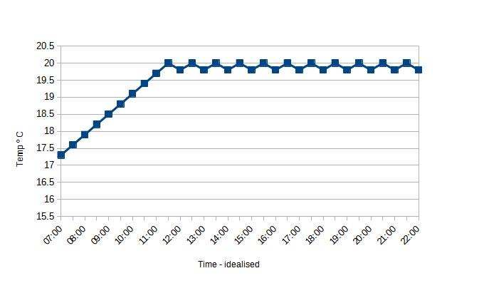

Here is a graph of the heatpump’s performance from yesterday. Missing data points are those where I forgot or was unable to make a record. The user settings were ‘Auto’ and set a +1
[graph not uploaded for some reason. will fix tomorrow]
It started off quite briskly but then ‘relaxed’ as if the aim was to arrive at the target temperature mid-afternoon rather than get there a.s.a.p and maintain it there till shut-down at 22:00. What I want is the graph to resemble the FICTITIOUS representation below.

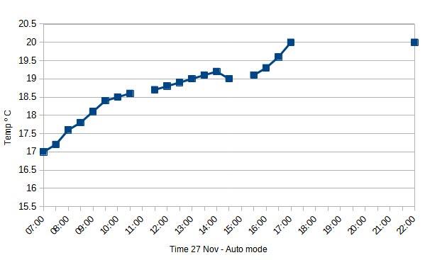

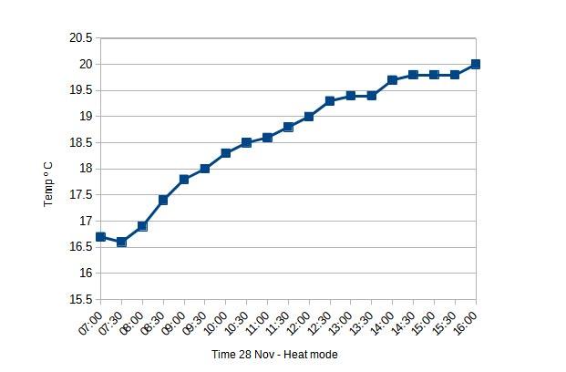

Today’s data was collected with the user’s ‘Auto’ set to ‘Heat’. Here’s the graph.
There is a slight ‘improvement in performance on 28 Nov but apart from that there seems to me little difference between the two. Apart from starting from a slightly lower temperature on the 28 Nov, and reaching the target temperature a little quicker than under the ‘Auto’ setting the curves are pretty similar and display a tendency to delay getting to the target temperature until mid afternoon which is not what I want.
