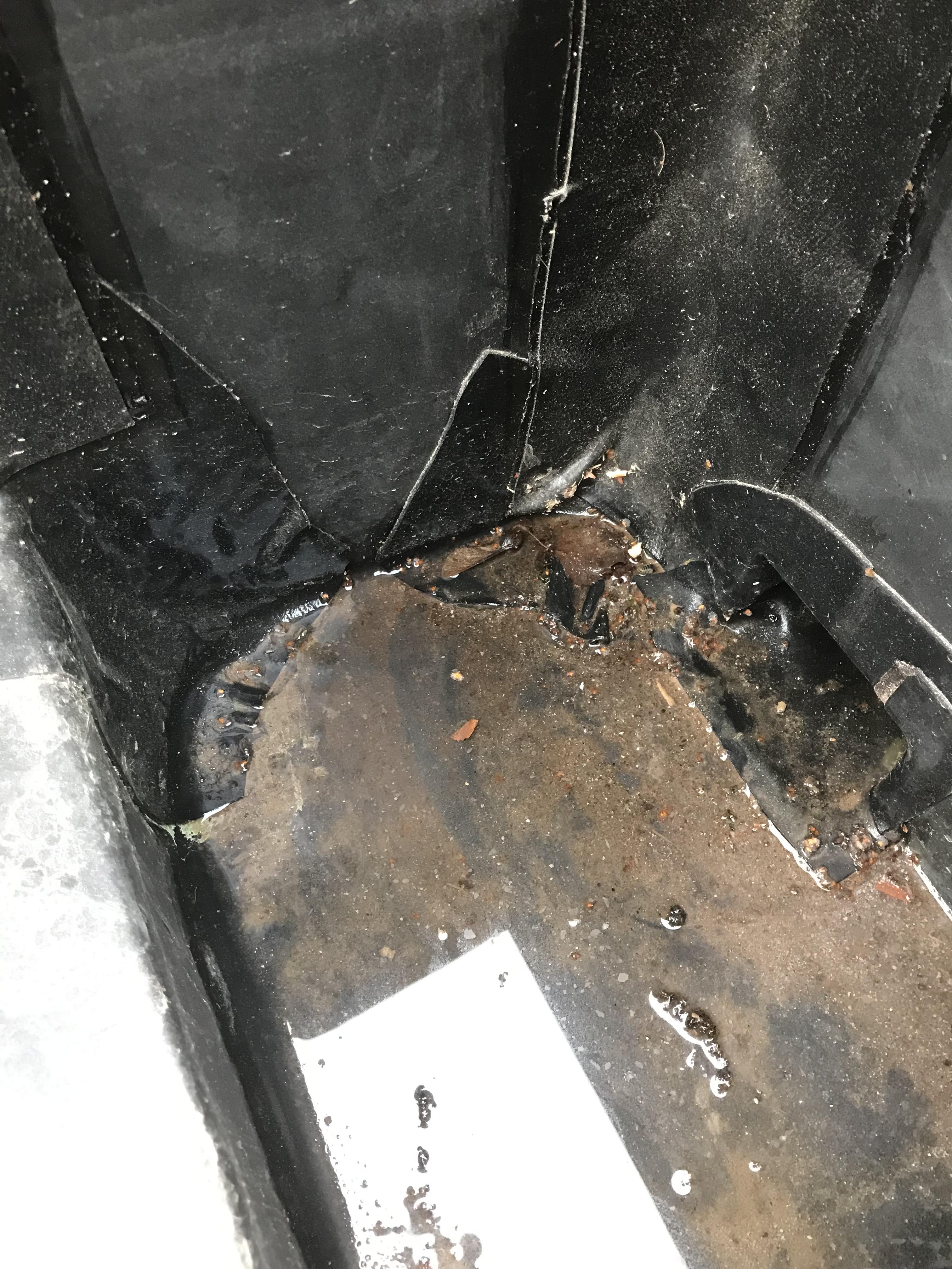

Bluefish Posted November 26, 2021 Posted November 26, 2021 Hi i have recently had a new flat roof installation on a new extension. it’s a warm roof and the roofer has used a rubber membrane. Almost immediately we had a leak in two corners where the water enters the exit drains. He came back and “fixed it” but in doing so has created a lip at the exit points which now retains sitting water. My guess is this sitting water is just a future problem ? At present I haven’t paid for his work … what would you do.. 1) Ask for it to be completely redone at his cost? 2) Given the standard of work so far cut losses and source another firm to redo it. To date I have incurred additional costs of dehumidifiers and replastering work where the water has come in … should he be compensating for that? Any input appreciated!

markc Posted November 26, 2021 Posted November 26, 2021 +1 on @Russell griffiths comment. Rubber membrane roofs and gutters often have raised “dam’s) at outlet points to retain a shallow puddle. Never understood why but seen it on loads of membrane details. 1
Dave Jones Posted November 26, 2021 Posted November 26, 2021 pretty poor finish really, no attempt at doing the corners properly. Accrediuted EDPM installers can offer firestone backed 10 year warranty, id insist on it before paying. What is the build up of the roof, what vapour barrier was used ?

BobAJob Posted January 22, 2022 Posted January 22, 2022 I caught a Firestone trained EPDM fitter putting nails through a gathered fold of EPDM and then gluing an EPDM patch over the top of it instead of trimming the EPDM and gluing it flat. Unfortunately, I only caught him at the end and it was too late to do anything about it. He covered the only thing with an edging strip to hide it from view. When I challenged him about it he said "Everyone does it". I told him it's not right and he told me "Customers don't know what good looks like, so I get away with doing that. It's on a raised edge and under a patch and an edging strip so no water is going to get into it." This guy turned up to quote wearing Firestone branded T-shirts and then for the job he turned with two day labourers he hires from a local shelter and himself in different t-shirts. He tried to strip and relay two flat roofs in a single day and spent the entire time on the roof and never looked at the side of the roof until the end.
