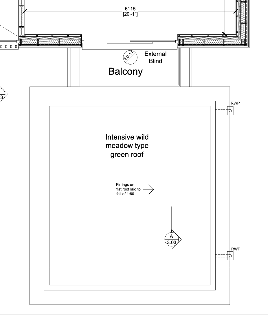

Thorfun Posted November 18, 2021 Posted November 18, 2021 if I can add my limited experience to this subject... We have a balcony that is a 'link' between the main house and a flat roof room. like this: the intensive wile meadow green roof if a warm roof with 190mm of PIR above the joists. The balcony was designed as a warm roof with vacuum insulation panels (think Optim-R from Kingspan) but due to the exorbitant cost of those and also a mistake in the design we ended up with not having enough room for a warm roof. We are now having a hybrid roof for the balcony section with 70mm PIR between the joists and 100mm PIR above the joists. This has been through a condensation analysis by Xtratherm and it has passed. The important detail is, as has been said above, the VCL layer which is below the joists and any penetrations need to be sealed properly to reduce the risk of condensation. So, a hybrid roof is a faff but it's definitely possible if the relevant calculations have been done and you have a document to prove it. hope this different perspective helps.

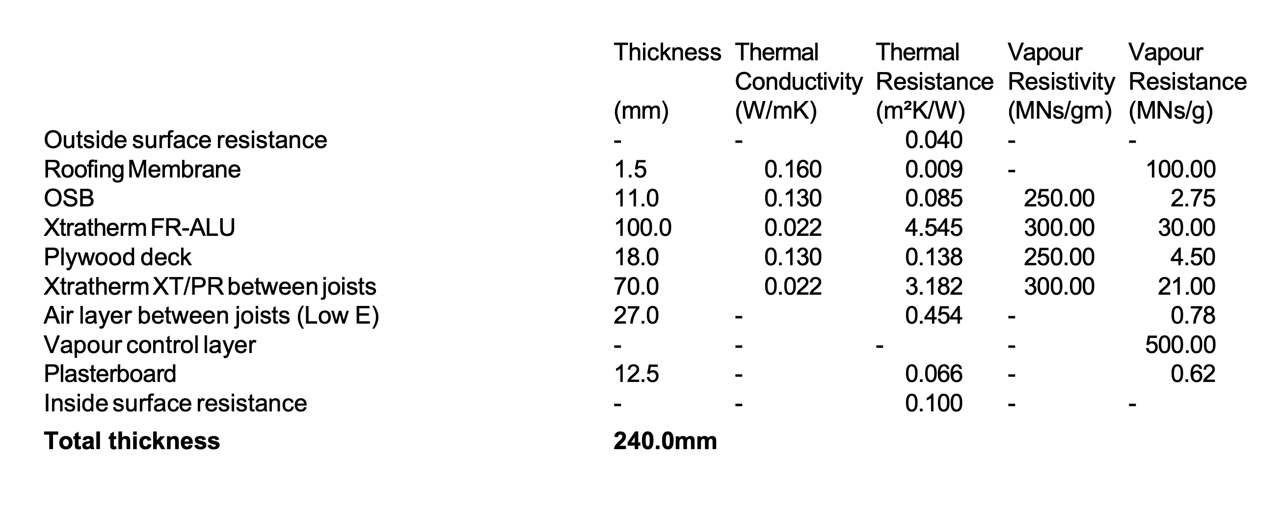

Thorfun Posted November 18, 2021 Posted November 18, 2021 13 minutes ago, Thorfun said: Hi @ADLIan, in my situation we have the following buildup from inside to out: VCL Joists 70mm PIR between joists Firrings to 1:60 fall 18mm OSB 100mm PIR 11mm OSB fully adhesive single-ply membrane This has passed all of the condensation risk analysis and the VCL (will be an AVCL actually as it'll be the same membrane I choose as the airtight layer for the rest of the house) will stop moisture from the house get in to the joists. What happens to any moisture that does get in to the joists though? it can't go up as surely the single-ply waterproof membrane will stop it escaping above? I trust the condensation risk analysis but I'm just confused as to what will happen to any moisture that get's between the joists? hmmm....I wonder if one of those intelligent AVCLs would help here as it would let moisture back in to the house in the summer months, right?
ADLIan Posted November 18, 2021 Posted November 18, 2021 Hybrid roofs are generally discouraged. A hybrid pitched roof is often more forgiving as a breather type membrane is used. A hybrid flat roof is not so forgiving as the waterproof layer and ply/osb deck are both impermeable. To work there must be meticulous attention to detail in installing the AVCL ensuring all laps/joints/penetrations are very well sealed. Any imperfections may lead to problems in the longer term - moisture vapour may get through the AVCL but liquid water is effectively trapped. BS 6229 gives more advice on flat roofs. In a condensation assessment a lot will depend upon the vapour resistance value used for AVCL - does it assume the vapour resistance of the membrane, (which may be massively high if it includes a metal foil) or does the value reflect a more realistic 'in use' value including imperfections? As mentioned before its possible to get the CRA to say anything you want - it's knowing if correct and realistic values have been used. Not sure an intelligent membrane would work - best check with the manufacturer and any independent certification they may have 1
Thorfun Posted November 18, 2021 Posted November 18, 2021 3 minutes ago, ADLIan said: In a condensation assessment a lot will depend upon the vapour resistance value used for AVCL - does it assume the vapour resistance of the membrane, (which may be massively high if it includes a metal foil) or does the value reflect a more realistic 'in use' value including imperfections? As mentioned before its possible to get the CRA to say anything you want - it's knowing if correct and realistic values have been used. does this help?

ADLIan Posted November 18, 2021 Posted November 18, 2021 Values for the ply deck and the roofing membrane both look low. Nearer 1000 MNs/gm for ply and 800 MNs/g for the single ply (it's a continuous membrane with all joints very well sealed). These may be sufficient to alter the CRA. Problem with WUFI as I understand is that it is incredibly complex and there are no conventions for its use.
