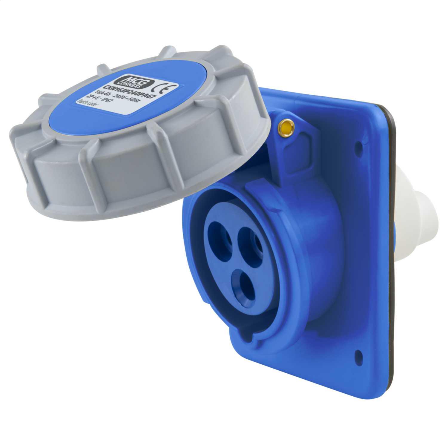

Onoff Posted November 12, 2021 Share Posted November 12, 2021 Use with an adapter lead? https://www.cef.co.uk/catalogue/products/4348908-16a-2p-e-230v-angled-panel-socket-ip67 Link to comment Share on other sites More sharing options...
