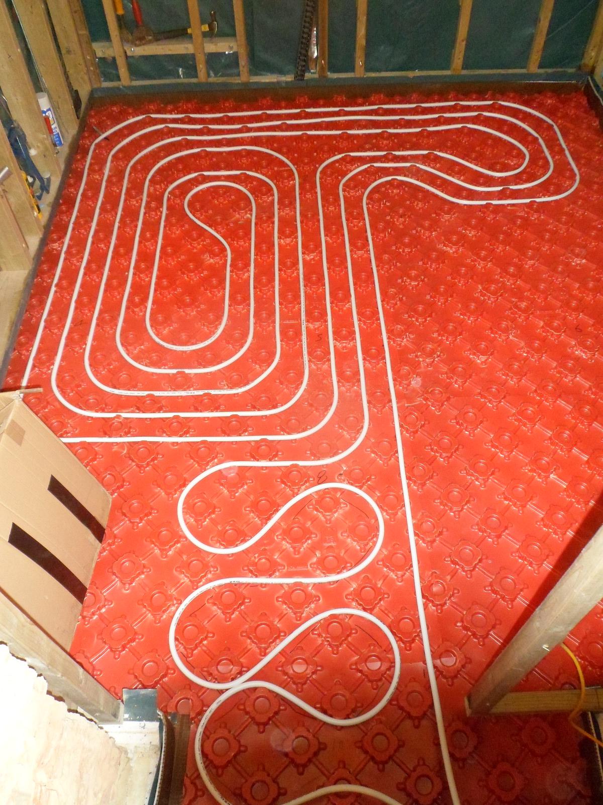

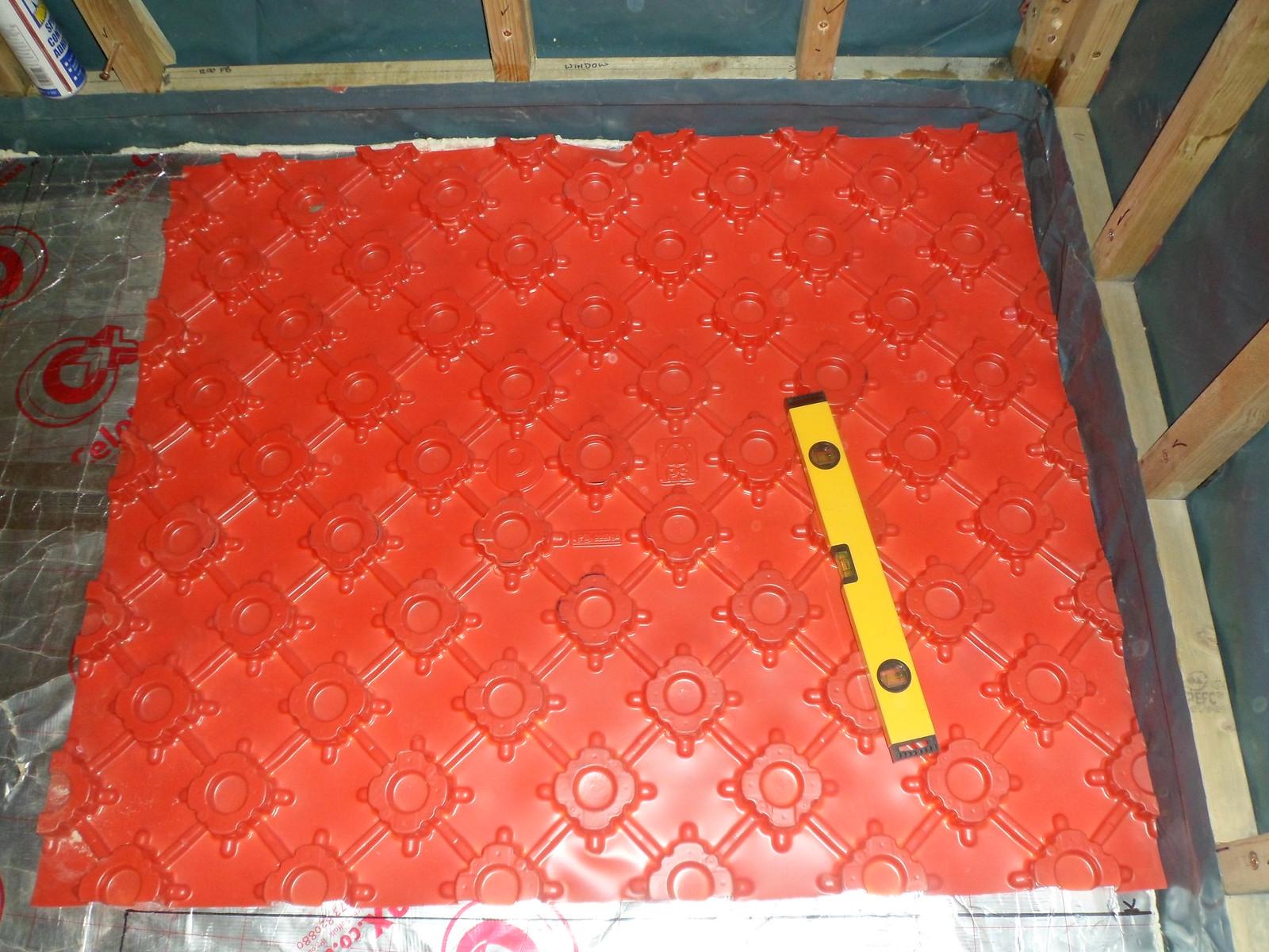

Onoff Posted November 11, 2021 Posted November 11, 2021 Thick over thin I did...I think. Butt tight. Overlap the joints. Foil tape the joints. 1
Onoff Posted November 11, 2021 Posted November 11, 2021 Whoops! Looking back and I did thin over thick. It was a bit springy. Thick over thin would have been better. There's also 25mm EPS under the 100mm. 1
GrantMcscott Posted November 11, 2021 Author Posted November 11, 2021 1 hour ago, Onoff said: Whoops! Looking back and I did thin over thick. It was a bit springy. Thick over thin would have been better. There's also 25mm EPS under the 100mm. Looks like you have no upstands on that for the screed
Onoff Posted November 11, 2021 Posted November 11, 2021 14 minutes ago, GrantMcscott said: Looks like you have no upstands on that for the screed I did later...
Gus Potter Posted November 11, 2021 Posted November 11, 2021 If you have any DPM left pop another bit over the insulation as it can provide a slip membrane for the screed to shrink, helps reduce the risk of getting cracks in the middle for example. Maybe you are going / have done this anyway.

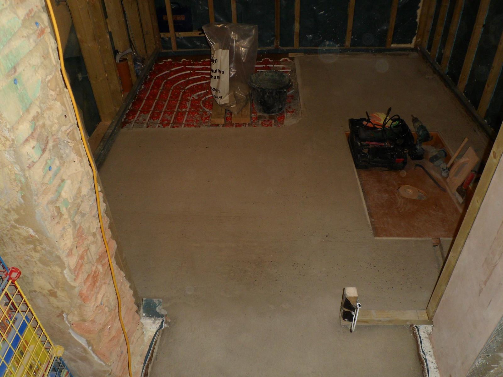

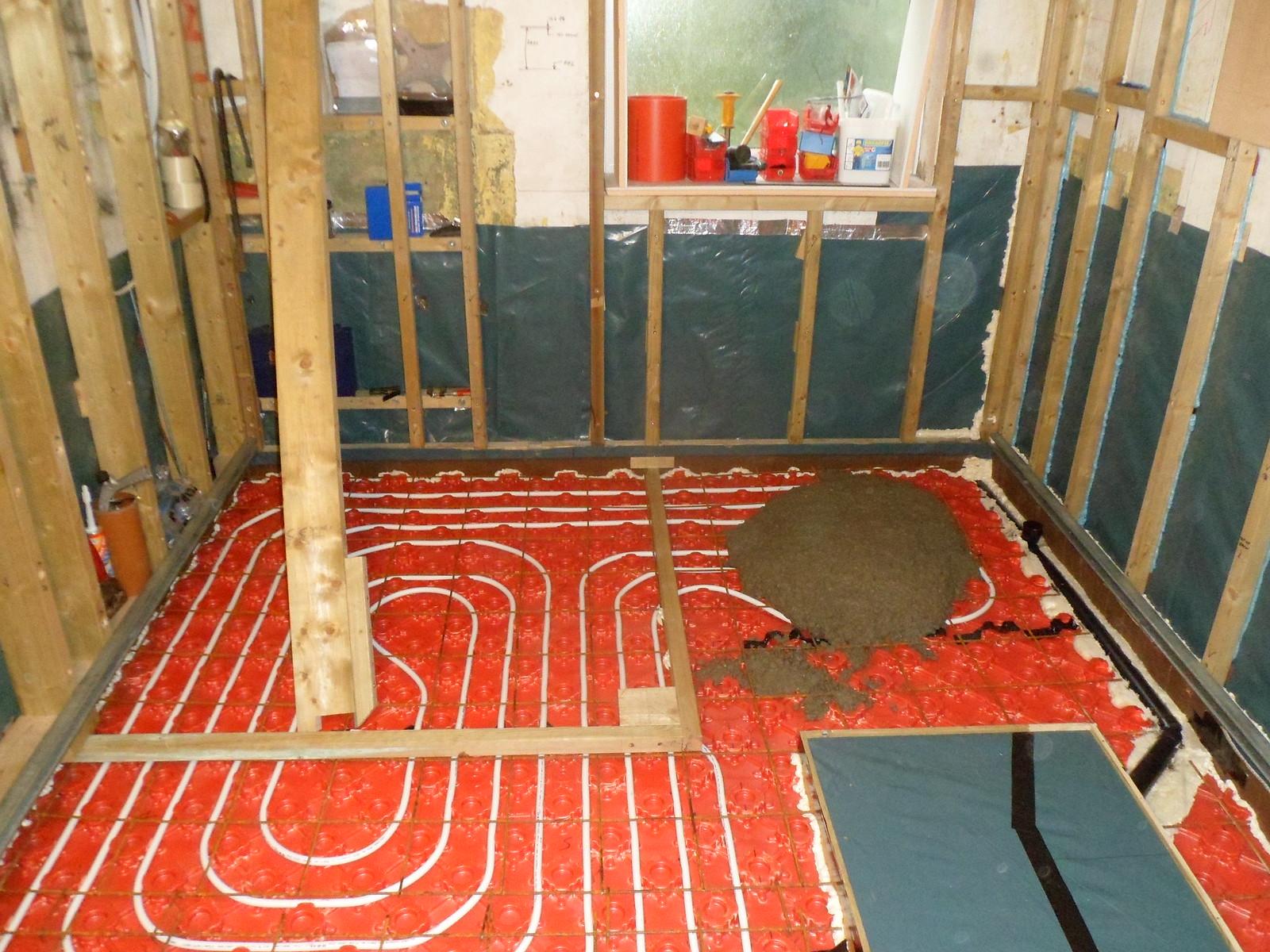

Onoff Posted November 11, 2021 Posted November 11, 2021 I used Polypipe trays rather than a slip membrane. Makes for a lighter, castellated, slab. Think the tray inside the biscuit tin at Christmas! It doesn't "ring" quite as dense as a solid, full depth slab does but it's strengthened by A142 mesh Thank God I put the mesh in as I forgot to add the fibres in when I mixed the concrete. I used wet concrete btw, not screed. Tamped level using screed rails attached to the stud walls. 1

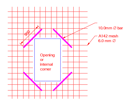

Gus Potter Posted November 11, 2021 Posted November 11, 2021 Good photos onoff! For all. Screeds and concrete shrinks. It cost pennies to do but where you have an internal corner just drop in diagonal bar, even if it is a poured self levelling screed or a screed with fibres. Even with fibres (plastic firbre ones definitley, steel fibres a bit less) you can still get crack development.. and this can cause you to worry that you have stretched your UF heating pipes. 1

Onoff Posted November 11, 2021 Posted November 11, 2021 48 minutes ago, Gus Potter said: Good photos onoff! For all. Screeds and concrete shrinks. It cost pennies to do but where you have an internal corner just drop in diagonal bar, even if it is a poured self levelling screed or a screed with fibres. Even with fibres (plastic firbre ones definitley, steel fibres a bit less) you can still get crack development.. and this can cause you to worry that you have stretched your UF heating pipes. Should that be a piece of actual re-bar?

Gus Potter Posted November 11, 2021 Posted November 11, 2021 16 minutes ago, Onoff said: Should that be a piece of actual re-bar? Yes.

saveasteading Posted November 12, 2021 Posted November 12, 2021 12 hours ago, Gus Potter said: 13 hours ago, Onoff said: Should that be a piece of actual re-bar? Yes. And tied with wire to the mesh, so that it stays tight to the mesh, and doesn't get displaced or even lost. This is really important to avoid big cracks from a corner to the nearest edge. 1
