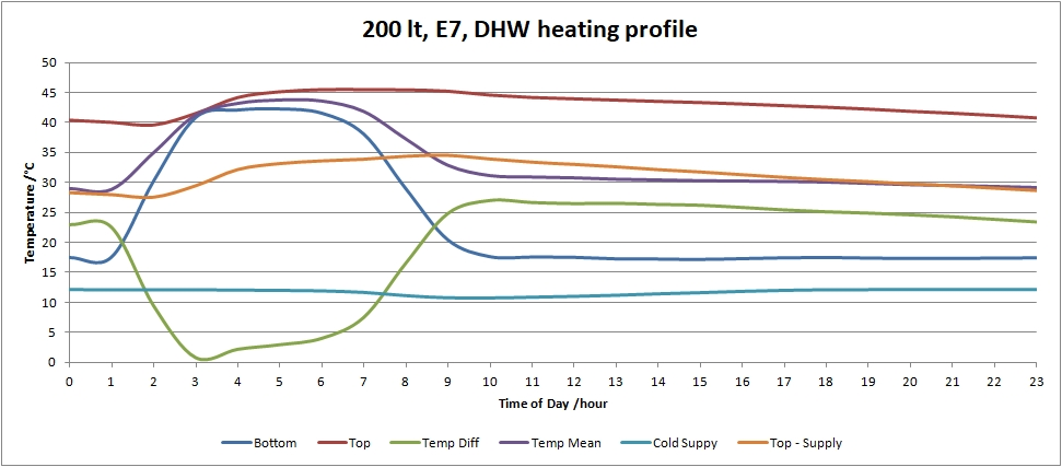

1 hour ago, Marvin said:
My 1400mm high tank can go from 25C at the bottom to 60C at the top.
Bottom of my tank usually settles around 10°C higher than the temperature of the incoming water.
It is worth, when looking at my chart, that most mornings I have a bath full out of it after the E7 heating window has finished.

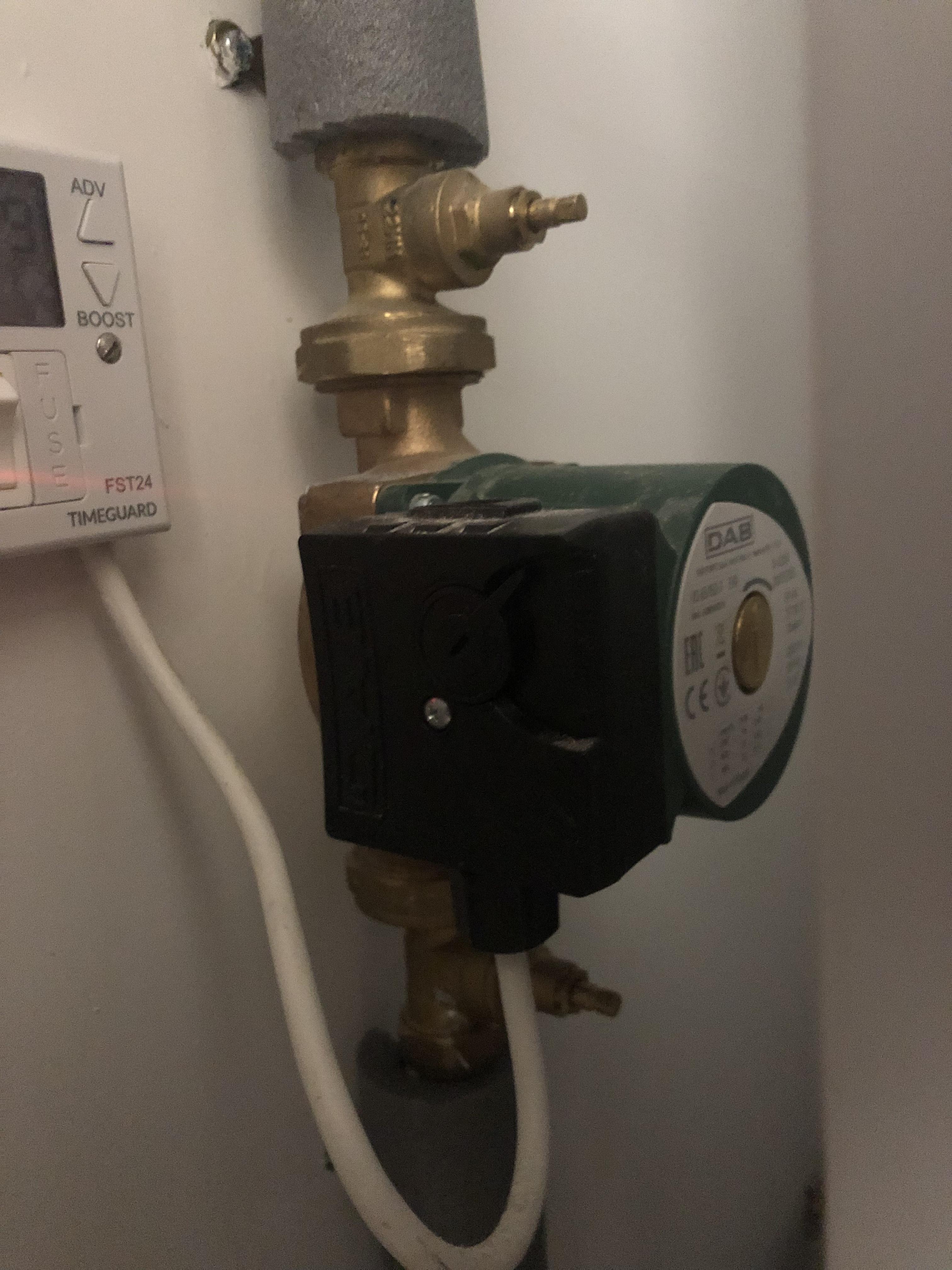

Some things I noticed with your system;
  • you appear to have 5 pumps!
  • your boost timer seems to be connected to a pump rather than the immersion. I haven no idea why you might do that.
  • It looks like you have an Ecodan pre-plumbed cylinder with active heating. I don't think it uses a coil unless you have the solar version. It actually pumps the water out of the cylinder, through a plate heat exchanger and back into the cylinder again. Mitsubishi recon this heats the cylinder quicker, and maybe they are right. So the stuff on the bottom right of your cylinder in the picture is the pump, scale trap and heat exchanger. If your cylinder is hotter than your heat pump is running then it will for sure cool your water down very quickly. Also note: if the cylinder pump comes on when the heat pump is not on for some reason it will have the same effect of cooling down your hot water rather rapidly.
  • Our ASHP only comes on when a heatmiser stat calls for heat or water heating. Yours coming on and off without a call seems weird. Are you using the wireless neo air stats? they have a 'safety' mode that turns the boiler on (I think from memory for 7 mins per hour) if the signal from a stat is lost (including a flat battery). If you are using those wireless ones you can turn off the 'safety' feature at the wireless controller.
  • (given that it is pre-plumbed and designed to be used with your heat pump and the big box of electronics on your cylinder it seems odd that you would be having those problems unless sonething has been configured incorrectly.)
I'd be inclined to periodically check the pump below the TF1 to see if it is coming on when the heat pump is either off or running cold. That would quickly chill your hot water!

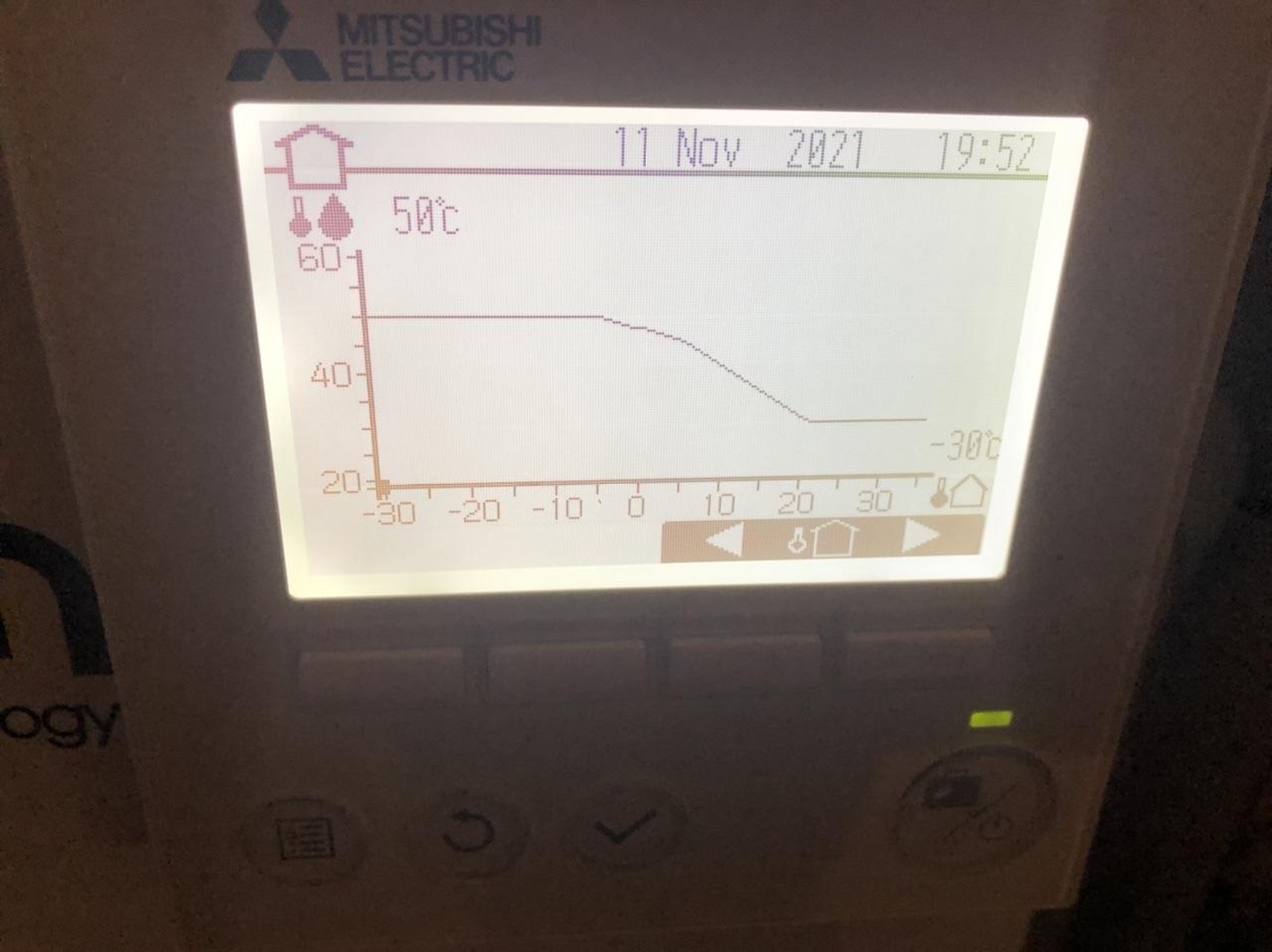

On 11/11/2021 at 19:57, MYLOUBYLOU said:
Our weather compensation curve
Hmm 50°C seems a very high target temperature for a system based on UFH. When the outside temperature is below 5 it's going to give a very poor COP.
Personally I set the curve to 30°C max rolling down to 25.
Mine is controlling an electronic thermostatic mixing valve so actually setting the temperature running in the loops, and no buffer tank. So I need the max flow temp low to protect the wood floor finishes. If your system has a buffer tank and a separate manual fixed setpoint TMV then I guess the compensation curve serves a completely different purpose.
(I'd really feel for the ASHP engineers in 10 time trying to understand all the different system designs people end up with, no two installs are ever quite alike.)
