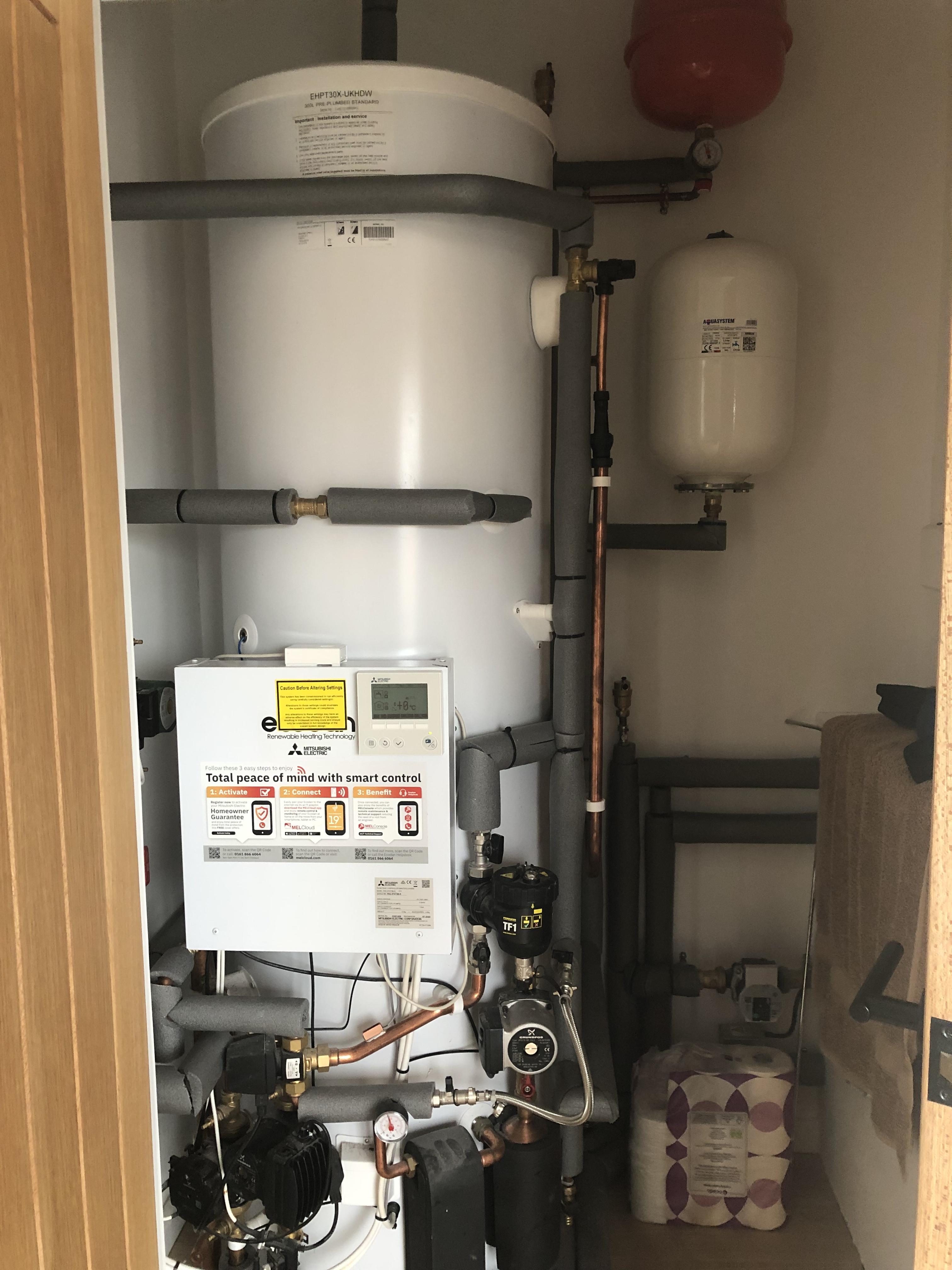

ProDave Posted November 11, 2021 Share Posted November 11, 2021 A few things spring to mind. HOW is the heat delivered to the rooms by under floor heating, radiators, or a mixture. When ALL the rooms are up to temperature, can you still hear the low level hum of a water circulating pump running somewhere? You say when HW is off, you only get tepid hot water from the taps. That does not sound right. Can you post some pictures of your hot water tank and any other pumps and controls you can see? Assuming you have a hot water tank, once it is up to temperature it should stay there all day only losing a little heat through losses. What is this "boost" that you switch on before a shower, again can you post a picture? 1 Link to comment Share on other sites More sharing options...

ProDave Posted November 11, 2021 Share Posted November 11, 2021 The rapid drop in DHW temperature concerns me. A picture of the HW tank might help. Link to comment Share on other sites More sharing options...
MYLOUBYLOU Posted November 11, 2021 Author Share Posted November 11, 2021 Link to comment Share on other sites More sharing options...
MYLOUBYLOU Posted November 11, 2021 Author Share Posted November 11, 2021 If we click on boost on this it send hot water to the taps Link to comment Share on other sites More sharing options...
MYLOUBYLOU Posted November 11, 2021 Author Share Posted November 11, 2021 10 minutes ago, ProDave said: The rapid drop in DHW temperature concerns me. A picture of the HW tank might help. Me too! It drops a degree every couple hours otherwise. I assumed it was filling up tank with cold water when the hot was consumed so was mixing. I think the temp probe is midway down tank so figured there is warmer water at the top Link to comment Share on other sites More sharing options...

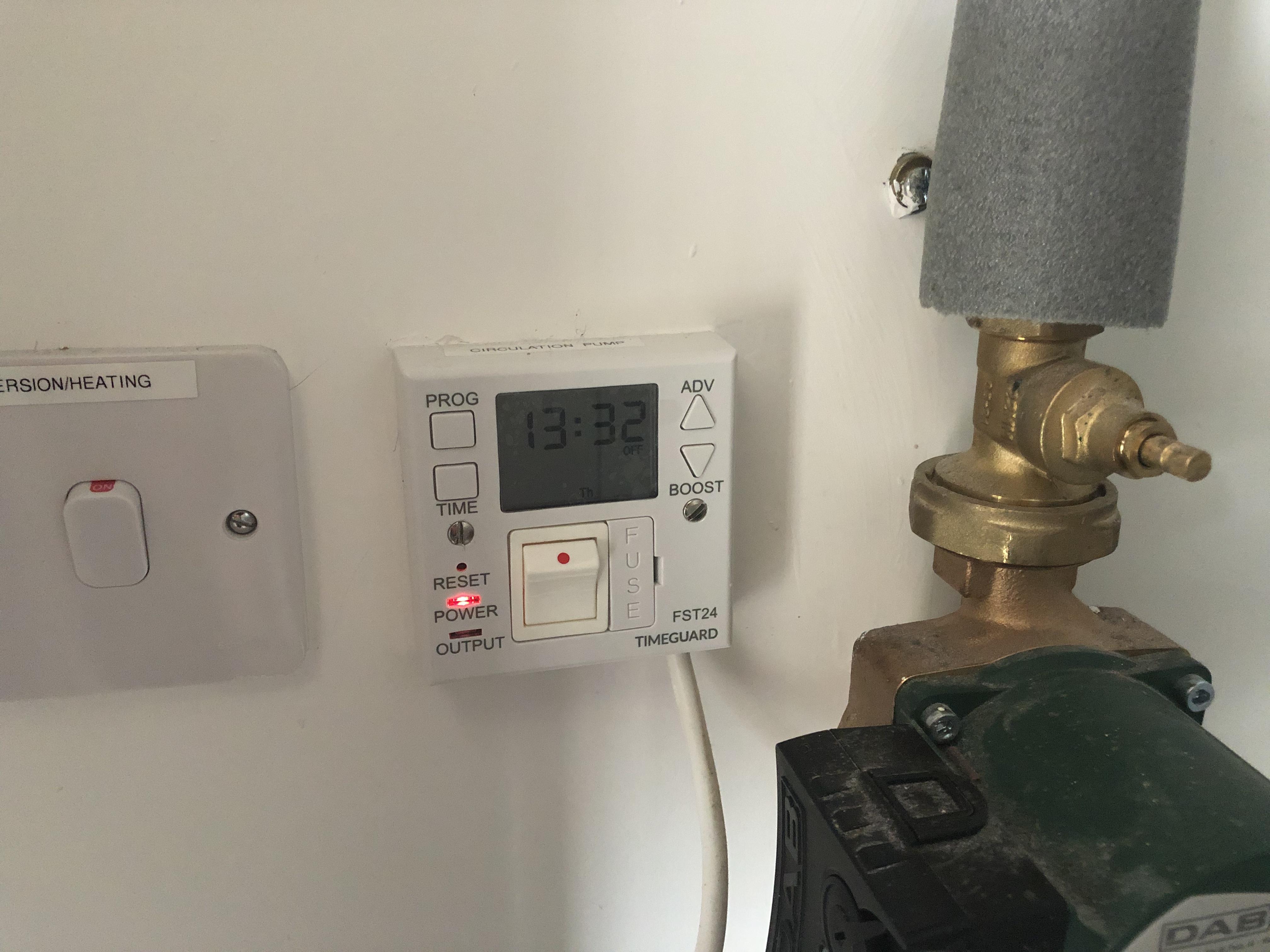

ProDave Posted November 11, 2021 Share Posted November 11, 2021 Follow that white cable coming out of the timeguard and tell us or post a picture where it goes to. 1 Link to comment Share on other sites More sharing options...
