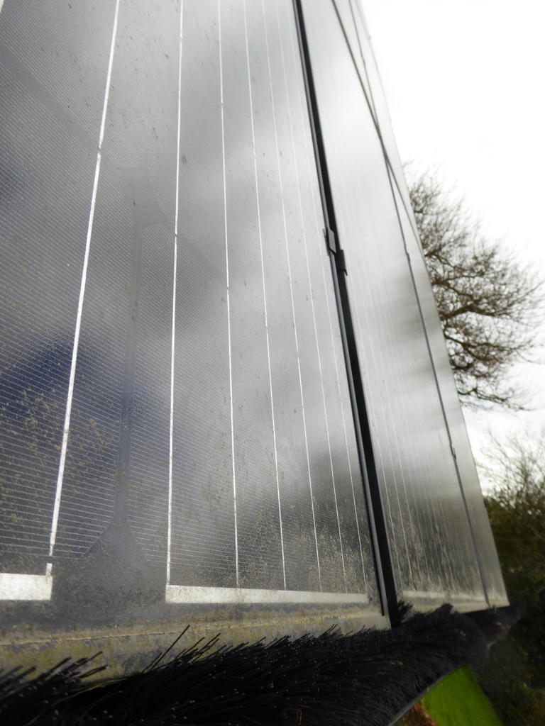

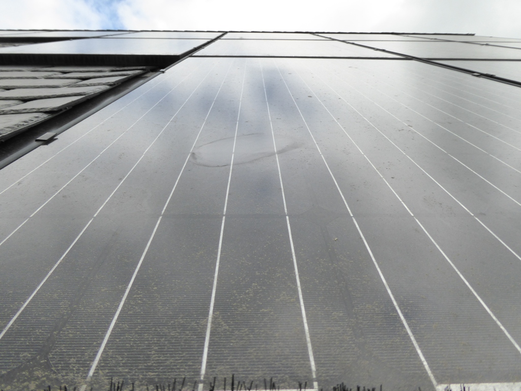

Jeremy Harris Posted April 13, 2017 Share Posted April 13, 2017 (edited) I managed to get up a ladder this afternoon to try and get a photo that shows the (now dead) algae and dirt: The stuff wipes off easily, I rubbed my hand over part of it and it cleaned up OK, so I think a water fed pole with a brush on the end will do the job OK. Looking at the muck closely confirms that it is an algal growth of some kind. My guess is that it's got a good foothold because the panels are faced with non-reflective glass (which was a planning requirement). The whole surface of every panel is affected, although the lower 1/4 of the bottom panels is the worst bit. Here's another photo looking up at the panels, with the bit I rubbed with my hand visible: Edited April 13, 2017 by JSHarris Link to comment Share on other sites More sharing options...

Jeremy Harris Posted April 13, 2017 Share Posted April 13, 2017 I'm not sure. Rain X might work, but it needs buffing off, and access to do that would be difficult, and would need scaffolding. I think that the best bet will be to give them a regular clean, to prevent the build up of algae. It's probably something that grows over the winter, so a yearly clean, at the right time of the year, may do the trick. Link to comment Share on other sites More sharing options...

Jeremy Harris Posted April 14, 2017 Share Posted April 14, 2017 Having been thinking about it, I think the answer is probably to get a cheap'ish window cleaning pole and just give the panels a clean once a year. It's taken about three years for them to get to this state, so an annual clean is probably enough. If cleaning them gets back the ~10% output that I think we've lost, then the pole would pay for itself in the first year. Link to comment Share on other sites More sharing options...

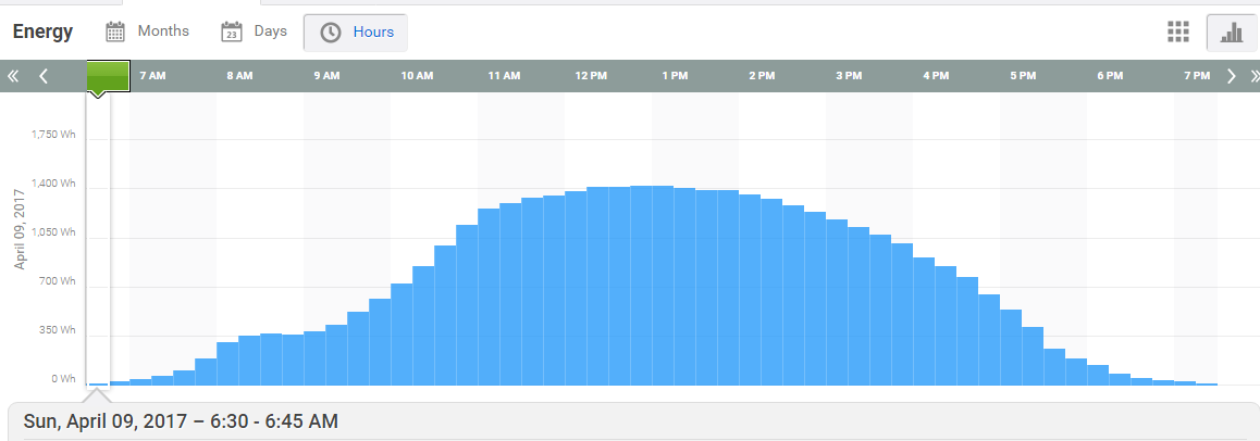

jack Posted April 17, 2017 Share Posted April 17, 2017 Bit late to this, but I was away on hols last week. 9 April was our best day since late August last year: (Note: the graph shows Wh per 15 min interval. So, for example, between 12 and 1pm we averaged about 5.6kW) Generation started at 6:30 in the morning and was still going after 7:15 that night. The flattening out between 8 and 9:30 is due to shading from trees beside the house. Link to comment Share on other sites More sharing options...
SteamyTea Posted April 18, 2017 Share Posted April 18, 2017 10 hours ago, jack said: Note: the graph shows kWh per 15 min interval Isn't it Wh? Link to comment Share on other sites More sharing options...
jack Posted April 18, 2017 Share Posted April 18, 2017 Good spot, thanks. I've corrected it. My main point was that it isn't a graph of power. Link to comment Share on other sites More sharing options...
SteamyTea Posted April 18, 2017 Share Posted April 18, 2017 Not unusual to get the best relative performance this time of year because of the combination of temperature and array angles. Link to comment Share on other sites More sharing options...
