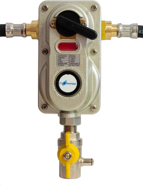

ykhan16 Posted November 8, 2021 Author Posted November 8, 2021 Thanks again for the links and everyone for their replies- been doing more reading and i'm kind of getting snippets of useful info across several different threads as opposed to one. I think i'll try to get a direct cost comparison quote between a system boiler + UVC and an ASHP + UVC, with both UVC's (400litres) having immersion heaters that can make use of the PV energy. I'll have a go at calculating with the spreadsheet what size of system I will need but I'd be grateful is anyone have a very rough ballpark figures for the costs of the equivalent systems given our house size and occupancy. @Temp This is a good suggestion - we would only use a bit of gas so that particular cylinder would last us years! No experience at all with cylinder gas but the one you use seems quite big so do you keep it inside or outside? I assume there is a regulator that you need to attach to it- does this need maintenance/replacing after a period?

Temp Posted November 8, 2021 Posted November 8, 2021 (edited) On 08/11/2021 at 12:17, ykhan16 said: @Temp This is a good suggestion - we would only use a bit of gas so that particular cylinder would last us years! No experience at all with cylinder gas but the one you use seems quite big so do you keep it inside or outside? I assume there is a regulator that you need to attach to it- does this need maintenance/replacing after a period? Expand Outside and there are rules on how near an opening it can be. We have two 47kg cylinders in a metal cabinet hidden behind our garage. Depending on how many rings you have you may need 47kg Cylinders as they have a higher flow rate than smaller cylinders. Our 2 cylinders are on a combined auto change over/regulator device that tells you when a switch over has occurred. Not sure this is essential but I wouldn't want my wife to run out in the middle of cooking Christmas lunch. For some reason most cabinets are a crazy price (£400-£1,000) so shop around. Ours was just over £200 but that was back in 2007ish. Full 47kg bottles are heavy and really need two people to load in and out of a car so perhaps see if you can get them delivered. Plan a route for how they will be moved from driveway to into cabinet. I discovered you can get quick fit connectors that don't need a spanner to dissconnect/reconnect a cylinder. Our regulator is 13 years old. not had any issues. Edited November 8, 2021 by Temp 1
