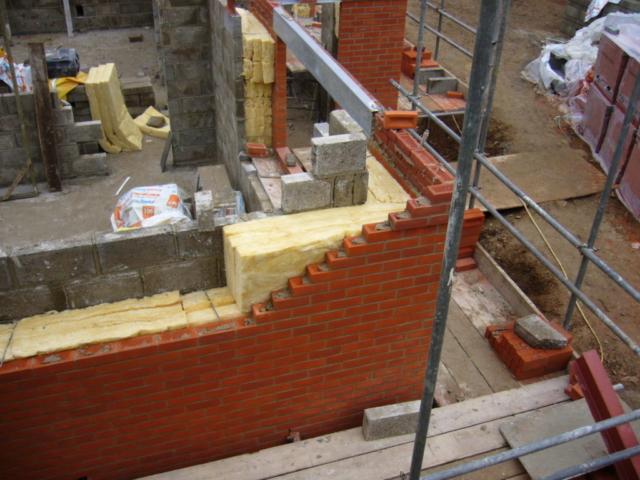

CalvinHobbes Posted November 6, 2021 Author Posted November 6, 2021 28 minutes ago, joe90 said: Wet plaster, block, wide cavity with beads or batts, brick, (I don’t like render, needs maintenance). Cheers, I know you did a 250 cavity, we can only go up to 200. Bit cheeky but you don't have a pic of your batts during the build?
joe90 Posted November 7, 2021 Posted November 7, 2021 9 hours ago, CalvinHobbes said: Cheers, I know you did a 250 cavity, we can only go up to 200. Bit cheeky but you don't have a pic of your batts during the build? No, my cavity was 200mm, no picture (must be the only thing I didn’t take a photo of) but similar to picture above by @tonyshouse. 1

CalvinHobbes Posted November 7, 2021 Author Posted November 7, 2021 9 hours ago, tonyshouse said: Oh thank you, that looks excellent. What width was the cavity? Crikey, can't tell you how excited we will be to even get that far!

Brickie Posted November 8, 2021 Posted November 8, 2021 23 hours ago, tonyshouse said: One thing I’d suggest if following Tony’s example-stagger the joints of the insulation sheets so there’s no chance of a small gap from inside to out. 1
tonyshouse Posted November 8, 2021 Posted November 8, 2021 I tried that but it proved more of a problem, I did slightly compress the blocks of sheets together to avoid that problem 1
tonyshouse Posted November 8, 2021 Posted November 8, 2021 305mm wide cavity 3x100mm batts, they don’t like sliding over each other, crumple, roll up or leave gaps at the corners. the brickies put some in which I had to remove and re do as folded! I banned them did every bit myself. 2
