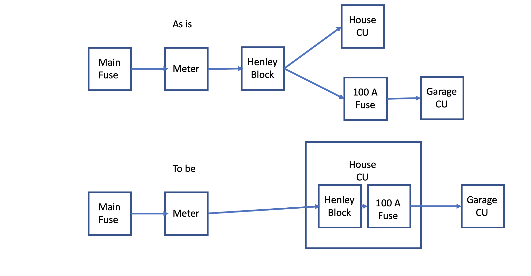

Fair point. So excuse the massive simplification but this is how I see it. Need to feed a garage CU so will need a 100A fuse between meter and garage CU if I want to be able to use the garage CU to also power a EV Charger. 100A Fuse is din rail mount so as far as my brain sees it I'm only missing a method of splitting the original 100A supply to do this.
Clearly I'm not an electrician, just interested and I don't understand why technically you wouldn't be able to do this

Oh and I forgot to add in the isolator switch after the meter so will have to imagine that
Edited by tvrulesme
Forgot the isolator switch

Lets face it, the supply head, electricity meter and big tails that connect to the consumer unit are not pretty.  They need to be enclosed in a cupboard where they can;t be seen, or a convenient cupboard designed for this is a "Meter Box"
That is what we have so the consumer unit is on the wall in the utility room with no visible cables (actually partly recessed into the wall)
If you did it the conventional way, you would just have your henley blocks and a switch fuse in the meter box and all would be neat and tidy.
Do you actually need 100A to the garage CU?  I doubt it, and in any event I would never put more than an 80A fuse in the switch fuse otherwise there is no discrimination between that and the supply fuse.
Now, if you could manage with 63A to the garage CU, you could carefully choose the make of consumer unit, fit a high integrity consumer unit (posh name for one that allows a few circuits not protected by RCD) then you could feed the garage CU from a 63A MCB.

As usual ProDave a superb answer. Yes sorry it should have been an 80A fuse in my picture.
So by my basic calculations I will need 69A in the garage as it's going to supply all of this
The current meter is in a cupboard but is in the kitchen and I have pretty bad OCD which will make me want to vomit every time I open the cupboard. Really don't want to move the main power cable in and not sure I would be able to as it's a listed building and they are super picky with this stuff

take the tails that come out of the meter and fit a pair of Henley blocks.
1 set of tails to the consumer unit int the house.
1 set of tails to a kmf switch fuse to feed garage consumer unit.
nice and easy

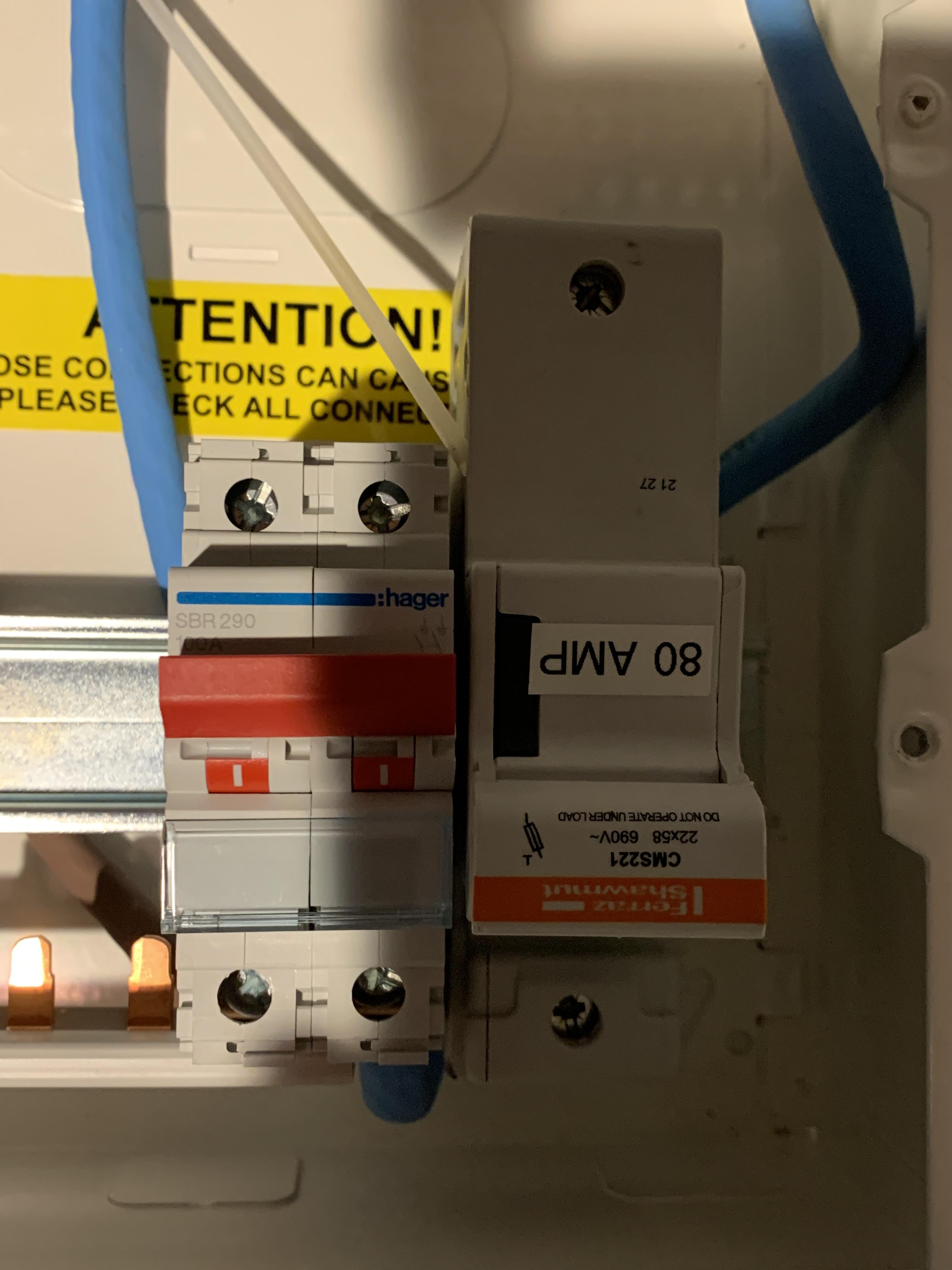

It’s not ok to put a protected box in a CU but it’s ok for Hager to pre-wire with two 25mm2 cables into a single entry point? Could I not just ask the spark to ignore the whole connection block thing and stuff two cables into an entry point to double up the outputs?

You won’t get 2x 25mm tails in each pole of a 100A main switch

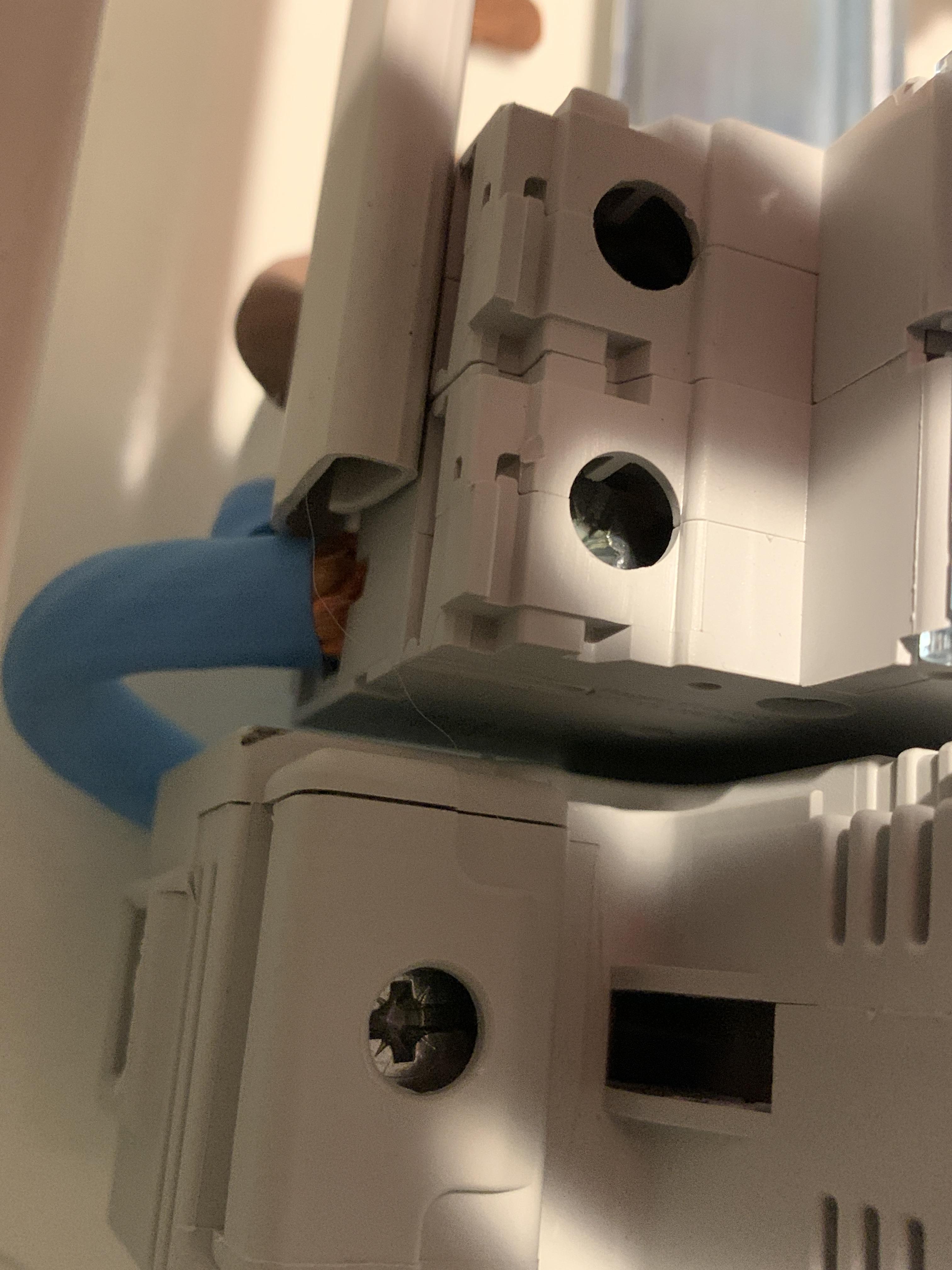

There are definitely 2x 25mm 100A flexible links in a single neutral pole of the 100A DP isolator in the picture above. The angle isn’t great but can take another tomorrow
Another picture. 1 link to top row of duplex, one to bottom
