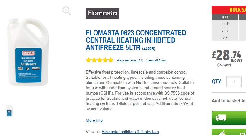

MortarThePoint Posted October 30, 2021 Author Share Posted October 30, 2021 I've used 16mm pipe with an ID=12mm so 113ml per metre. My total system volume is 180l, so I'd need 45l of this stuff or 9bottles at £202. Expensive but less than burst pipes. Do most people have antifreeze/inhibitor in their UFH systems? I know inhibitor is a must for radiator systems, but don't know about UFH. @Nickfromwales do you normally install inhibitor antifreeze in UFH? Link to comment Share on other sites More sharing options...

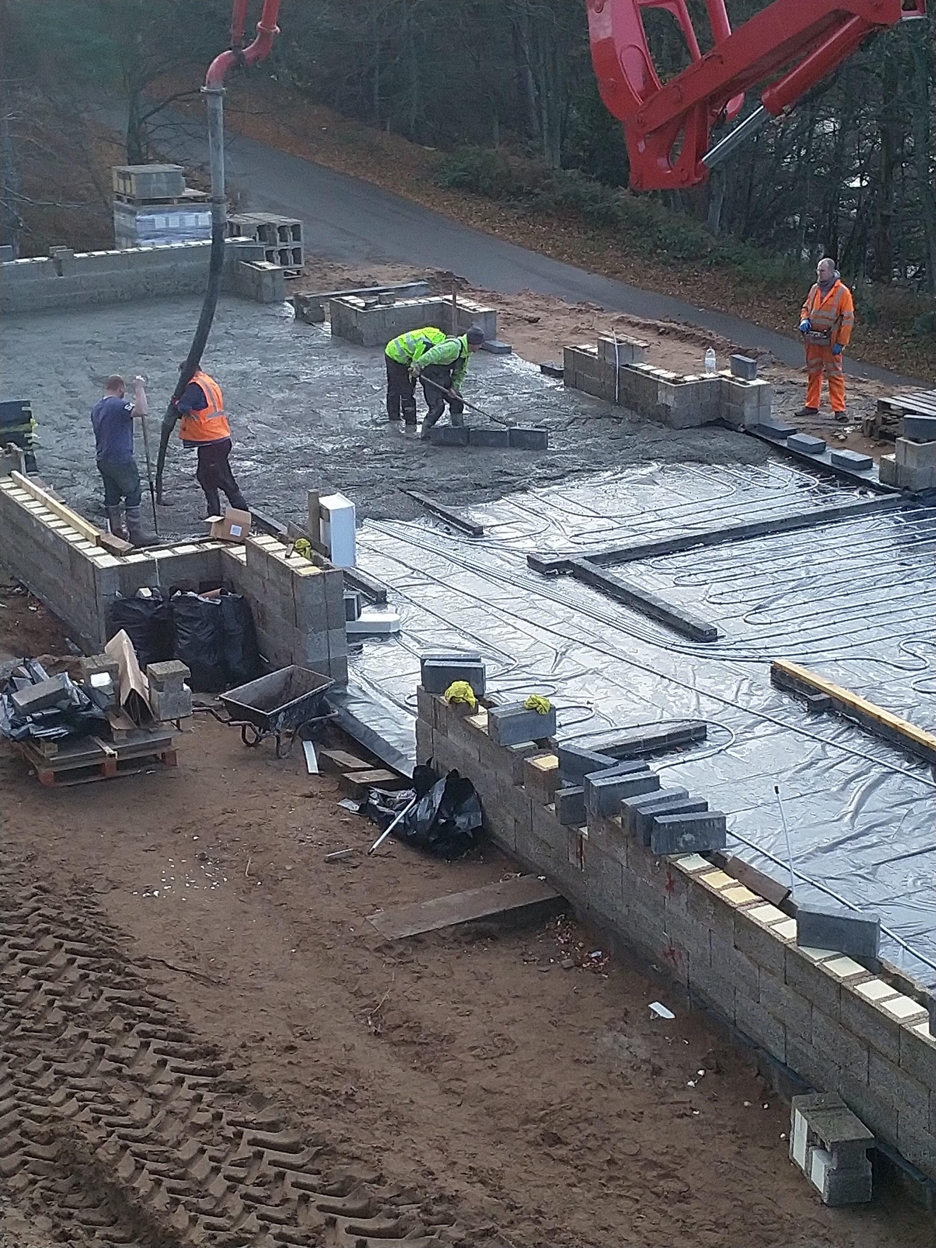

LA3222 Posted October 30, 2021 Share Posted October 30, 2021 11 minutes ago, RHayes said: Agreed, but still best to put under pressure at least when building, if not all the time. Not really, what is the argument for doing so? So you know if a pipe gets punctured? If that happens mid build what are you going to do about it? Nothing. If a pipe somehow gets punctured mid build you ain't doing nothing about it until you start bringing the heating online. It's sat in a concrete slab and in an 80m pipe could be anywhere. The only way to easily find is pump hot water through and use a flir to identify pooling. So having the pipes under pressure doing the build is a pointless exercise. Even during a concrete pour, why? If one gets trodden on and punctures, like fook you're gonna stop the concrete pour to find it, you will crack on and park it as a future problem to deal with. People on here seem to have an obsession with pressuring pipes. Pointless. I would also suggest the pipes are very robust, to puncture one would be extremely unlucky. Link to comment Share on other sites More sharing options...
MortarThePoint Posted October 30, 2021 Author Share Posted October 30, 2021 (edited) 1 hour ago, SuperJohnG said: Are the pipes empty and house up? Pipes full of water and house roof on with proper windows half in (poly windows elsewhere). 36 minutes ago, LA3222 said: Even during a concrete pour, why? It is the conventional wisdom to do a wet pressure test before the pour and to leave it pressurised during the poor. The pressure test could identify if the pipe was damaged as laid or at another point prior to concrete which you could identify and rectify before pour. Agree you are unlikely to do anything during pour. But it's nice piece of mind to still have pressure after the pour. Finally, a pressurised pipe will better resist damage from being squashed. 6bar of pressure is around 100PSI so can resist the full weight of a person across an area of just 12mm x 100mm which is around a foot's width. Yes the pipe is strong, but may as well help it. Here I am convinced water is a better choice than air as air is compressible and water not. That means that air would only ever push back with the system pressure whereas water could momentarily increase the pressure, and locally due to inertia. The inertia of the water would resist impacts much better than air would. 36 minutes ago, LA3222 said: People on here seem to have an obsession with pressuring pipes. Pointless. I would also suggest the pipes are very robust, to puncture one would be extremely unlucky. Agreed, but when inexperienced it is often about minimising unquantified risks. You don't have the experience to know it will be fine anyway so you do what you can to give yourself the best chance. Edited October 30, 2021 by MortarThePoint Link to comment Share on other sites More sharing options...

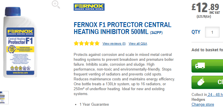

MortarThePoint Posted October 30, 2021 Author Share Posted October 30, 2021 (edited) Plain inhibitor (no antifreeze) is much more dilute and cost effective than with antifreeze but obviously wouldn't add any winter protection https://fernox.com/product/protector-f1-500ml/ https://www.screwfix.com/p/fernox-f1-protector-central-heating-inhibitor-500ml/342pp Edited October 30, 2021 by MortarThePoint Link to comment Share on other sites More sharing options...
LA3222 Posted October 30, 2021 Share Posted October 30, 2021 18 minutes ago, MortarThePoint said: It is the conventional wisdom to do a wet pressure test before the pour and to leave it pressurised during the poor. This smacks of doing something because "thats what people do" rather than considering 'why' am I doing this and 'what does it achieve'. 20 minutes ago, MortarThePoint said: The pressure test could identify if the pipe was damaged as laid or at another point prior to concrete which you could identify and rectify before pour. The pipes come pre pressurised, the minute you cut it you will 'know' that the pipe hasn't been damaged during laying. After laying its child play to walk around the slab without deliberately standing on the pipe. During our you ain't doing anything about it. People will stand where they will. 22 minutes ago, MortarThePoint said: Finally, a pressurised pipe will better resist damage from being squashed. 6bar of pressure is around 100PSI so can resist the full weight of a person across an area of just 12mm x 100mm which is around a foot's width. This is just a load of good old fashioned tosh! Yeah the maths works out, in practical terms it is over engineering at its finest. The pipe is solid, I could jump up and down all day long on a piece sat on mesh and the odds of me piercing it are low. If you want to do it then do it, it doesn't cost anything other than a few quid and some time. I would question what is the point. I did all of my slab except the concrete pour, was walking all over the pipe for weeks before concrete went in, didn't waste my time pressurising and no drama. That pipe is solid, you ain't gonna puncture it unless trying to. The thing to worry about is kinking it rather than puncturing it. 1 Link to comment Share on other sites More sharing options...
MortarThePoint Posted October 30, 2021 Author Share Posted October 30, 2021 1 hour ago, LA3222 said: This smacks of doing something because "thats what people do" rather than considering 'why' am I doing this and 'what does it achieve'. The pipes come pre pressurised, the minute you cut it you will 'know' that the pipe hasn't been damaged during laying. After laying its child play to walk around the slab without deliberately standing on the pipe. During our you ain't doing anything about it. People will stand where they will. This is just a load of good old fashioned tosh! Yeah the maths works out, in practical terms it is over engineering at its finest. The pipe is solid, I could jump up and down all day long on a piece sat on mesh and the odds of me piercing it are low. If you want to do it then do it, it doesn't cost anything other than a few quid and some time. I would question what is the point. I did all of my slab except the concrete pour, was walking all over the pipe for weeks before concrete went in, didn't waste my time pressurising and no drama. That pipe is solid, you ain't gonna puncture it unless trying to. The thing to worry about is kinking it rather than puncturing it. Fair play, you now have the experience to know how robust it is. Personally, I still wouldn't risk it and would pressure test and then leave the water in. It's less buoyant with water in, but shouldn't be going anywhere anyway. I think I read somewhere about the initial deformation of the pipes when pressurised, but it's not like screed isn't strong enough to resist that. Link to comment Share on other sites More sharing options...
RHayes Posted October 30, 2021 Share Posted October 30, 2021 Agreed, pipes are robust but you'd be supprised what happens. The principle behind pressurising it (whether air or water) during the build is that you will be able to tell where it comes from as soon as it is puncture, either by escaping air or a pool of water. That way doing further testing down the line which isn't always as easy as hot water and flir isn't needed, even if you do deal with it at a later date. Anyway, why not leave it under pressure. Nothing to loose as far as I can tell. Link to comment Share on other sites More sharing options...
