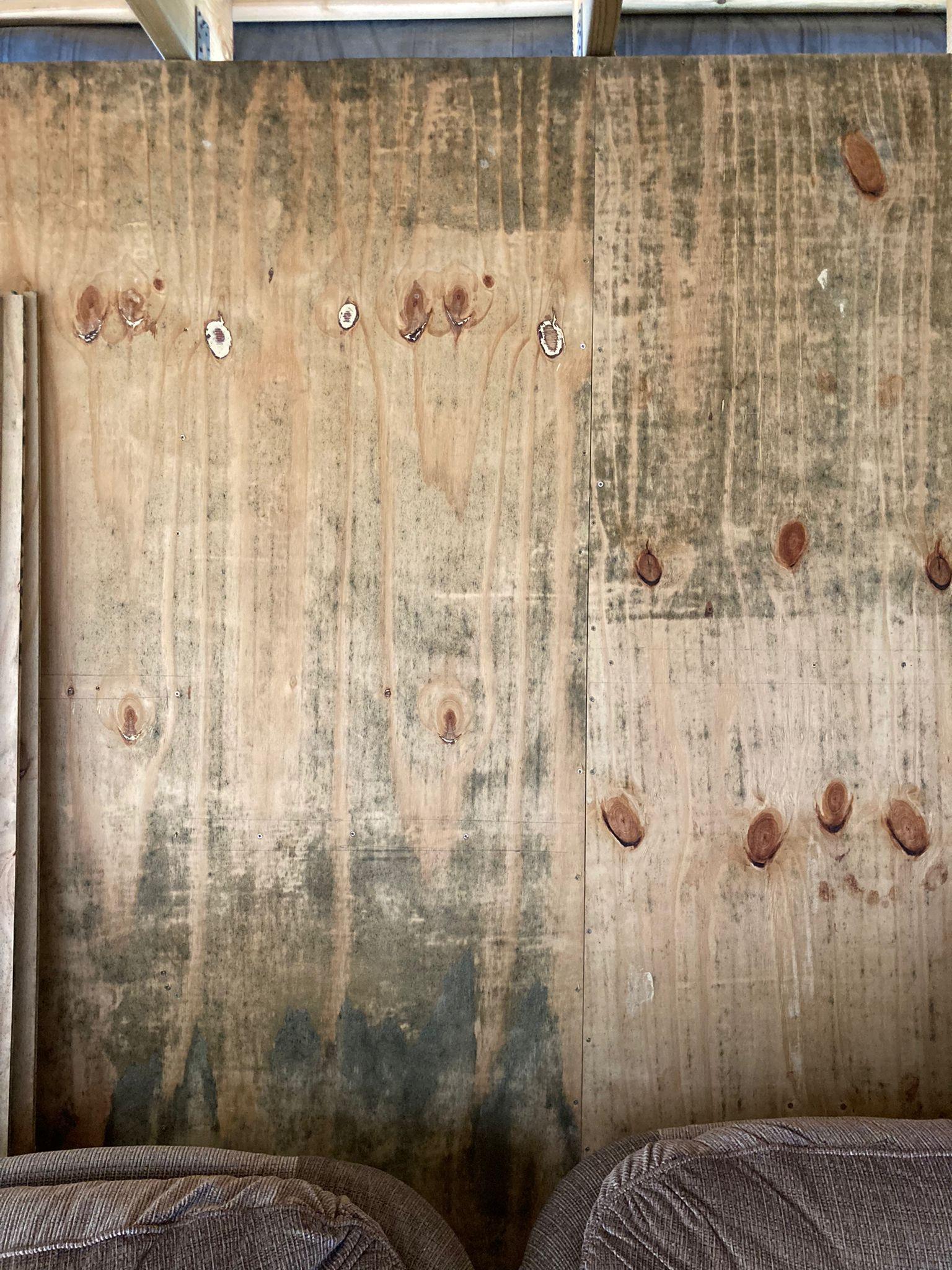

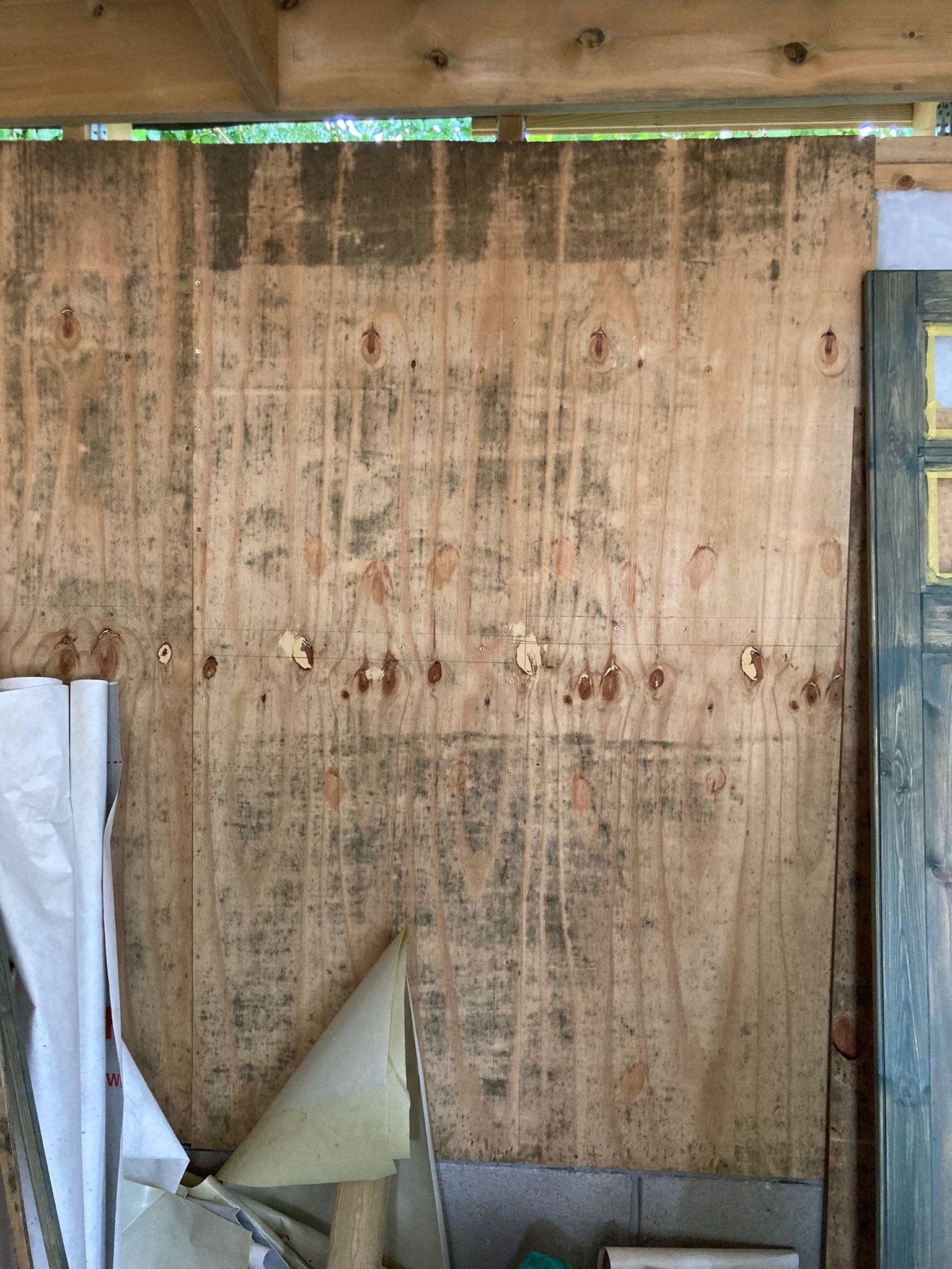

Omnibuswoman Posted October 25, 2021 Share Posted October 25, 2021 We put the plywood onto the inside of our stud frame back in June/July - all seemed fine. On Friday we returned to the workshop after a fortnight away and found every wall covered in black mildew. There has been plenty of airflow in the workshop as it has no front doors as yet. Does anybody have any ideas about why this has occurred? It has been quite stormy recently (SE Cornwall), but only normal for Cornwall, and the walls have stayed dry as the building is wrapped in Tyvek. There were also some part sheets of ply leaning against the walls, and where two sheets touched the ply was clear of mildew (photo 1). All wood exposed to the air was blackened. How can we treat or seal this to stop it from getting worse? Link to comment Share on other sites More sharing options...
Onoff Posted October 25, 2021 Share Posted October 25, 2021 Is it not because you have no proper insulation and airtight membrane? The temperature in the building is marginally higher than the outside so condensation us forming on the inside of the ply? Just a guess. Link to comment Share on other sites More sharing options...

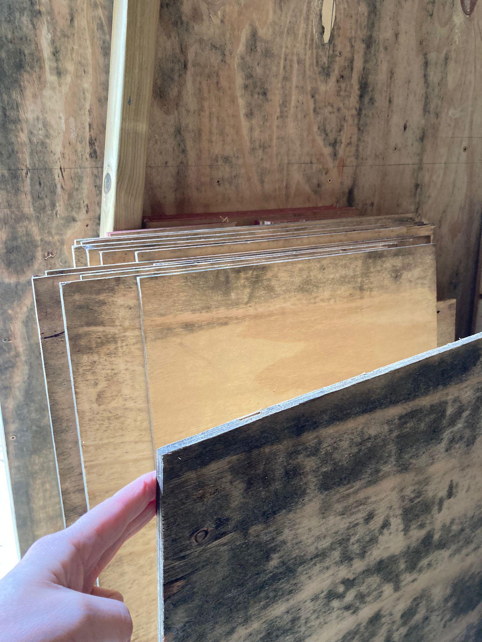

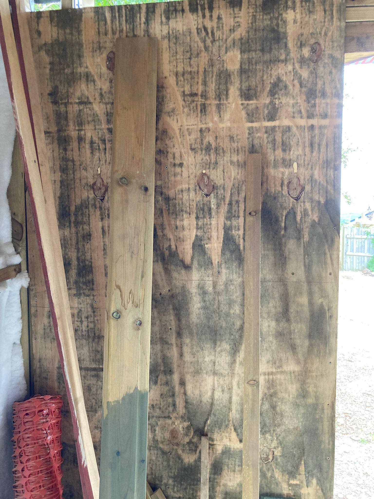

Omnibuswoman Posted October 25, 2021 Author Share Posted October 25, 2021 We do have insulation in already (a novel product made from old plastic bottles that made a fantastic dog bed) but not an airtight membrane - only a tyvek membrane wrapped around the outside. Interestingly, today we removed two of the ply sheets from the front wall and found that behind them (on the side facing the insulation) there was no mildew at all... That would support your theory about the inside of the ply having condensation forming on it, but I thought that ply could absorb and release a certain amount of moisture without any harm coming to it... Link to comment Share on other sites More sharing options...
ToughButterCup Posted October 26, 2021 Share Posted October 26, 2021 14 hours ago, Omnibuswoman said: ... How can we treat or seal this to stop it from getting worse? ... Add just enough heat to the inside of the structure to prevent condensation. 1 Link to comment Share on other sites More sharing options...
Ferdinand Posted October 26, 2021 Share Posted October 26, 2021 I would stick a min/max hygrometer in there for a bit to get a handle on what is happening to the humidity. Wants to be below about 60% iirc. About a tenner: https://www.amazon.co.uk/ThermoPro-TP50-Digital-Thermometer-Temperature/dp/B01H1R0K68/ I can't remember if it is insulated at all or it has lecky, but a traditional loft heater on a timer for a bit every day might be one long term option if you can't do it passively. Something similar to this one at £16. https://www.toolstation.com/dimplex-thermostatic-tubular-heater-ipx4/p17033 There may also be a suitable anti-mould paint. If you replace, you could do it with hollow soffit board plastic cladding, perhaps? Link to comment Share on other sites More sharing options...

riboid Posted October 26, 2021 Share Posted October 26, 2021 Mould can form on wood with dampness levels above 20%. For internal of rooms, as stated rightly above, your RH levels should be below 60% or ideally 50%. Looks like limited air movement (but you said plenty airflow) in that place and condensation is forming on the wood producing mould. I would get a heater of some sorts in but not a gas bottle heater as this will increase your moisture levels. I had to hire x2 electric heaters, but word of warning - they cost a lot of money to run! Link to comment Share on other sites More sharing options...
Omnibuswoman Posted October 26, 2021 Author Share Posted October 26, 2021 Thanks all. This is our workshop which at present doesn't have leccy, or front doors, or fascia and soffits, so no option to heat it at the mo, but we expect/hope to have the front doors, fascia and soffits on by the end of next weekend. This may potentially make the problem a lot worse as then the airflow will reduce dramatically, although there will be less weather coming in I would hope, and at least then it would be worth putting in some heat. However the electricity supply hasn't been connected up yet, so no source for heat in any case. I'm not sure whether I should consider binning the lot and starting again with OSB, but as it cost about £600 for the ply I'm loath to be so wasteful! Link to comment Share on other sites More sharing options...
Omnibuswoman Posted October 26, 2021 Author Share Posted October 26, 2021 Actually, something just occurred to me about the aetiology of the mould - a month ago we moved a three piece suite and a further armchair up to the workshop which had come out of my elderly Great-Aunt's house earlier this year. Her house was full of black mould - it was a chronically cold and damp solid stone wall Victorian cottage. I wonder if the spores for this have come from us sitting on the sofa, and now that the weather has been quite wet it has taken up residence on our ply walls... that would explain why the inside of the ply is not affected... Link to comment Share on other sites More sharing options...
Onoff Posted October 26, 2021 Share Posted October 26, 2021 I put up an old shed that tbh I should have chopped up and used for firewood. I had this mad idea to "insulate" it. In some areas there's a breathable membrane on the outside under the timber cladding. Between uprights I foam gunned. The thing is I put 6mm ply over this that soon went speckly and mouldy. What I did was wash down with a bleach in water solution and paint with a shed and fence treatment, chestnut I think it was. They do loads of colours, pastels etc that might suit. I'd maybe do a test panel. I figure if the surface is water repellent, it's less damp thus less hospitable to mould. 1 Link to comment Share on other sites More sharing options...

riboid Posted October 27, 2021 Share Posted October 27, 2021 I think opening the doors and letting the humidity equalise inside and out would be the best idea. I have been on several projects, where they encapsulate and try (oil and gas) to preserve items, which could be anything from substations to equipment and more than not, the act of preservation or covering it with items actually does more harm than good rather than letting things breathe naturally. I would certainly wash down and then treat and prior to any insulation going in they studs, get a dehumidifier in (i hired an industrial one from jewsons but I have used mega dehums in the shipyards whilst overseeing complex paint/coatings projects) and dry that baby out as much as you can once it is more or less wind and water tight. You don't want to be locking moisture in anywhere. 1 Link to comment Share on other sites More sharing options...

Ferdinand Posted October 27, 2021 Share Posted October 27, 2021 1 hour ago, Omnibuswoman said: Crikey!!! I’m going to give washing it down and painting with antimicrobial paint a go, but am open to needing to replace it all if that doesn’t work. In the meantime I’m wondering if leaving the front doors open might be a good idea rather than sealing the place up with no heating in situ yet. I’m sure it’s going to get worse. What is the RH level? I might be inclined to close it long enough to dehumidify with one on a long cable, if you can. Link to comment Share on other sites More sharing options...
