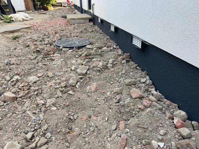

DeanAlan Posted January 17, 2023 Share Posted January 17, 2023 Just searching re my own issue (post here a few hours ago). Our vents are straight through as no cavity and SIPs above footings. 2 of the vents are too low for our Structural Warranty folks. They need 150mm clear above ground but that is going to be hard. I was considering external periscope as @Mr Punterimage above and your thinking @Hilldes If I were to connect plastic periscopes to these two compromised vents (it is a no through alley way between my house and neighbours where our extensions from semi-detach houses run parallel and 600mm apart. Question - how would I form a waterproof connection between the airbrick and the periscope? - Should I cut the airbrick out and put the periscope end in and mortar that in place or can I form a plastic to airbrick waterproof connection and with what? Then, what should I encase the plastic in for mechanical stability? I could just encase in concrete or (more effort) built a small brick chimney around it. Really interested (desperate for) people thoughts. We're honestly close to loosing our house because we're out of money, out of time and this is the absolute last thing (so they tell me) before the mortgage goes through and we're in the clear. Feels so close but so far at the moment. Link to comment Share on other sites More sharing options...
Hilldes Posted January 18, 2023 Author Share Posted January 18, 2023 On 17/01/2023 at 17:37, DeanAlan said: Our vents are straight through as no cavity and SIPs above footings. 2 of the vents are too low for our Structural Warranty folks. They need 150mm clear above ground but that is going to be hard. I was considering external periscope as @Mr Punterimage above and your thinking @Hilldes If I were to connect plastic periscopes to these two compromised vents (it is a no through alley way between my house and neighbours where our extensions from semi-detach houses run parallel and 600mm apart. Question - how would I form a waterproof connection between the airbrick and the periscope? - Should I cut the airbrick out and put the periscope end in and mortar that in place or can I form a plastic to airbrick waterproof connection and with what? Then, what should I encase the plastic in for mechanical stability? I could just encase in concrete or (more effort) built a small brick chimney around it. Really interested (desperate for) people thoughts. We're honestly close to loosing our house because we're out of money, out of time and this is the absolute last thing (so they tell me) before the mortgage goes through and we're in the clear. Feels so close but so far at the moment. @DeanAlan If I picture your setup correctly, then I guess you have no option but fitting telescopes externally. They may not need sealing to existing air bricks depending on how you conceal the periscopes on the outside - I encased my periscope vents in XPS insulation and rendered across the outer face which essentially seals them in. Interested in your original design for these vents not needing to be telescope-periscope. Does that mean all or part of your ground floor build up (suspected floor, insulation and slab) are above DPC level? Link to comment Share on other sites More sharing options...
