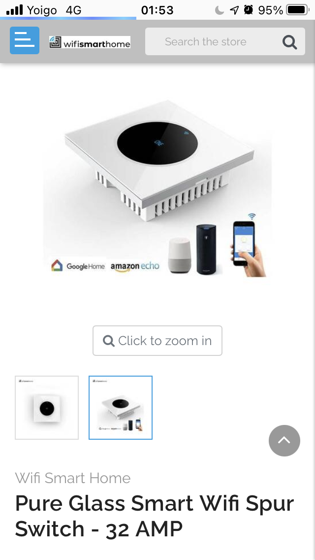

IFTTT (if this then that)
Does anyone have experience of using a smart wi-fi spur with IFTTT and Ocotpus Agile?
I’d like to use one of these to tell my Sunamp (and Willis heaters when/if we need them) to fire up when the Agile price goes below a set figure.
Would one of these do the trick?
https://wifi-smart-home.co.uk/smart-wifi-spur-switch-32-amp-pure-glass/

Bugg*ry bollox. I’ve just watched the little vid on that Shelly website, is there nothing Shelly can’t do! I’ll give a lot of it a miss, (especially the camera in the hallway!) but thanks for the steer I shall definitely look in to the 1PM.

On 21/10/2021 at 14:41, PeterW said:
Probably best to use a 1PM
That does look like the one for me. I’ve got a lot of learning to do as I’ll want the Sunamp to come on when the electricity price goes below ‘X’ and switch off when it goes above ‘X’ which I think the combination of Octopus Agile/IFTTT and the Shelly 1PM should do for me but I fear it won’t be easy for me to line those ducks up, especially as I don’t do FB. YouTube it is I reckon.
