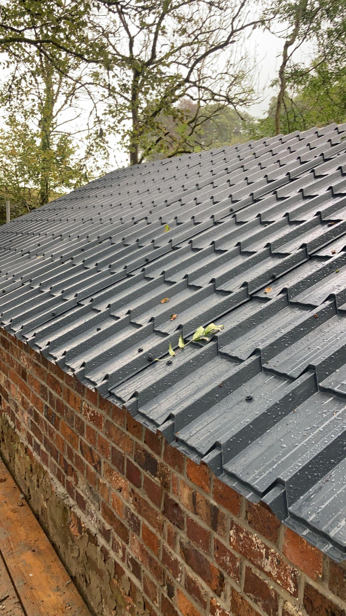

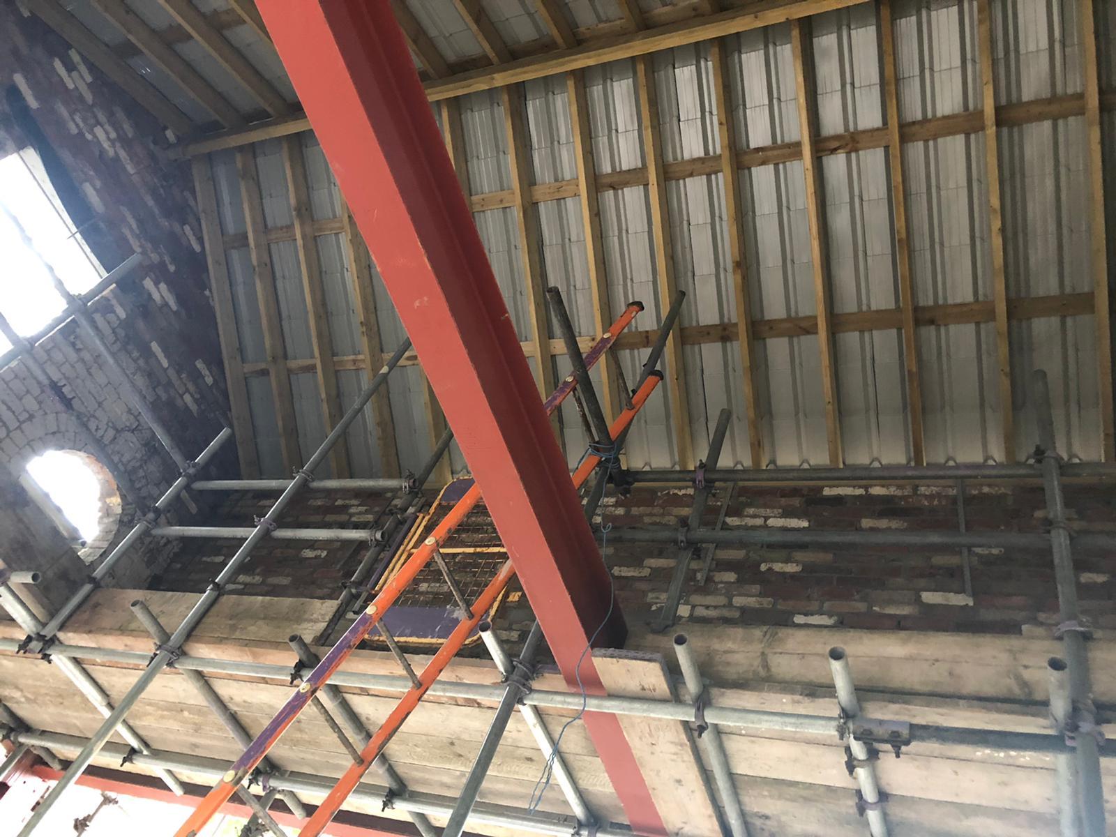

Lee Ridley Posted October 16, 2021 Share Posted October 16, 2021 My roofers fitted metal roof sheets ( steel box profile tiles) without the felt underlay. They had timber fitted onto the rafters and metal sheets screwed directly on to them. It looks nice, but I am concerned about the potential leaks and rain noise, too. They said that I don’t have to have the felt as I’ll have kingspan insulation with vapour barrier. The Kingspan insulation will be fitted between the rafters and underneath. Am I right to be concerned, or is it ok to fit it like this?? Can I do anything to improve it now? Appreciate any advice from the roofers with experience in metal roofs. Thank you. Link to comment Share on other sites More sharing options...

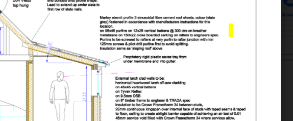

Thedreamer Posted October 16, 2021 Share Posted October 16, 2021 What do you plans show? You should have a section plan which shows the breakdown of layers/materials in the roof, wall, floor etc. We have a small metal room roof on our lean to and it has a breather membrane underneath to catch the condensation, Link to comment Share on other sites More sharing options...

joe90 Posted October 16, 2021 Share Posted October 16, 2021 9 minutes ago, Thedreamer said: What do you plans show? You should have a section plan which shows the breakdown of layers/materials in the roof, wall, floor etc. Yes, what did your architect draw?, did your roofer follow the plans?. Link to comment Share on other sites More sharing options...
Thedreamer Posted October 16, 2021 Share Posted October 16, 2021 It would be useful to post an extract of your section plan. Here is mine. You This is the first step to correct the problem. Link to comment Share on other sites More sharing options...

saveasteading Posted October 16, 2021 Share Posted October 16, 2021 Can you tell us the product please? Whatever the shape, and this is pressed to look a bit like tiles, this is metal cladding. Therefore it ether needs to be sealed at every joint to be completely weathertight, or it needs to ventilate, and have another weather layer below it. Even if sealed, you will have issues from condensation. My first impression therefore is that this is ok for a tractor shed but not anything occupied or heated. 1 Link to comment Share on other sites More sharing options...

Iceverge Posted October 16, 2021 Share Posted October 16, 2021 (edited) Condensation will form on the underside of the roof and it will drip onto your kingspan and probably make its way through the roof onto your plasterboard. We have some old outbuildings and the underside of every single metal roof gets condensation. The only one that doesn’t drip has chicken wire strewn between the purlins to hold up some cheap roofing felt. You’ll need to take the roof off and put up felt. Over the battens will work fine. On another note the fleece “non drip” roofing doesn’t work very welll here in Ireland. For me roofing felt every time. I wouldn’t put PIR in the roof either for a list of reasons as long as my arm. Use mineral wool batts or cellulose , airtight membrane, insulated service cavity and plasterboard. Edited October 16, 2021 by Iceverge 2 1 Link to comment Share on other sites More sharing options...
