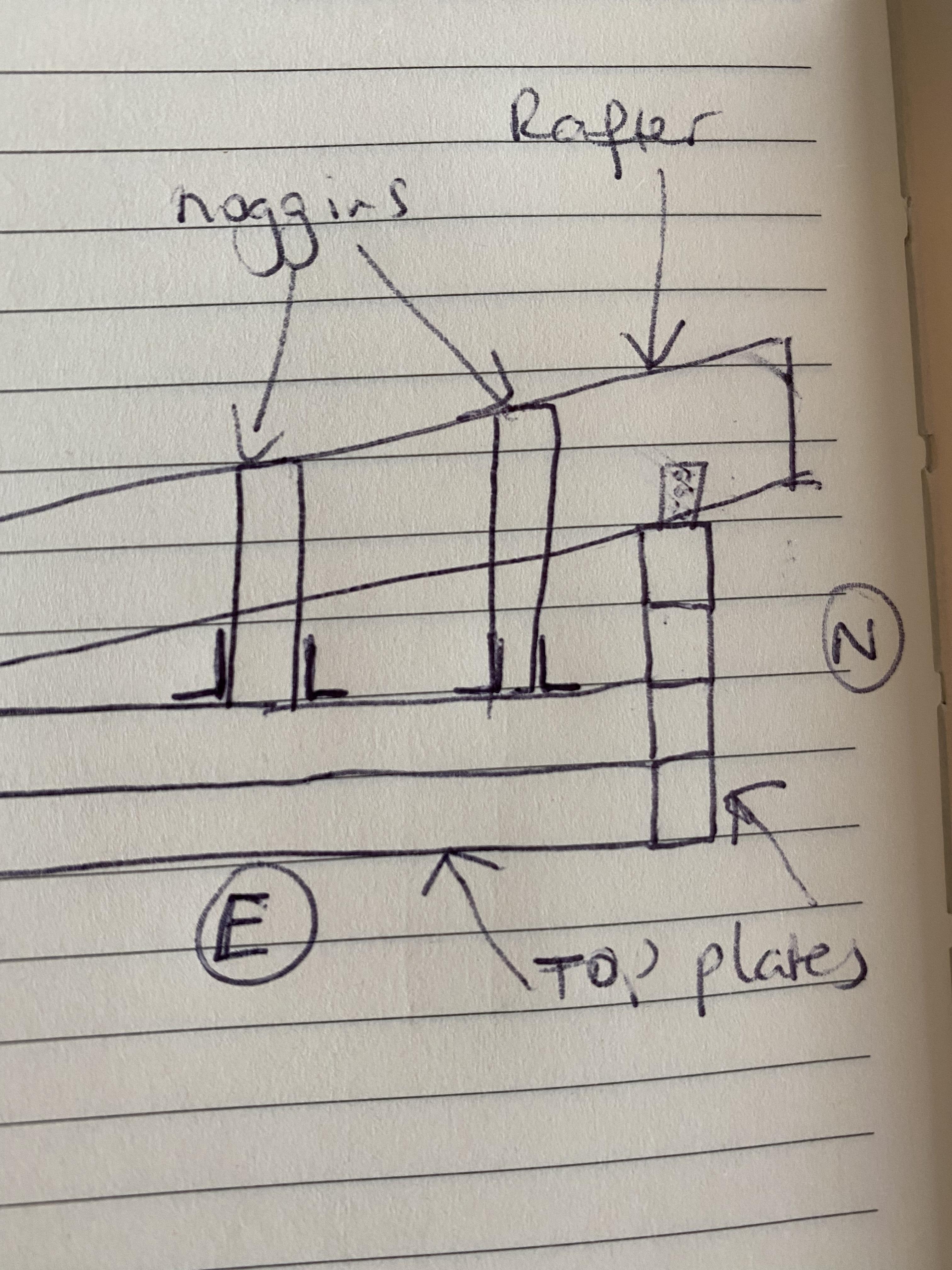

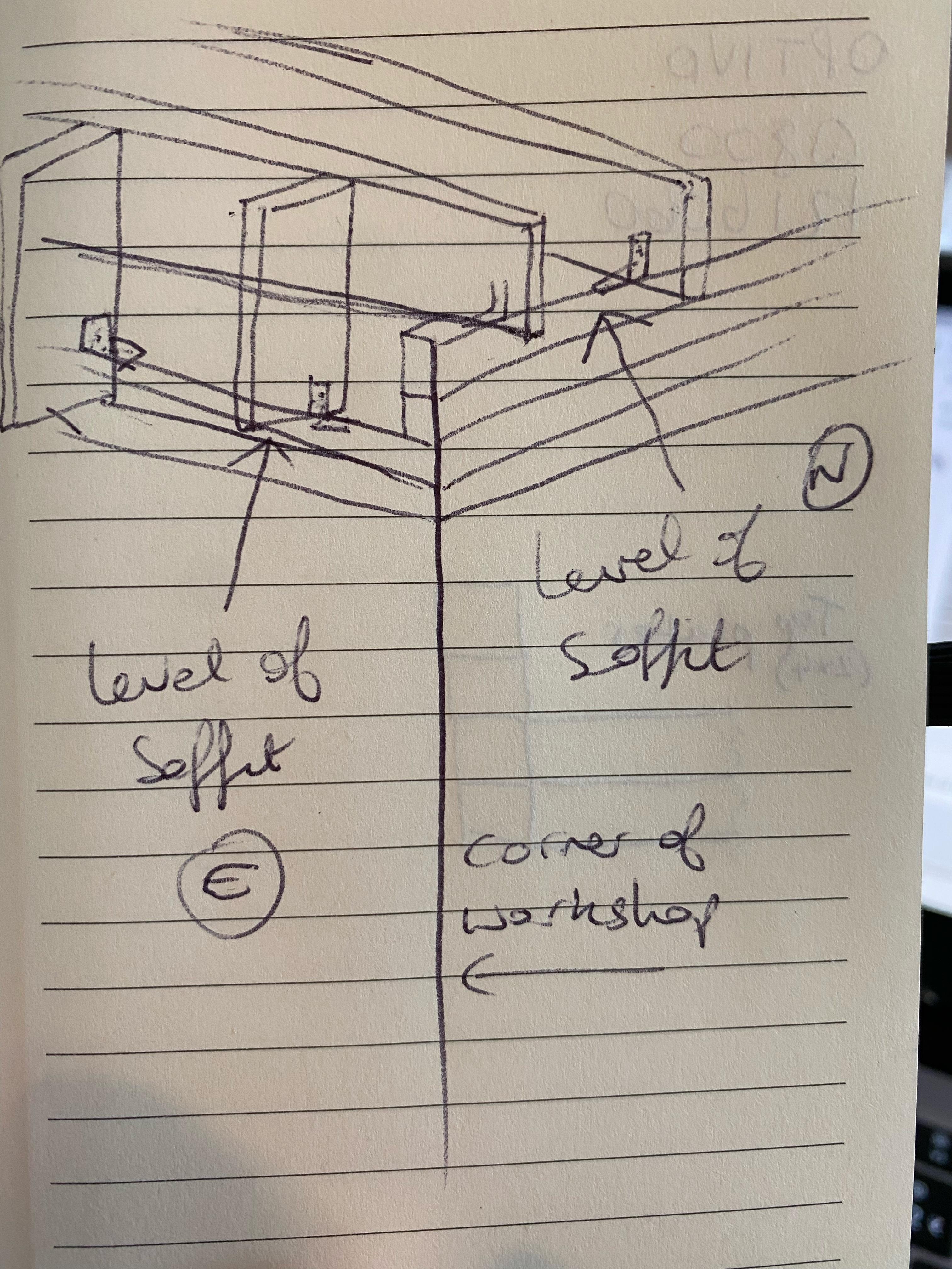

Omnibuswoman Posted October 13, 2021 Share Posted October 13, 2021 I have reached the point of ordering the fascias and soffits (again!) ready for our next stint of work on the workshop, but have run into a problem that I'm not sure how to solve, and I'm concerned it's because we (I) have made a mistake... The roof is a pent roof with the highest edge on the north side of the workshop. On the north side we put four top plates instead of two (which is what the other three sides have). The rafters run north-south fixed to the top plates, so there is a 9cm height difference between the two sides, creating the slope to get the rain to run off. On the east and west sides we fixed noggins on top of the top plates, abutting the side of the last rafter, to provide an overhang of about 20cm. Now that I'm looking at fascias and soffits, i've realised that the soffit will be sitting 9cm higher on the north side than on the other three sides (see attached drawing) because the rafters are sitting on the extra two top plates. So I'm wondering whether I should run the fascia 9cm beyond (below) the bottom of the rafters on the north side, so that where it abuts the east and west corners there will not be a difference in the level of the soffit. The question is, if I do that, what do I fit the soffit to?? Have I made a massive boo boo?? All advice very much appreciated. Cheers, M Link to comment Share on other sites More sharing options...
markc Posted October 13, 2021 Share Posted October 13, 2021 Run the soft parallel to the roof line … like an gable end would be. of wait, just re looked at your sketch … hmmm, so the end soffits will be level, not following the roofline, and I feel the extra deep facia at the front may look out of place. not helping much here am I. ? 1 Link to comment Share on other sites More sharing options...
Dave Jones Posted October 13, 2021 Share Posted October 13, 2021 can you not continue the wall/cladding up higher to make a gable out of it so you can use the same size soffetts ? Link to comment Share on other sites More sharing options...
SimonD Posted October 13, 2021 Share Posted October 13, 2021 Two ideas, just to throw them out. 1st is to modify your noggings for the overhang by ripping a firring strip at the same angle as the rafters and then you frame what are called gable ladders which provide you with the overhang - the gable ladder rests on the firring and is fixed to the rafter. With only 200mm overhang you might actually get away with it simply screwed or bolted to your final rafter and cantilevered without support if you're using 18mm plywood or osb roof deck. 2nd is to make the asymmetry a feature by create some boxing at the corner so the low soffit extends out beyond the wall to the same extent as the high soffit and then you have a box that brings the soffit round the corner and then up vertically to meet the higher soffit. Hope that makes sense. Link to comment Share on other sites More sharing options...

Omnibuswoman Posted October 15, 2021 Author Share Posted October 15, 2021 On 13/10/2021 at 09:08, Dave Jones said: can you not continue the wall/cladding up higher to make a gable out of it so you can use the same size soffetts ? Sadly not - the noggins that rest on the top plate of the east facing wall mean that the cladding can only go up as far as the bottom of the noggins (which overhang the wall by about 20cm), whereas the bottom of the rafters on the north side sit 9cm higher up. I did wonder if I could run the fascia on the north side 9cm below the bottom of the rafters to sit level with the bottom of the fascia on the east wall, but I'm wondering what I would fit the soffit to in that case as it would be hanging 9cm below the bottom of the rafters. Link to comment Share on other sites More sharing options...

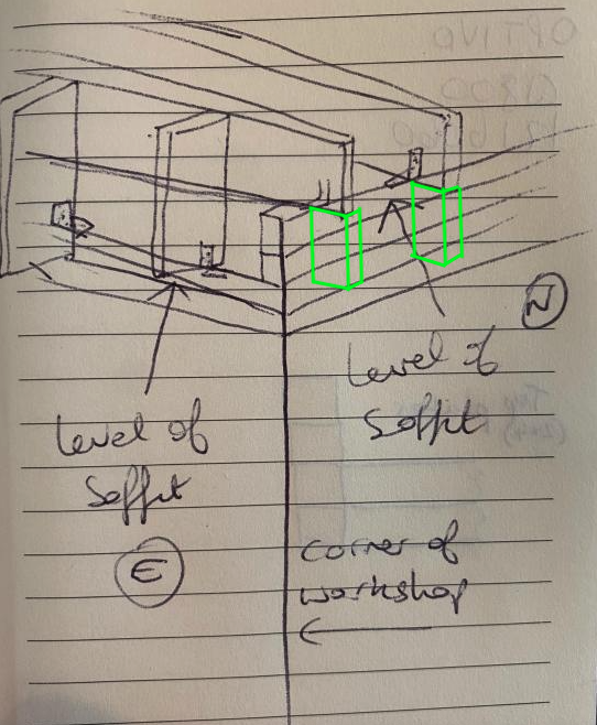

BotusBuild Posted October 15, 2021 Share Posted October 15, 2021 How about add pieces of wood below the rafters on the North side, the bottom of which come to the same level as the noggins on the E & W sides - see edited drawing. 1 Link to comment Share on other sites More sharing options...
Dave Jones Posted October 15, 2021 Share Posted October 15, 2021 3 minutes ago, BotusBuild said: How about add pieces of wood below the rafters on the North side, the bottom of which come to the same level as the noggins on the E & W sides - see edited drawing. yes this is probably easiest way nail to the side of the noggins to bring it down to all the same height. Link to comment Share on other sites More sharing options...

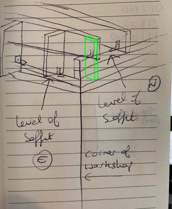

BotusBuild Posted October 15, 2021 Share Posted October 15, 2021 actually, make it easier to fix by attaching them to the side of the rafters like this 1 Link to comment Share on other sites More sharing options...
Omnibuswoman Posted October 15, 2021 Author Share Posted October 15, 2021 Thanks @BotusBuild that sounds like a very straightforward solution, and I'm feeling rather "doh!" for not having already thought of it!! Link to comment Share on other sites More sharing options...
