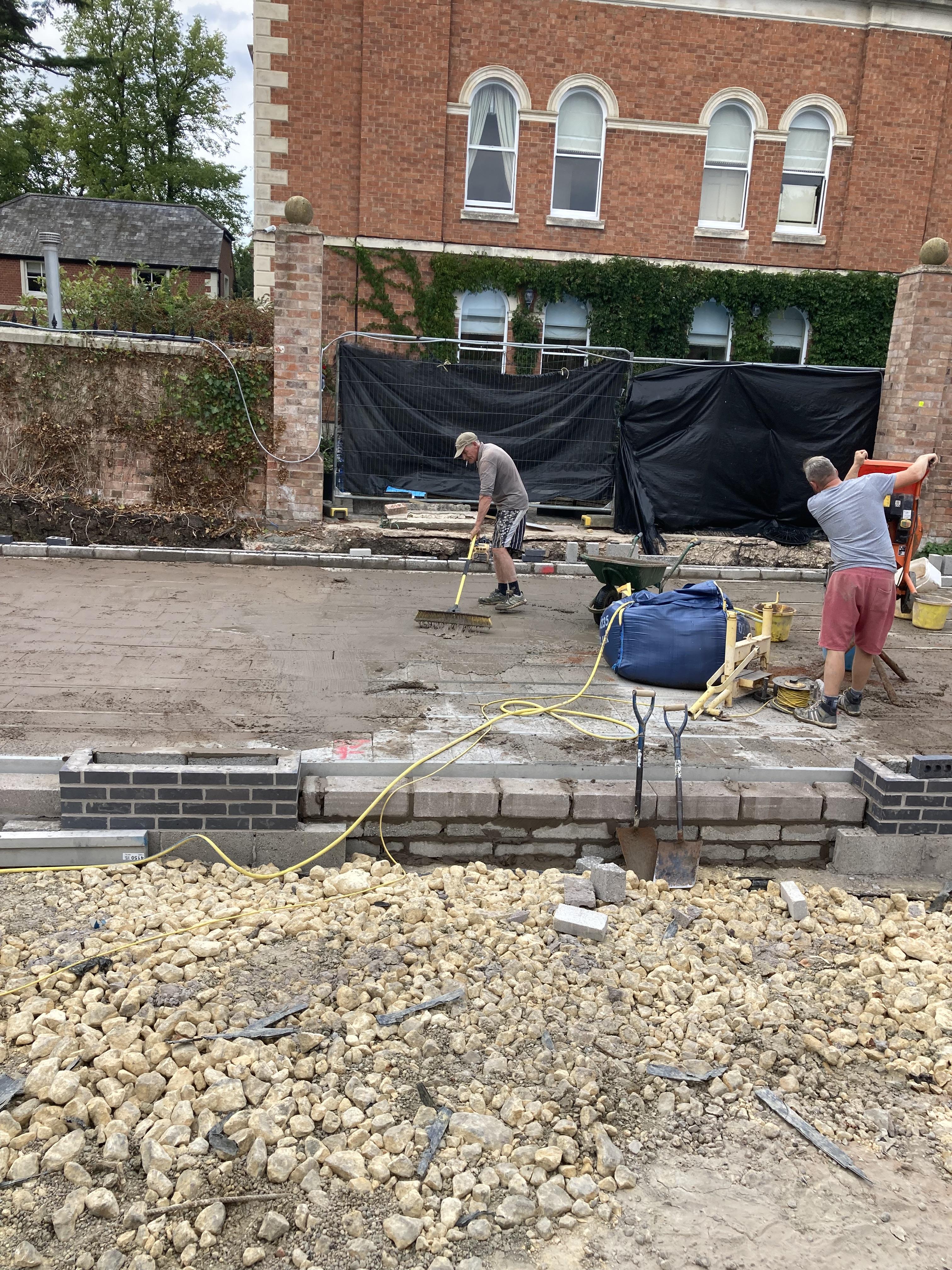

The one I did a couple of weeks ago was 163 m but many double beams to infill I think we used 3 bags of  gravel about 2 bags of sharp sand and about 30 bags of cement so for yours I'd say 1 - 2 bags of sharp sand and 6 - 9 bags of cement. It goes a lot further if you soak the floor first. The stuff is no use stuck to the top of the blocks. 2 of you should do it in a couple of hours. I'm doing a 66m2 one tomorrow so can let you know what we use if you like.
I already filled in my doubles, used a 1:3:6 mix with 10mm chippings, seemed to go well.
Yes please, let me know how you go.  And pics also would be helpful!  This self building lark sometimes throws up challenges with the simplest things! :D

Thanks for the pic!

No just mixed it very wet and brushed it in after wetting the floor. That one took 2 guys about an hour so it’s no big deal.

So I finally completed this today, with no drama.
We did spend 2 hours pulling the sawdust and some small rubble out of the joints, as they were full in some areas.  Then vacuumed the area, and then again with a narrow nozzle over the joints.  Filled 3 vacuum bags.
Used a mix of sharp sand and building sand, and probably somewhere between 3:1 and 4:1 with cement, and a little plasticiser.
First batch was too sloppy, no consistency at all - half of it is likely on the subfloor.  The rest went a lot better, got it to the consistency of loose muffin mixture, and then with a hard brushing it all went and filled the gaps.
Lessons:
- When you've wet the floor on an area, wet it again (Even when the ambient temperature is about 12 degrees).
- If it seems a bit too hard to go in, spray a bit of water on the grout to go in, and brush it a bit more.
- Going over it again with the broom about 20 minutes after filling seems to clear any excess from the top surface, but it is bloody hard work!
All together, it took 2 of us about 90 minutes to do 60 square metres.  I did all the mixing and wetting, and my dad did most of the sweeping.  Sweeping it everywhere took longer than I had imagined.
