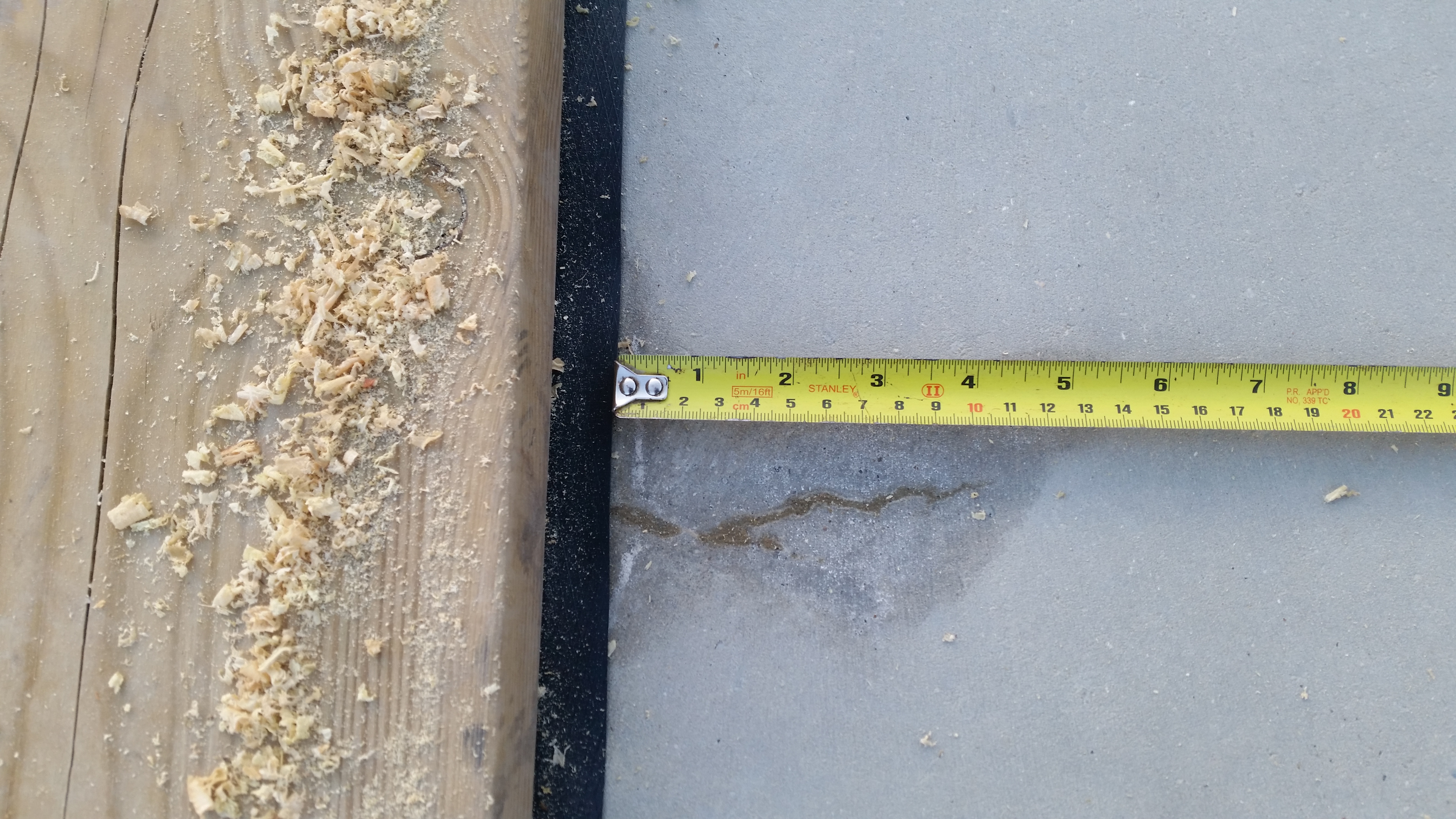

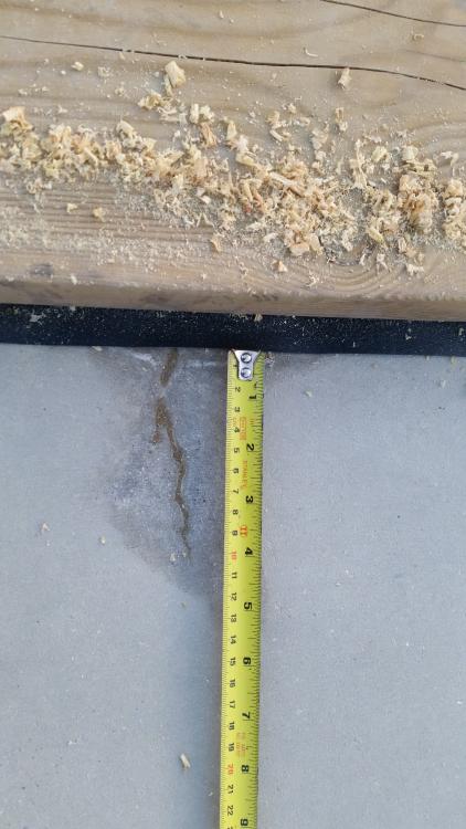

MikeSharp01 Posted April 3, 2017 Share Posted April 3, 2017 Arrived at site this morning to find some weird happenings on my slab, see attached, I have no idea what this is all about but they all start on the edge of the DPC strip under the sole plate and were surrounded by salt deposits until I swept them to see what was going on. If I lift the DPC is does not continue under it! Any ideas? Wonder if I should lift the sole plate and let the concrete cure some more. DPC was put down 10 days after pouring and slab was kept wet for first 5 days. Link to comment Share on other sites More sharing options...
Ian Posted April 3, 2017 Share Posted April 3, 2017 Unlikely that it's anything to worry about. It looks a bit unsightly but it looks from the photo as if it is simply some efflorescence coming to the surface of the concrete as it dries. explanation link: http://www.concreteconstruction.net/how-to/efflorescence-causes-and-solutions_o Ian Link to comment Share on other sites More sharing options...
MikeSharp01 Posted April 3, 2017 Author Share Posted April 3, 2017 Thanks @Ian great link, I will get some acid and see if I can sort it. Link to comment Share on other sites More sharing options...
Ian Posted April 3, 2017 Share Posted April 3, 2017 (edited) @MikeSharp01 I'd try brushing it off for a while and see how you get on. There's a good chance you won't need acid. It depends on how much time you have but if it's still happening when you are ready to apply floor finishes on top of the slab then it will need dealing with properly as adhesive etc won't stick to it. Edited April 3, 2017 by Ian Link to comment Share on other sites More sharing options...
MikeSharp01 Posted April 3, 2017 Author Share Posted April 3, 2017 Thanks again but this is supposed to be the finished surface there are no finishes. This is the garden room slab and has been designed to test the processes for the main house. I need to avoid problems with the main slab. Will keep brushing. Link to comment Share on other sites More sharing options...
Ian Posted April 3, 2017 Share Posted April 3, 2017 @MikeSharp01 it helps if you can get the slab covered by the roof and out of the rain as soon as possible after the concrete is poured. Often it's slabs that are exposed to a lot of wetting and drying which experience problems with efflorescence. Link to comment Share on other sites More sharing options...
MikeSharp01 Posted April 3, 2017 Author Share Posted April 3, 2017 Ah it was probably my fault as I could only wet it and cover it on a daily basis. So it was drying out. I will have to make a cover for the main slab and keep it misted. Link to comment Share on other sites More sharing options...
Ian Posted April 3, 2017 Share Posted April 3, 2017 (edited) 1 hour ago, MikeSharp01 said: Ah it was probably my fault as I could only wet it and cover it on a daily basis. So it was drying out. I will have to make a cover for the main slab and keep it misted. @MikeSharp01 it depends on the time of year that you pour the slab. Here in the U.K. you would not normally wet a slab like that by misting with water unless it was a very hot summer. I've never seen that done here in the UK (maybe it's advice from the USA?) Here in the U.K. normally they are shaded from direct sun and rain and if it's summer the usual method to slow down evaporation of water from the concrete and aid proper curing is to cover it with a layer of polythene as soon as you are able to after the slab is poured. Edited April 3, 2017 by Ian Link to comment Share on other sites More sharing options...

Dudda Posted April 4, 2017 Share Posted April 4, 2017 As it's localised and wetter I think it's extra moisture or rain running along the DPC and falling onto the slab at these areas. The additional extra moisture and efflorescence in that area of the slab compared to the rest would explain it and also explain why it doesn't run under the DPC. The key to stopping it would be to ensure that any moisture or rain that builds up on the DPC and flows along it like a gutter drains out and not into or on the slab. Link to comment Share on other sites More sharing options...
