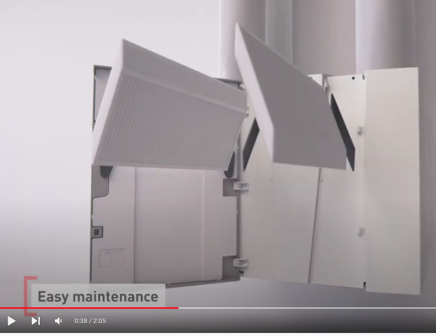

hendriQ Posted November 24, 2021 Share Posted November 24, 2021 On 07/10/2021 at 13:01, Nickfromwales said: I have been installing Brink Flair 325's and 400's via CVC Ventilation and am super happy, as are my clients who are now living with these systems and report near inaudible operation when on trickle. Boost still very much acceptable with mitigatory provision such as inline sound attenuators at the unit ( before the manifolds ) to further reduce any nuisance noise in the rooms. Very effective combination when combining a good unit with such additional measures. Nicholas Vaisey ( PH designer ) will happily look after you re designs / flow rates / specification etc, great service to date, and you could also inquire about the Brink Comfort units I am now routinely installing for 'cooling' as I've found them very cost effective (where an ASHP is being reversed for cooled water only ) to manage unwanted summer ambient uplift, but also to drip feed a tiny amount of 'heated' air into upstairs rooms where full on heating isn't justified. @Nickfromwales as you're familiar with these machines, I wonder if you would do me a MASSIVE favour and let me know what is the minimum space required in front of a flair brink 400 to change filters and service it? The filters sold on ventilation land are 510mm long so is it just that ones needs enough space to open the door and pull out the filter, as shown in the space image or are there other servicing that need to be done which would need more space than that 510mm depth in front of the machine? Link to comment Share on other sites More sharing options...

hendriQ Posted November 25, 2021 Share Posted November 25, 2021 46 minutes ago, Nickfromwales said: I’ll be working on one on Tuesday. If you can hang on I’ll measure it for the minimum requirements? That would be great, thank you! I have checked and I have enough space to remove the 510mm filter, but i pretty much don't have a mm more than that. Given the unit is 560mm deep in total, I'm just concerned that if a large part inside the unit ever needs to be removed for a service or replacement, I won't be able to. Presumably eventually the motor or heat exchanger needs servicing/replacing. Link to comment Share on other sites More sharing options...
Nickfromwales Posted November 25, 2021 Share Posted November 25, 2021 4 minutes ago, hendriQ said: That would be great, thank you! I have checked and I have enough space to remove the 510mm filter, but i pretty much don't have a mm more than that. Given the unit is 560mm deep in total, I'm just concerned that if a large part inside the unit ever needs to be removed for a service or replacement, I won't be able to. Presumably eventually the motor or heat exchanger needs servicing/replacing. I’ll get answers on all the above from my go-to guy at CVC Direct. Link to comment Share on other sites More sharing options...
Nickfromwales Posted November 25, 2021 Share Posted November 25, 2021 4 hours ago, hendriQ said: That would be great, thank you! I have checked and I have enough space to remove the 510mm filter, but i pretty much don't have a mm more than that. Given the unit is 560mm deep in total, I'm just concerned that if a large part inside the unit ever needs to be removed for a service or replacement, I won't be able to. Presumably eventually the motor or heat exchanger needs servicing/replacing. Ok, had a reply. 510mm for filter AND the heat exchanger is plenty. Fan is small so no issues with that. Door is 440mm projection when open. If you speak to Nick or Will at CVC and mention my username and the forum he will give you a discount off the Brink unit ( if you’ve not purchased already ). I organised the same thing for BH members wanting unvented cylinders and buffer tanks with Trevor at www.Cylinders2go.co.uk That offer still stands. “Every little helps” etc etc. ? Link to comment Share on other sites More sharing options...
hendriQ Posted November 25, 2021 Share Posted November 25, 2021 1 hour ago, Nickfromwales said: Ok, had a reply. 510mm for filter AND the heat exchanger is plenty. Fan is small so no issues with that. Door is 440mm projection when open. If you speak to Nick or Will at CVC and mention my username and the forum he will give you a discount off the Brink unit ( if you’ve not purchased already ). I organised the same thing for BH members wanting unvented cylinders and buffer tanks with Trevor at www.Cylinders2go.co.uk That offer still stands. “Every little helps” etc etc. ? That's very reassuring, thank you. It's amazing that you have a faster line of communication to CVC than I do, even though I'm a paying customer! Link to comment Share on other sites More sharing options...
