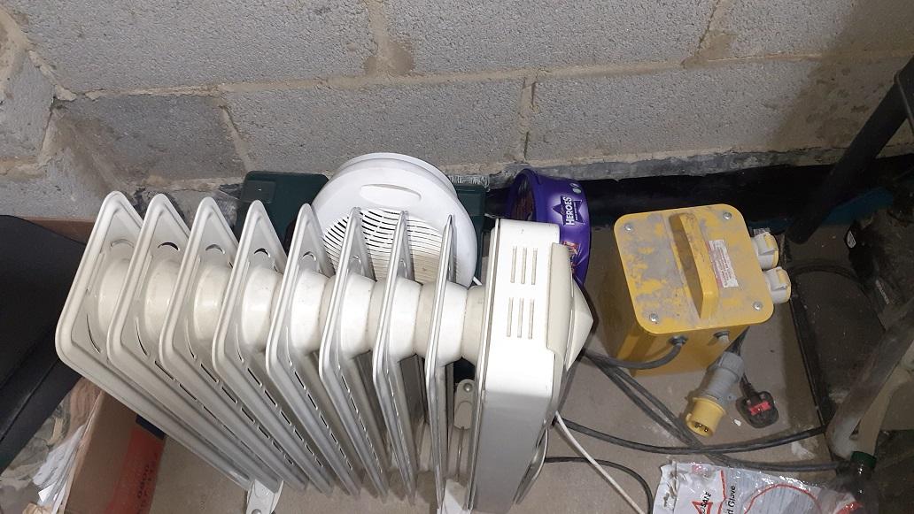

bikerchris Posted October 16, 2021 Author Share Posted October 16, 2021 On 11/10/2021 at 23:45, saveasteading said: can run on lower setting. i think 1/3, 2/3, 3/3. There is another kind we have that sits on the floor like an old electric fire, about £25, and again 3 settings. Sorry for my delay, work, like everyone else! Well, I did temporarily use a 2K fan heater the other day, when it got quite cold in there. My current bodge is to have 2 oil filled rad's, as I'm getting close to putting the external wall insulation on soon. I have one timed to come on at night, when the temp gets low enough (so far it hasn't turned on), and then another during the day that doesn't use the thermostat on the rad, but instead I've got a plug in thermostat/timer that only works during the day. So far so good, ish. I've plugged both into an energy monitor so I can keep an eye on usage. Link to comment Share on other sites More sharing options...
SteamyTea Posted October 16, 2021 Share Posted October 16, 2021 2 minutes ago, bikerchris said: So far so good, ish. I've plugged both into an energy monitor so I can keep an eye on usage. You can compare the usage between types. My guess is the fan heater will be the cheaper one to run. Link to comment Share on other sites More sharing options...
bikerchris Posted October 16, 2021 Author Share Posted October 16, 2021 1 minute ago, SteamyTea said: My guess is the fan heater will be the cheaper one to run. You are right I'm sure. It's just the noise of the thing that's really distracting. I could put it at the other end, but I've not got lecky over there yet. Link to comment Share on other sites More sharing options...

bikerchris Posted December 6, 2021 Author Share Posted December 6, 2021 Hi all, Just a little update, my current method is a bit odd - not sure it works. I use a combination of fan heater and oil filled radiator - I let the fan heater blow through the rad, in theory it'll push warm air around a bit quicker. Once the building has some heat stored, I switch off the fan heater and just leave the rad running for peace and quiet! On another subject, I've got all the external wall insulation on now, getting some for complete floor coverage this week hopefully (around 20% missing). There is a strip around the perimeter that isn't insulated (around 12cm high), but I've done 40% of that, just need to finish that awkward job. I'd really like to find a cheaper way to heat, but as you've all kindly said, cold days (0-5C) costs around £2 a day. So that perhaps around £400-600 a year, I wonder if I can get a combined solar / battery setup that would be around that? I could then save money by having it on a constant may be. Link to comment Share on other sites More sharing options...
SteamyTea Posted December 6, 2021 Share Posted December 6, 2021 4 minutes ago, bikerchris said: So that perhaps around £400-600 a year, I wonder if I can get a combined solar / battery setup that would be around that? I could then save money by having it on a constant may be. Won't an A2AHP he cheaper that 6 solar modules, an inverter/charge controller and battery, and then all the kit to work work it back to a resistance heater. https://www.appliancesdirect.co.uk/p/tf-12000ch/telefunken-tf12000ch-air-conditioner-air-conditioner 1 Link to comment Share on other sites More sharing options...
bikerchris Posted December 6, 2021 Author Share Posted December 6, 2021 1 hour ago, SteamyTea said: Won't an A2AHP he cheaper that 6 solar modules, an inverter/charge controller and battery, and then all the kit to work work it back to a resistance heater. That was the original plan, I know someone that'll do supply and install for £1k all inclusive. But I'm just concerned about noise levels as I live in a high density area (buildings within 10m of my building) and don't want to be yet another selfish resident. ? A friend in construction did say that because of my insulation and build up, it might require very little energy to heat/cool, so that could work in my favour (quieter). He showed me his, but it was a top of his container cabin/office, surrounded by trees and nothing else and it was quiet. But it doesn't compare to my situation where it'll be around 4 ft from the nearest close boarded fence, then it could reflect back against the building. Tricky. Link to comment Share on other sites More sharing options...

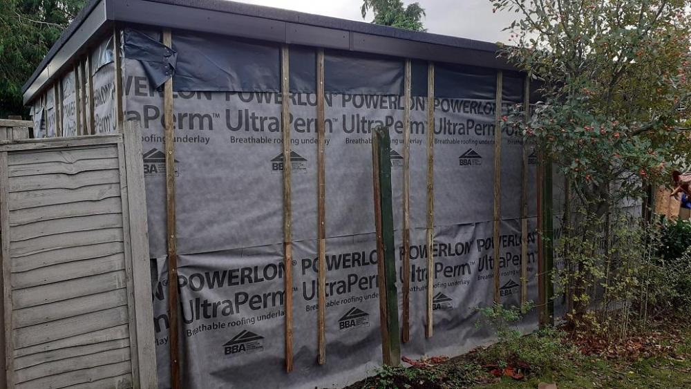

bikerchris Posted December 7, 2021 Author Share Posted December 7, 2021 (edited) 2 hours ago, Onoff said: Got a South facing wall? It's south facing during the Summer...house blocks it during the colder part of the year, I had wondered about it though. I'm going to read that article, as I drink plenty of cans (fizzy!). Cheers! Here's a very basic shadow calc - there's one tree in the way that's a neighbours (around 6m tall), but I'm cutting that down for them soon. The building isn't quite that shape, but it's correct enough. Edited December 7, 2021 by bikerchris Link to comment Share on other sites More sharing options...
