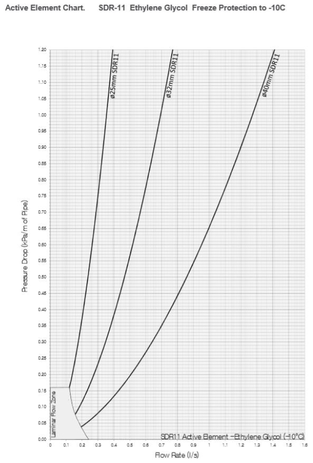

bungledlow Posted October 5, 2021 Share Posted October 5, 2021 This might be too technical for this forum but giving it a go anyway on the off chance there is someone here who understand fluid dynamics more than me! In designing a ground source heat pump system, specifically sizing the diameter of collector array pipe, the technical guidance is straightforward but quite grey in some areas. My understanding of the design process: Header pipes - Laminar flow is good as you don't want turbulence increasing heat transfer to the pipe wall Array pipes - Laminar flow is bad, lack or turbulence means low heat transfer to the pipe wall Whether your array is in laminar flow or not (and the pressure drop over it) is a function of the pressure drop per metre (itself a function of roughness and diameter) and flow rate: Pressure drop per metre of pipe is a constant for the pipe diameter you use Flow rate is a variable set by the heat pump chosen and is referred to as "minimum ground side flow rate". Put both of these numbers on each axis of the chart below and you get your pressure drop. (p23 of MCS Guidance Document - Hydraulics Design Guide for MIS 3005) More often than not its marginal or very close to being within the laminar flow zone in the bottom left. So by reducing the pipe diameter you can cause more turbulent flow but you also have to contend with the overall pressure drop and whether the pump can deal with that. The difficulty I have found is not the overall pressure drop but actually getting comfortably out of the laminar flow zone due to the low flow rates quoted by the pump manufacturers. Question: What does "minimum ground side flow rate" of the heat pump actually mean? In practice will the pump be running harder than this "minimum" because modern inverter pumps can vary their speed - is this just a theoretical worse case scenario for design purposes, meaning we are safe even if our numbers are marginal here? Decision: We have been advised that we should have bigger 40mm pipes, and there was some surprise from this advisor that some of the big names had specified smaller diameter (25-32mm) pipes. However when running the numbers, a smaller diameter would make more sense so that turbulent flow would be initiated at lower flow rates. The advantage to using larger pipes is that https://www.gogeothermal.co.uk/ offer a crack resistant pipe in 40mm that does not require sand bedding, reducing time and cost of install and improving performance due to direct contact with the surrounding clay soil. Appreciate any advice/interpretation anybody can offer. Link to comment Share on other sites More sharing options...

pdf27 Posted October 5, 2021 Share Posted October 5, 2021 1 hour ago, bungledlow said: What does "minimum ground side flow rate" of the heat pump actually mean? That's the minimum flow rate of coolant (glycol) passing through the heat pump. This will be set to ensure that in the worst case (lowest ground loop temperature + maximum heat demand) the coolant does not freeze up. 1 hour ago, bungledlow said: In practice will the pump be running harder than this "minimum" because modern inverter pumps can vary their speed - is this just a theoretical worse case scenario for design purposes, meaning we are safe even if our numbers are marginal here? Why would they run an inverter-driven pump on the ground loop side? To benefit from it you'd have to run a calibration routine for the ground loop and program it into the heat pump, and the savings would be trivial (tens of watts). Link to comment Share on other sites More sharing options...

pdf27 Posted October 5, 2021 Share Posted October 5, 2021 (edited) Oh yeah, and the proposed way of calculating pump flow is wrong too. What you should instead be doing is plotting the pump pressure versus flow curve (typically called a P-Q curve) on the same axis as the graph shown above. Your operating point is where the two curves intersect, and the flow rate at that point needs to be greater than the minimum ground-slide loop flow rate. Many pumps have more than one operating curve (essentially there is one curve for each speed setting) and this needs to be considered as well. Edited October 5, 2021 by pdf27 Forgot the graph! Link to comment Share on other sites More sharing options...
