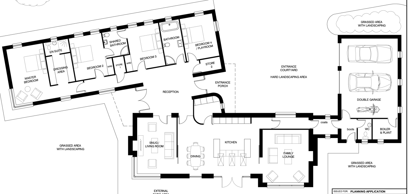

Ferdinand Posted May 30, 2016 Posted May 30, 2016 On 27/05/2016 at 13:21, vfrdave said: Are there any guidelines on where boilers should be situated in terms of longest run to radiator or UFH manifold. Likewise the same for a DHW tank and its proximity to bathrooms/en-suites etc as well as to its heating source. My bungalow is a non-traditional design and can only be described as a Z stretched left to right with one block being living and the other being sleeping. This is probably aimed at Nick but welcome to others to contribute as always. Floor attached hopefully helps Have to say I like the design - it is almost a bent variation of the old countryhouse sleeping wing / public wing / stable block thinking, and even has a bit of a monastic feel. Ferdinand 1

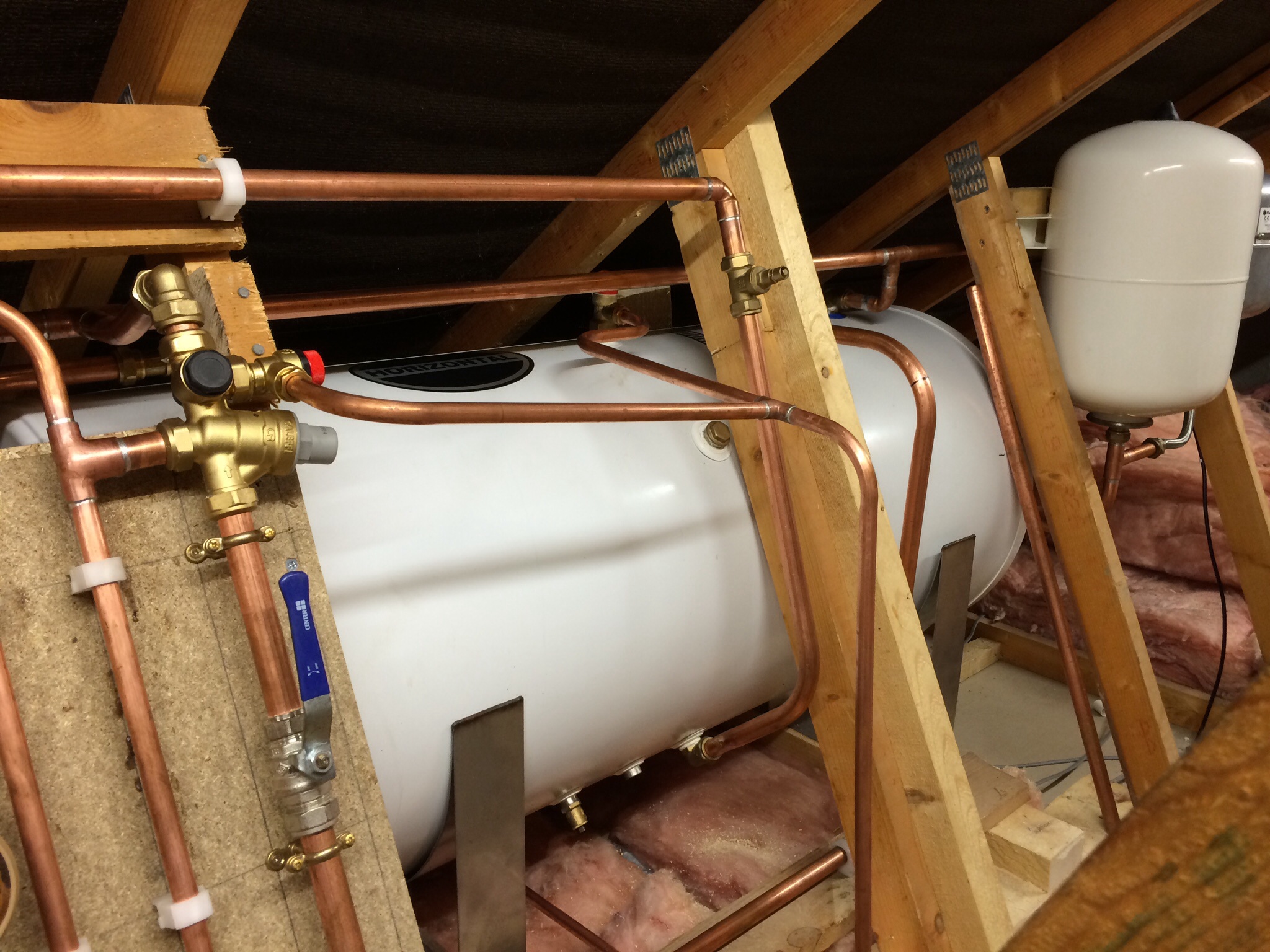

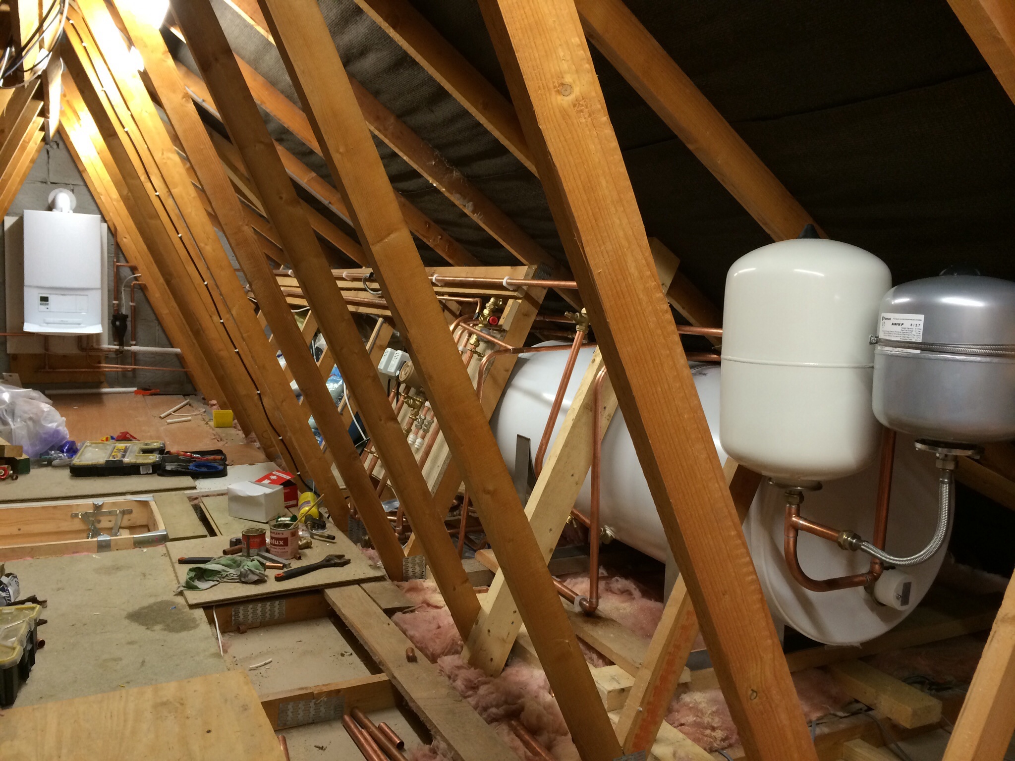

ProDave Posted May 30, 2016 Posted May 30, 2016 On 29 May 2016 at 17:44, Nickfromwales said: Plenty of room to go in the attic if you'd rather keep the cupboards for clothes / storage etc. That's the last horizontal UVC, but there's no HZ TS's How on earth did you get that in there? the only way I can see is slot it in when only half the roof trusses were on?
Stones Posted May 30, 2016 Posted May 30, 2016 If you look closely, there appears to be a cut in the truss below the nail plate. I'm guessing the length of 6 X 2 was bolted on to compensate. Nick?
Nickfromwales Posted May 30, 2016 Posted May 30, 2016 3 graded 4x2's on flat holding the stainless cradles. And yes, the upright was cut out entirely ( couple of inches short of the plates iirc ) and then the original piece fitted back in to fill the gap back up ( to stave off compression force) and a bigger timber screwed in to sister and reinforce. The idea is that the entire cylinder can be removed with a pair of adjustable spanners and a cordless drill in less than 30 mins. Work of art that one. The customer said it reminded him of a ship's boiler room . I did that so it didn't impede on the storage space in the attic, which I created by removing the original timber raft and multiple cold water storage tanks etc. I fitted 3 X 6' fluos and boarded the whole thing in weyroc plus cut out and oversized the original attic hatch to fit a Fakro ladder. Great pieces of kit. NOTE : Fyi if you put a boiler or cylinder up an attic and you ever require a manufacturer visit for inspection / repair / replacement etc then you MUST have a FIXED ladder, continuous and sufficient boarding of the floors to gain safe access and it must be lit. Anything less and they'll walk out the door. They WILL NOT go up a free standing step ladder.
ProDave Posted May 30, 2016 Posted May 30, 2016 In light of the other thread about drilling roof trusses, did you get a structural engineer or the joist manufacturer to approve you cutting out a section and replacing it? How much PL insurance do you have?
Nickfromwales Posted May 30, 2016 Posted May 30, 2016 I can tell you that I left that stronger than when I got there. I cut below the top plate and above the lower one in order to get the cylinder in. One timber got cut only. The new support timber was sistered over the original piece which I reinstated, and the additional support timber was thicker and wider that the truss section that I cut out btw. It was fixed above the top plate ( into the roof rafter ) and below the bottom plate ( into the ceiling joists ) so I'll sleep as soundly tonight as I did last night. PL a-plenty but not needed it in over a decade ( when I took the policy out first ). I have a strict rule, don't touch it unless you can make it the same, or better. I strive for the latter in everything I do. 1
