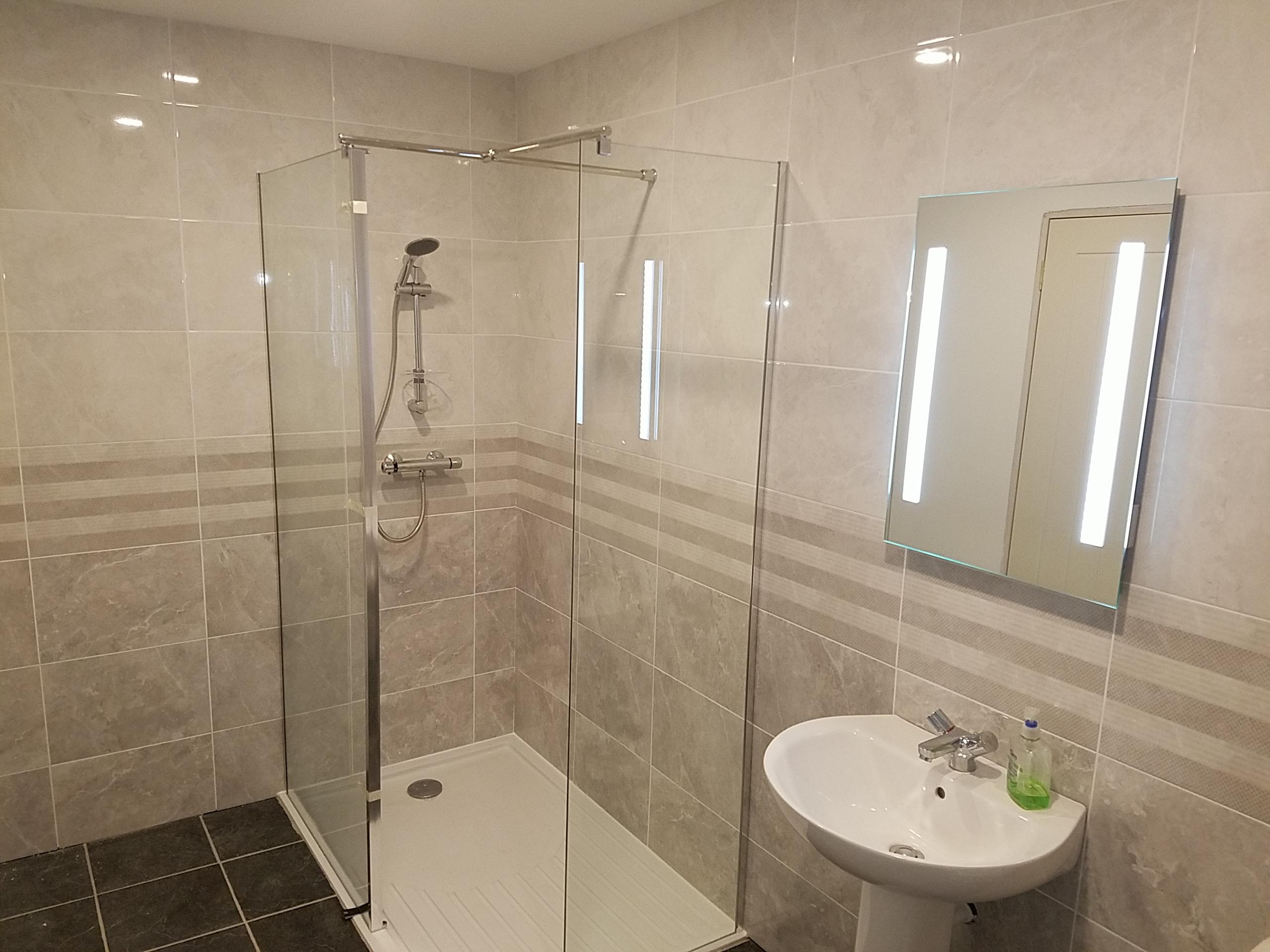

We are also trying to decide screens.
Using 900x1400 trays.
ideally we would have a single screen but I’m sure water is still going to get out.
Probably going to go with a flipper to deflect it as our bathroom does not lend its self well to the back screen
Not ideal aesthetically but just know the wife and son will make a mess!
example from today but with 800x1200 tray

Personally I like fully enclosed for cleaning. I can spray all the glass on ours with descaler then hose everything down with the shower head right to the edges.
