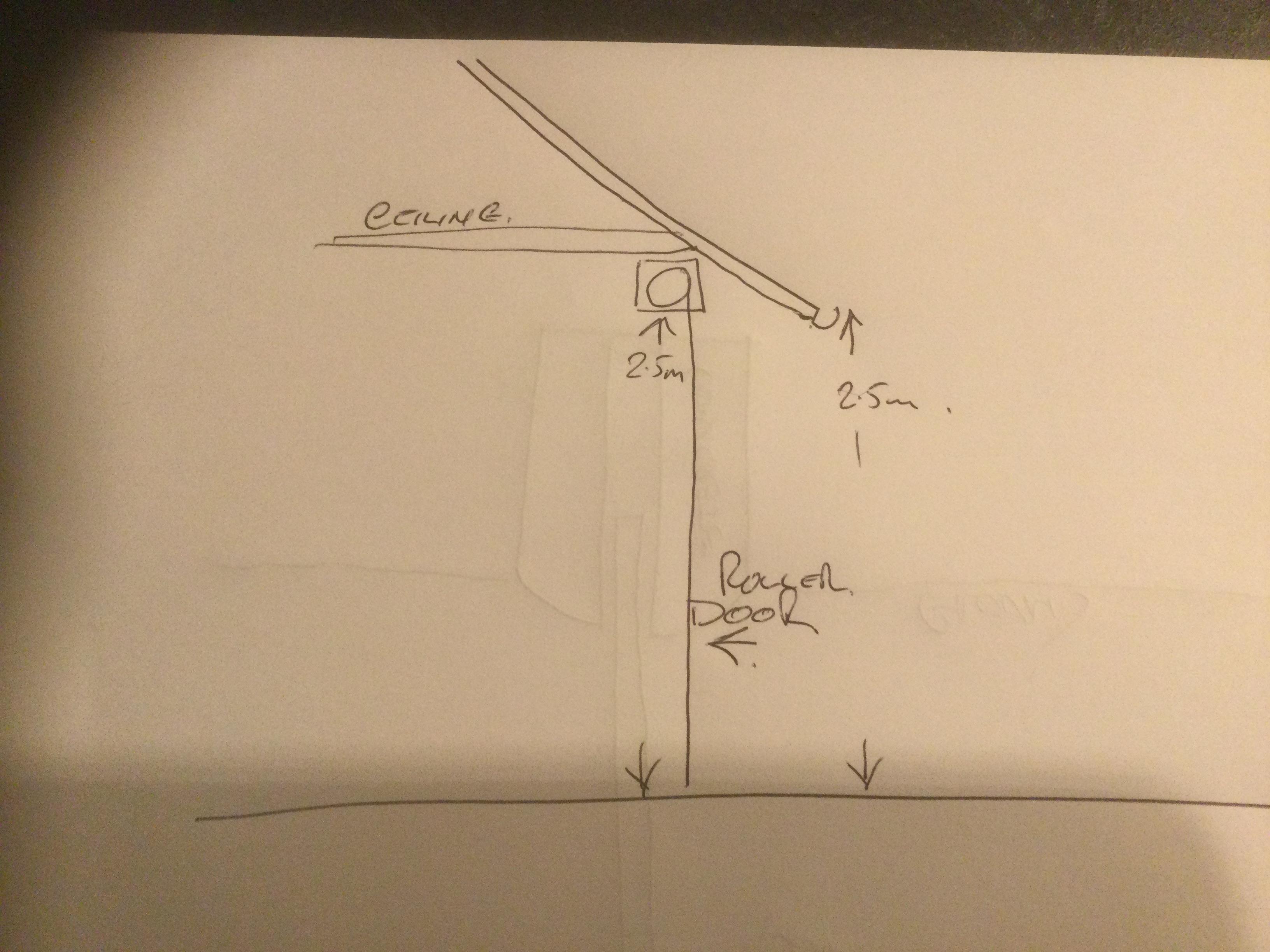

joe90 Posted October 3, 2021 Share Posted October 3, 2021 I managed to do this with my garage by having large overhanging eaves, gutter at 2.5m and ceiling 2.8m. Link to comment Share on other sites More sharing options...
oldkettle Posted October 3, 2021 Author Share Posted October 3, 2021 11 minutes ago, joe90 said: I managed to do this with my garage by having large overhanging eaves, gutter at 2.5m and ceiling 2.8m. Thank you Joe. What wall height did you need then? 3m+? As I understand it a lot depends also on where the insulation goes: between and below rafters probably requires less depth than a proper warm roof with insulation above. Does it also mean eaves are measured at the end of the roof, not above the wall? By the way, I've found this drawing as an illustration but obviously this is not for the purpose of PD. Link to comment Share on other sites More sharing options...
joe90 Posted October 3, 2021 Share Posted October 3, 2021 (edited) 12 minutes ago, oldkettle said: Does it also mean eaves are measured at the end of the roof, not above the wall? Correct, the gutter. I was limited to 2.5m for permitted development but wanted a tall door to get my van into the garage and give me a decent internal height as it was also used as a workshop. The roller door mechanism was about 350mm but still gave me 2.5m opening. I had no insulation as it was only a garage/workshop. The large overhang also meant driving rain stayed out of the garage when the door was open ?.my overhang was 500mm. Edited October 3, 2021 by joe90 1 Link to comment Share on other sites More sharing options...

joe90 Posted October 3, 2021 Share Posted October 3, 2021 (edited) Just found what I copied from the planning portal, no mention of measuring height at wall. Outbuildings and garages to be single storey with maximum eaves height of 2.5 metres and maximum overall height of four metres with a dual pitched roof or three metres for any other roof. Maximum height of 2.5 metres in the case of a building, enclosure or container within two metres of a boundary of the curtilage of the dwellinghouse. just found what you quoted above on the gov. Website ?. Oops. ?♂️ Edited October 3, 2021 by joe90 Link to comment Share on other sites More sharing options...

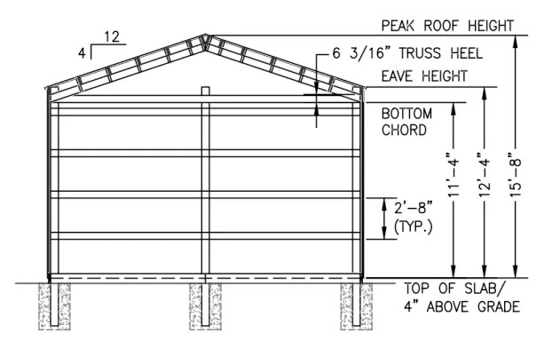

oldkettle Posted October 4, 2021 Author Share Posted October 4, 2021 9 hours ago, Gus Potter said: Hello Old Kettle. In the spirit of BH and.. the planners.. we are all well intentioned folk. Totally agree we all need to live next to one another. To work this out you need to start from the outside plane of the roof and work back. It's generally accepted that the eaves height for PD is this. Project a line from the outside face of the wall up to the top side of say the roof tiles or roofing felt. This is the eaves height. The folk that drafted this are not daft! The wicked may add a lean to log store onto the side of their building. Here they (the wicked) would argue that the footprint of the walls complies with PD but the eaves height is say the facia level of the log store. The result would be that you could have a pretty high structure right next to your neighbours. Not very fair as they could do the same to you! The next thing is that the eaves height is normally measured from the natural lowest point of the ground adjacent to the proposed walls. Thus, if you have sloping ground it's measured from the lowest point of the established natural gound level. This to is reasonably well drafted. You get some folk that will "build up their garden" by adding decking or planters and measure from there. For the "enthusiastic reader of the PD rules" better to take your chances at William Hill. The planners have seen it all and now with google and all the histroric photos? Now you can dig down as what we are considering here is the impact it will have on your neighbours. If you sit the floor say 1.0 m below the existing natural ground level then the height for PD is still taken as that from the natural gound level. With a bit of thought you can probably get what you desire. If you are digging into the slope then you need to put a bit of thought into the SE / Geotechniques design as you are into maybe retaining wall terratory / damp proofing, maybe party wall stuff if not in Scotland. It's all a bit back to front but once you get your outside envelope established then you can work back without having to reappraise. Old kettle hope this helps. Thank you Gus I am pretty sure that the height is measured from the highest natural point, not the lowest though, at least in England. I also have done soil test and involved SE for insulated raft design already. But my main question is different. I want to understand how high my eaves have to be for a specific ceiling height. Is there a way to say "for 2500 ceiling you will need at least 2750 walls and 2900 or 3200 eaves"? Again, we are talking about well insulated building, not a shed. Link to comment Share on other sites More sharing options...
joe90 Posted October 4, 2021 Share Posted October 4, 2021 4 minutes ago, oldkettle said: But my main question is different. I want to understand how high my eaves have to be for a specific ceiling height Despite my error with measuring eaves ?, decide on your ceiling height, add ceiling joist, rafter, tiles but you need to draw this up to get an accurate answer. However if you had skeilings I.e. ceiling joists not on wall plate but further up roofing joists you could get higher ceiling heights ?. Link to comment Share on other sites More sharing options...

oldkettle Posted October 4, 2021 Author Share Posted October 4, 2021 6 minutes ago, joe90 said: Despite my error with measuring eaves ?, decide on your ceiling height, add ceiling joist, rafter, tiles but you need to draw this up to get an accurate answer. However if you had skeilings I.e. ceiling joists not on wall plate but further up roofing joists you could get higher ceiling heights ?. Thanks Joe I look at roof trusses and they seem to sit on top of the wall plate which is good enough for me. Then yes, as you said, rafter, insulation, battens and tiles. I suspect 500mm should be enough to cover this. Link to comment Share on other sites More sharing options...
