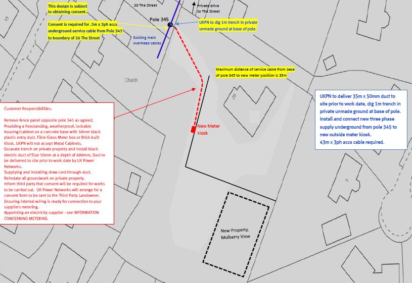

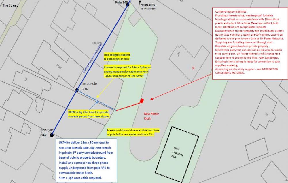

I have 2 poles I could connect to. Pole 346 is the first pic is in the back of a Church Hall. 20m of trenching is needed and legal complications mean I cannot dig it, UKPN must This factor adds a good chunk of money to any connection that uses that pole. However, this pole is a bit closer to the house. (the plan doesn't really properly represent where the box will go)
Pole 345 is only about 18" into the garden of a private homeowner, thus no expensive UKPN trenching. However, it is about 15m further from the property.
3ph from Pole 346 is £4300
3ph from Pole 345 is £2700
Firstly, should I go 1ph or 3ph? Secondly, which connection would be best from the viewpoint of performance/voltage drop and can I make up any weakness in the cable that goes from the boundary box to the house?
They have also offered a 'Mains extension', but I guess this will be fiercely expensive.

Re which pole, if the land owner with pole 345 gives consent without contest or conditions I would go for that, and even ask them if you (or your contractor) could dig the short bit of trench on their land as that would be cheaper then the DNO doing it.  There is little to choose between the options from a technical point.

So there's no real issue in the extra distance the cheaper pole is from the house?
