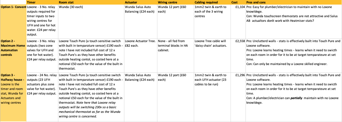

Hilldes Posted October 1, 2021 Share Posted October 1, 2021 Looking at options for controlling UFH (and DHW) when the house will have a home automation system (Loxone in my case). Options range from conventional UFH controls, where the HA systme is just a glorified timer to... making full use of availble HA controls. The UFH system has 12 circuits on ground floor and 11 circuits on first floor, all with Wunda premium manifoods and pump sets. There are 12 rooms that will need a room stat in each. Here is an analysis of some options... @jack, @joth, @Rob99 what have you done in your implementation(s)? Link to comment Share on other sites More sharing options...

IanR Posted October 1, 2021 Share Posted October 1, 2021 Do you have any other "systems" for heating, cooling, avoiding solar gain? For me it was an easier decision to have Loxone controlling the UFH as I also wanted to control the MVHR, roof vents and external blinds to ensure everything was working together to either heat, avoid heat or cool the house. Loxone decides whether the house is heating, cooling or taking passive measures using an average of all the temps from the Touch Pure light switches in each room AND comparing the temp of those rooms effected by solar gain with those that are not AND comparing the slab temp in those rooms effected by solar gain with those that are not. Loxone then decides whether to just circulate the UFH, without any heat/cool input in order to distribute solar gain, or to employ blinds and/or vents, or to heat/cool the buffer and distribute that heat/cool via UFH and MVHR. I have Loxone actuators on each loop of the UFH as well as relays to control the UFH pump, MVHR wet heat exchanger pump, DHW loop pump and a valve on the UFH splitter manifold that separates it from the buffer when it's just circulating the UFH to distribute solar gain. 1 Link to comment Share on other sites More sharing options...
Hilldes Posted October 1, 2021 Author Share Posted October 1, 2021 46 minutes ago, joth said: How well insulated is your house? Will you need zone based control? A very good question. SAP is 85 B, so quite well insulated. And MVHR I think moves air around the house so making zones less isolated. I hadn't thought of not having zones. So right now you control each floor manifold via a single stat? Link to comment Share on other sites More sharing options...

jack Posted October 1, 2021 Share Posted October 1, 2021 2 hours ago, Hilldes said: @jack, @joth, @Rob99 what have you done in your implementation(s)? Mine is extremely simple. We have 8 loops downstairs, all run as a single zone. No UFH upstairs. Temperatures from a handful of cheap 1-wire temperature sensors upstairs and downstairs are averaged within Loxone and used to call for heat from the ASHP via a relay. I decide when it's heating season and switch the ASHP mode accordingly. I could automate this, but I only have to do it a couple of times a year, so it's no real effort. I've read some reports about the Loxone control valves being unreliable. I think there was a tendency for something to break off internally. Worth a look at the Google Groups Loxone group for discussions about this if you're considering using them. I believe people may have used other types of port valve and controlled them with, eg, a PWM or 0-10V output. As for passive controls, we have external blinds. Again, I've kept it as simple as possible. They all come down automatically at dusk. Certain ones come up at 7 in the morning every morning, others only on weekdays, and yet others only at certain times of the year. For example, our east-facing kitchen blinds stay down in the morning during summer when we're concerned about solar gain. The blinds on the front of the house stay down but tilted slightly open all day in winter and summer. I'll occasionally manually open them fully if it's a sunny afternoon and I think the solar gain is worth it. I haven't actually programmed the system to automatically change behaviour over the seasons. I generally just nip into the Loxone config program at the change of seasons and manually change the programming. Takes about 3-5 mins twice a year. One day I'll get around to programming the relevant changes as a button on the interface (or, perish the thought, automate it completely), but I have other things ahead of this on my to-do list. Edited to add: MVHR is not currently controlled by Loxone. It's generally just left to its own devices. The only time I hit boost is if we're cooking something smokey like steaks. Link to comment Share on other sites More sharing options...

joth Posted October 1, 2021 Share Posted October 1, 2021 1 hour ago, jack said: Mine is extremely simple. We have 8 loops downstairs, all run as a single zone. No UFH upstairs. Temperatures from a handful of cheap 1-wire temperature sensors upstairs and downstairs are averaged within Loxone and used to call for heat from the ASHP via a relay. This is very much like my setup. One other thing I've found is that while I do use the Touch temperature sensors to control automatic shading in rooms with a tendency for overheating in summer, for the whole house temperature I've found it even better to use the MVHR "indoor temperature" sensor as the guide. This is effectively a ready made average of the entire house temperature so extremely simple to use to guide heating / cooling. Automatic roof window opening at night time, for stack cooling, is probably the single biggest utility of the entire loxone install, somewhat to my surprise as I only added it as an afterthought. It's incredibly effective, and again I use the MVHR "outdoor temperature" sensor as a very reliable guide as to when stack venting will be useful to enable. (the MVHR "bypass status" would also be a good signal for this, as it ensures that the mvhr and heating/cooling are not in danger of fighting each other) Link to comment Share on other sites More sharing options...

Rob99 Posted October 1, 2021 Share Posted October 1, 2021 (edited) I very much echo what a number of the others have said in that it's best to keep things simple. For my set up I have UFH downstairs and radiators upstairs. UFH has 8 zones. with 2 doubled up in larger rooms so 6 rooms/areas in total. My Loxone system controls the demand using the touch switch thermostats and then opens a zone valve for UFH or Rads as required using relays. The zone valves then trigger the boiler as would be the case in a normal heating set up. I essentially took the view that Loxone would replace the traditional time clock/programmer but with much greater control and configuration. I'm a Loxone partner so went with Loxone tree actuators on the manifold and AIR ones on the radiators as it made wiring simpler (ours was a refurb not a new build). @jack is right, there have been some issues with Loxone actuators failing with broken components internally. They have a 2 year warranty but it's a hassle to have to send them back for them to be assessed and then a replacement sent out. For clients now, I generally advise to go with a "standard" type heating set up and not use the Loxone actuators. It saves a huge amount of cost and, if you go with a heatmiser UFH control box (about £90 I think) then Loxone just has to trigger each zone demand and the heatmiser takes care of the valve opening and boiler firing. It means you can use readily available and cheaper 230V NC actuators. The advantage is that, apart form Loxone triggering the demand for heat, everything else is familiar to heating engineers/plumbers and electricians so simple to maintain in future. Hope that helps. Edited October 1, 2021 by Rob99 1 1 Link to comment Share on other sites More sharing options...

joth Posted October 1, 2021 Share Posted October 1, 2021 (edited) 3 hours ago, Hilldes said: Thanks, that is what I'm now thinking based on Joth's post. I guess though, as soon as a manifold serves more than one zone then each circuit/loop on that manifold will need an actuator? Yeah exactly. We have 9 UFH loops, so I have 9 salus autobalancing actuators sat in a box in case I can ever be bothered to install. I've modelled downstairs as 3 rooms with 3 Intelligent Room Controllers in loxone, but they all drive Call For Heat onto a single heating/cooling controller that drives relay for the downstairs zone call for heat on the ashp controller. Having 3 IRCs means I can have different cooling profiles for the areas under automatic rooflights, and also can set different target temps based on different schedules and occupancy per room. But that's just me tinkering in the loxone programmer because it's a bit addictive. From a systems point of view it's just one room stat calling for heat on one big ashp UFH zone. Edited October 1, 2021 by joth Link to comment Share on other sites More sharing options...

Hilldes Posted October 1, 2021 Author Share Posted October 1, 2021 4 hours ago, Rob99 said: I very much echo what a number of the others have said in that it's best to keep things simple. For my set up I have UFH downstairs and radiators upstairs. UFH has 8 zones. with 2 doubled up in larger rooms so 6 rooms/areas in total. My Loxone system controls the demand using the touch switch thermostats and then opens a zone valve for UFH or Rads as required using relays. The zone valves then trigger the boiler as would be the case in a normal heating set up. I essentially took the view that Loxone would replace the traditional time clock/programmer but with much greater control and configuration. I'm a Loxone partner so went with Loxone tree actuators on the manifold and AIR ones on the radiators as it made wiring simpler (ours was a refurb not a new build). @jack is right, there have been some issues with Loxone actuators failing with broken components internally. They have a 2 year warranty but it's a hassle to have to send them back for them to be assessed and then a replacement sent out. For clients now, I generally advise to go with a "standard" type heating set up and not use the Loxone actuators. It saves a huge amount of cost and, if you go with a heatmiser UFH control box (about £90 I think) then Loxone just has to trigger each zone demand and the heatmiser takes care of the valve opening and boiler firing. It means you can use readily available and cheaper 230V NC actuators. The advantage is that, apart form Loxone triggering the demand for heat, everything else is familiar to heating engineers/plumbers and electricians so simple to maintain in future. Hope that helps. Thanks @Rob99, that is great practical advice and much appreciated. I'll probably go down the route you suggest or even with no actuators initially as Joth has done (need to get the lighting scenes sorted first ?). I was not sure I could justify £1,900 on Loxone tree actuators. Link to comment Share on other sites More sharing options...
