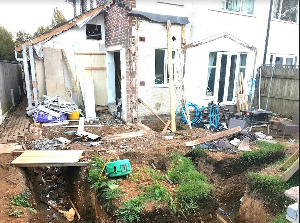

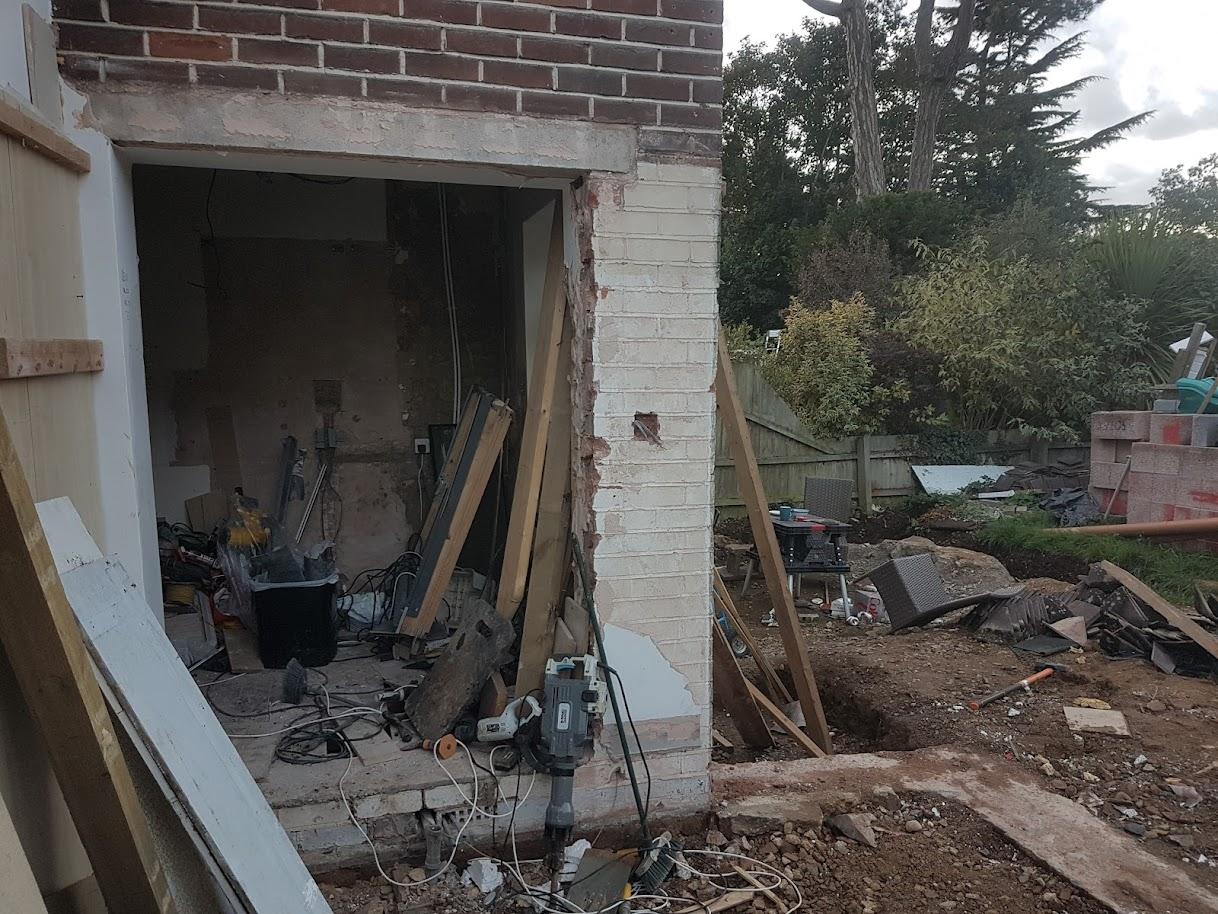

ianfish Posted September 29, 2021 Share Posted September 29, 2021 (edited) I have been carefully and steadily taking a 15 year old structure down that came close to our 1930's Metro style semi. The original kitchen house exterior corner wall will in time be removed being replaced with a 143mm steel column, rather than having heavier RSJs and the house "hanging" on the corner. This is for a bigger newer extension. Our SE has specified a new cast pad to support the column steel. What would people from here look at beginning this element of demo-underpinning? Your thoughts experience welcome Edited September 29, 2021 by ianfish add image Link to comment Share on other sites More sharing options...
saveasteading Posted September 29, 2021 Share Posted September 29, 2021 39 minutes ago, ianfish said: beginning this element of demo-underpinning? I don't really understand the question. Do you mean removing the brick corner and replacing with a steel column? Underpinning is horrible and expensive. Much easier to dig a hole from above. 1 Link to comment Share on other sites More sharing options...
ianfish Posted September 29, 2021 Author Share Posted September 29, 2021 Just now, saveasteading said: I don't really understand the question. Do you mean removing the brick corner and replacing with a steel column? Underpinning is horrible and expensive. Much easier to dig a hole from above. Its the sequence i'm after how would people tackle it. Yes the original corner is being removed in the final finish and a steel column with RSJ into the walls will be fitted, that bit I get. Its the need for the concrete pad and how to sequence its construction im after ideas for. Link to comment Share on other sites More sharing options...
saveasteading Posted September 29, 2021 Share Posted September 29, 2021 Prop the wall up on both sides. There are special fittings to go into the mortar beds/ Remove brick corner , dig hole and fill with concrete. Fix column, bed wall onto column. Remove props gently while holding breath. Move on to next area. Standard work for skilled builder. Scary for novice, and rightly so. What is above? another floor or a roof. Link to comment Share on other sites More sharing options...
ianfish Posted September 29, 2021 Author Share Posted September 29, 2021 (edited) 10 minutes ago, saveasteading said: Prop the wall up on both sides. There are special fittings to go into the mortar beds/ Remove brick corner , dig hole and fill with concrete. Fix column, bed wall onto column. Remove props gently while holding breath. Move on to next area. Standard work for skilled builder. Scary for novice, and rightly so. What is above? another floor or a roof. 1st floor.. Edited September 29, 2021 by ianfish add image Link to comment Share on other sites More sharing options...

Dave Jones Posted September 30, 2021 Share Posted September 30, 2021 it doesnt look that bad, acro the lintle in the door and a couple strongboy on the flank wall. I'd question why the steel in the first place and leave the corner as is, what is it going to be carrying ? 1 Link to comment Share on other sites More sharing options...
Marvin Posted September 30, 2021 Share Posted September 30, 2021 Pad foundation under a corner with a door opening to one side. I would want to have my method checked before commencing. How big does the structural engineer say the pad has to be? Link to comment Share on other sites More sharing options...
ianfish Posted September 30, 2021 Author Share Posted September 30, 2021 1 hour ago, Dave Jones said: I'd question why the steel in the first place and leave the corner as is, what is it going to be carrying ? We dont want a large or anything too square in what will be the middle of our new kitchen. I also didnt want to just have horizionfal rsj supports leaving the corner of the house just balanced. The column is part of the SE spec which is what id envisaged Link to comment Share on other sites More sharing options...
ianfish Posted September 30, 2021 Author Share Posted September 30, 2021 58 minutes ago, Marvin said: Pad foundation under a corner with a door opening to one side. I would want to have my method checked before commencing. How big does the structural engineer say the pad has to be? SE suggests a minimum of 1400 x 1400 by 500mm deep Link to comment Share on other sites More sharing options...

ianfish Posted July 10, 2022 Author Share Posted July 10, 2022 steels in...passed off by BC too Link to comment Share on other sites More sharing options...
