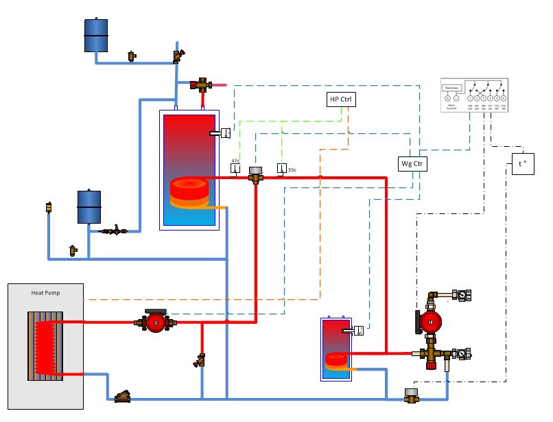

PeterW Posted March 31, 2017 Share Posted March 31, 2017 Right.. so following the post where I put the planned controls and layouts I have been thinking about the ASHP temperature control mechanism for this. You can see from the schematic there are two pipe stats that are directly linked to the ASHP control box. In the ASHP instructions, this is used to regulate the water temperature in the system, and as I want 2 different temperatures then I need 2 stats. The unit is supplied with a standard Siemens RAM1 pipe stat which seemed ok until I checked the differential - 8K +/-3K...!!! So at 37c set point, I could get a range of 32-42c which seems a bit excessive. I am trying to keep this as "off the shelf" as possible, and looking at specs its clear that 4K differential is the norm on these things unless you go upwards of £35 per device. I can get down to about 2.5K with one of these Computherm Capilliary Stat which seem pretty good. ( @JSHarris didn't you use Computherm..?) but I'm still querying if it is "good enough". The house isn't passive by any stretch but will have good air-tightness and a well insulated roof, with a January heat load of around 1180KwH. Overshooting the 35c stat will only result in the buffer being warmer than needed as the UFH will be set to 32c flow. I could go with something such as one of the many £8 DTC-100 based controllers from China and get myself 0.5C differential control on the water temperature but I do wonder how the ASHP will cope with this, and what the benefit will be as there is 9m of pipe between the ASHP and the sensors. I'm not going down the custom code / build route on this but I'm trying to build the best "analog" system that I can without spending a fortune but I'm left questioning how good do I need to go..?? Link to comment Share on other sites More sharing options...

PeterW Posted April 1, 2017 Author Share Posted April 1, 2017 7 hours ago, TerryE said: Chicken ;-? Yep...! Its more about supportability and maintainable components when it's not just me in a house. I've got a number of ducts in for DS18x sensors to monitor what the house is up to but I need to make sure that some of the components are easily replaced. It annoys me that some of standard components on items such as UVC Aquastats are of similar spec too as it means if I want to tighten up control of all of the tolerances I need to discard supplied components and move to more custom elements. I noticed ESI have brought out a digital aquastat now but the majority of UVC controls are still bimetallic stats that haven't changed in 40 years. Oh and it doesn't help when the other occupant likes to use the "off" switch on controls rather than letting the controls do thier job .... I'm thinking of putting it all in a locked Perspex box with just a small hole for a finger to press a button if extra hot water is needed .... Link to comment Share on other sites More sharing options...

Jeremy Harris Posted April 1, 2017 Share Posted April 1, 2017 Yes, I used Computherm room stats, one for heating, one for cooling. The ones I used had a 1 deg C hysteresis as standard, that was adjustable to 0.1 deg C by moving a link on the back. They were these ones: https://thermostats4u.co.uk/products/computherm-q3rf For the buffer tank stat I used a standard mechanical remote probe thermostat, a Drayton I think, that has around 5 deg C hysteresis. That seems to work well on the buffer, as it cuts out at 40 deg C and back in at about 35 deg C. Link to comment Share on other sites More sharing options...

Jeremy Harris Posted April 1, 2017 Share Posted April 1, 2017 The reason I decided that fine control was necessary has a great deal to do with the thermal response time of the whole house. I've found that putting even a couple of degrees more heat in, as a result of a high hysteresis room thermostat, means that the house room temperature overshoots, just from residual heat in the slab continuing to heat the house for several hours after the heating has turned off. Being able to shut the heating system off at precisely 20.5 deg C, means the room temperature only overshoots by less than 1 deg C, so stays below about 22 deg C during the overshoot period. Even in the coldest weather our heating only fires up once in the morning, and never comes on after mid-morning, as the residual heat in the slab just keeps heating the house until the next morning, a bit like a storage heater. The Computherm Q3RF room stat is about as simple as these things can get, with just a temperature setting and a small slide switch to select normal or set back temperature (both temperatures can be adjusted) . Link to comment Share on other sites More sharing options...

PeterW Posted April 1, 2017 Author Share Posted April 1, 2017 1 hour ago, TerryE said: Jan was asking me why I am proposing to use so many thermometers; did I need them all? My response is that I think that I actually only need three for the control, but that the rest are logging only to validate that the control is working effectively and in some sense near optimum. So this is my thought too @TerryE - my issue though its the 4 control thermometers have such wide range of hysteresis ! Link to comment Share on other sites More sharing options...

TerryE Posted April 1, 2017 Share Posted April 1, 2017 Jeremy what I didn't want to get into is trying to out and find OTS (off-the-shelf) control components, put them in and then find that I needed to rejig everything and by more bits. OK, I am also a software geek which helps. Hence my two phase approach: Gather lots of data. Have some basic on-off control output, and do the algos in SW until I've fully characterised the system and have confidence that it works as I anticipated. Once I know how my house behaves and how to control it, then do a second phase productionising / procurement of an OTS solution. To be honest, watching / tracking your learning curve was one of the reasons that I decided to go down this route. The main advantage of this split, IMO, is that (2) isn't time critical as the house will be running happily. I can take my time over finding the right kit for my needs. Link to comment Share on other sites More sharing options...

PeterW Posted April 1, 2017 Author Share Posted April 1, 2017 24 minutes ago, JSHarris said: The only problem I had was trying not to get sucked down into the sort of "continuing complexity vortex", just because it seemed like a fun thing to do. The exact reason I'm looking at alternatives ..! I am thinking that having a single control panel built of off the shelf DIN rail components and the DHT-100 units would be fine, but it would put a few people off I'm sure when it came to selling. The benefit from direct off the shelf components used "as designed" is that if something does fail then it's an easy replacement. For consistency I'm looking at using all computherm components though so I should be able to get some standardisation on a "known" temperature. Link to comment Share on other sites More sharing options...

PeterW Posted April 1, 2017 Author Share Posted April 1, 2017 Hmmm ..... by control component I mean the ones with moving parts that could wear. So I have : Pipe Stat 3ch Controller Room Stat Diverter Valve Zone Valve most of that lot has been "standard" for the past 15-20 years with the exception of the 3ch controller, and the speed that UK Heating Plc changes its technology I doubt they will much different in 5-10 years time. Link to comment Share on other sites More sharing options...
