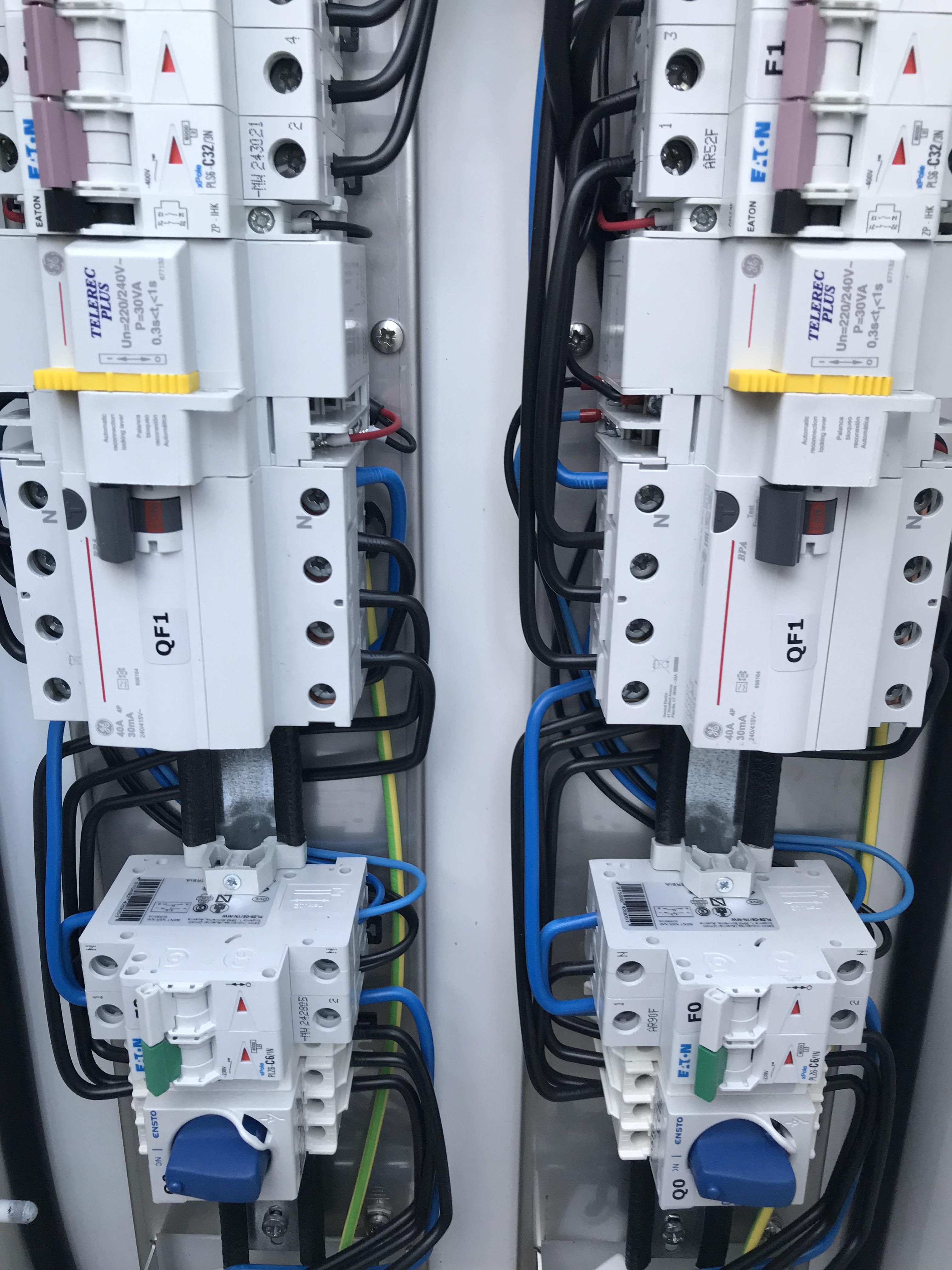

TonyT Posted September 23, 2021 Posted September 23, 2021 I will take a photo of one at work tomorrow if i remember!

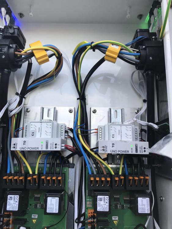

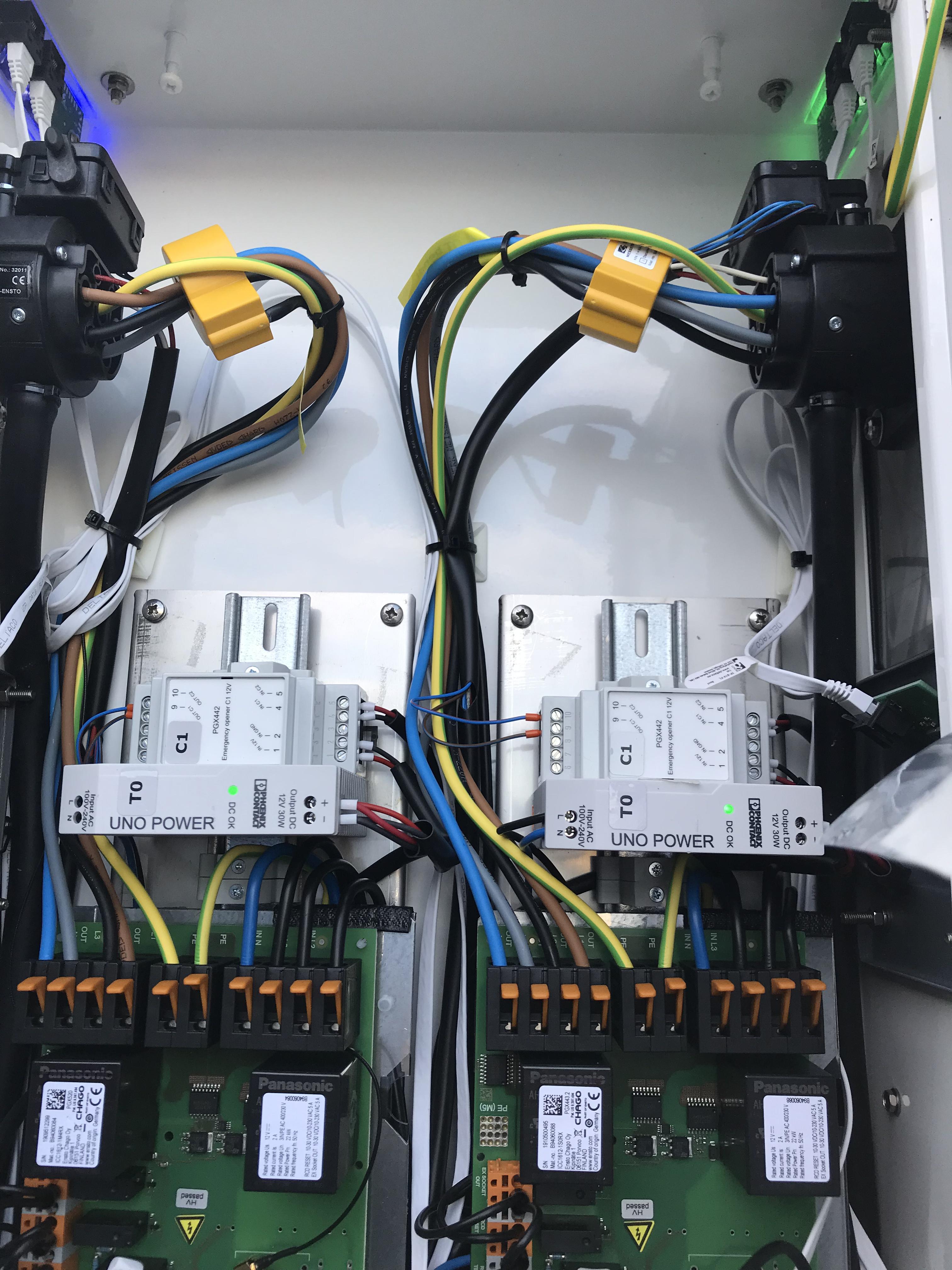

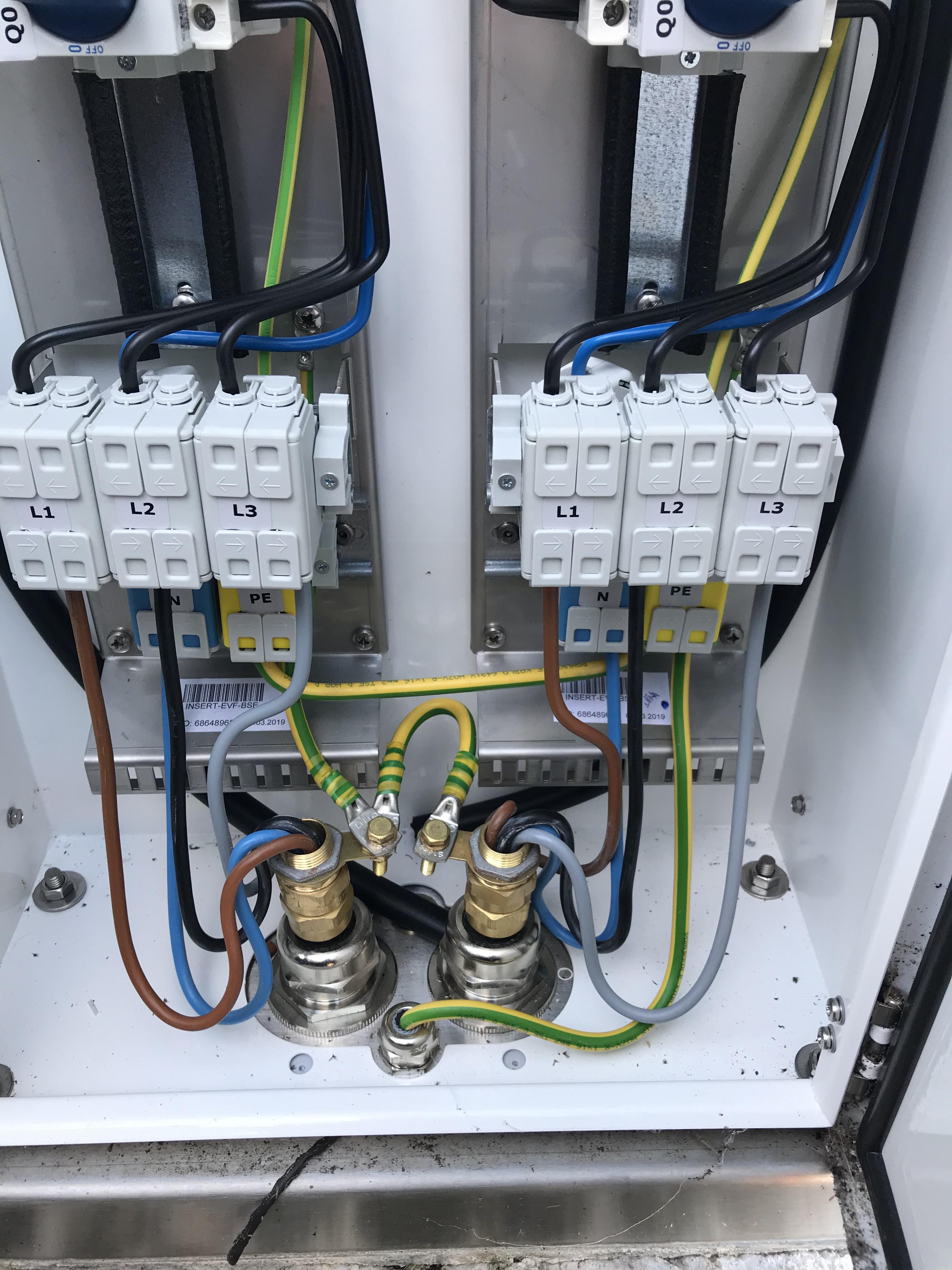

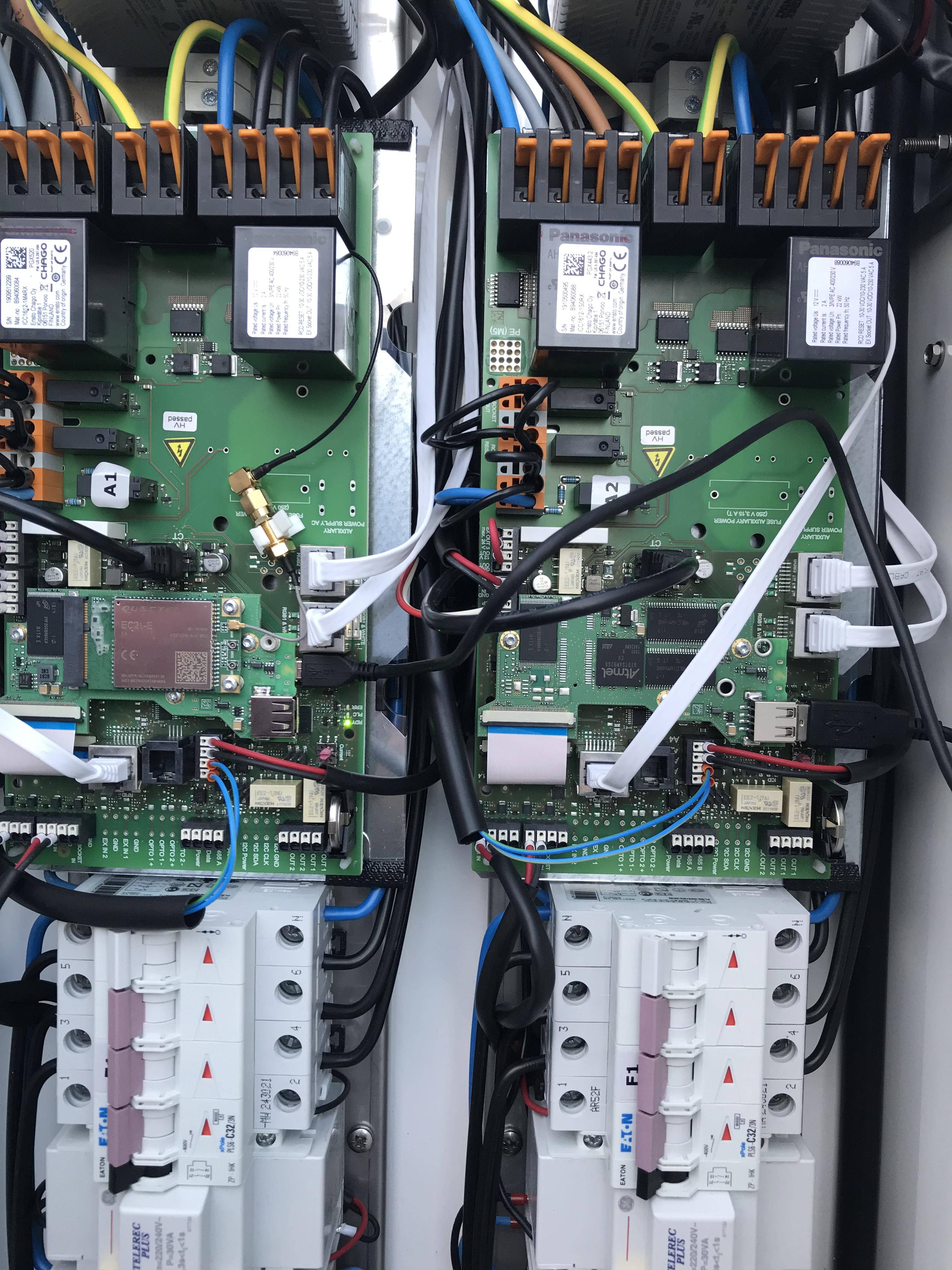

TonyT Posted September 24, 2021 Posted September 24, 2021 So that’s photos of my 3 phase 22 kw charger. first photo is power in via swa cable and top photo is the socket. 1
WWilts Posted September 24, 2021 Author Posted September 24, 2021 As a layperson with no knowledge, it looks as if 3 power supply cables are going into the innards. They are 3 different phases. Is it possible physically to replace those supply cables with others that are identical in all respects, except for being on the same phase?
