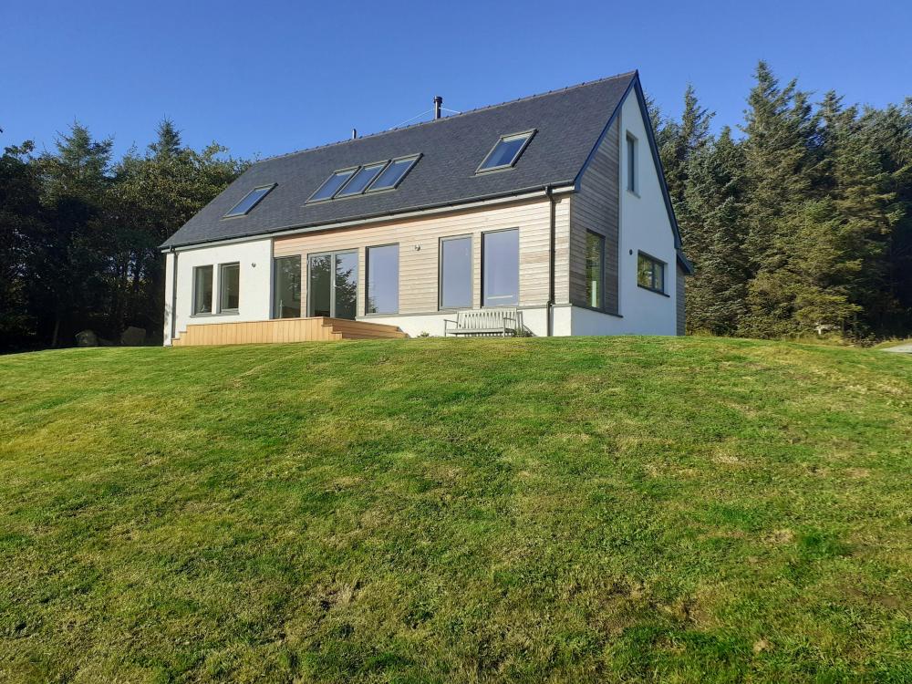

Thedreamer Posted September 22, 2021 Share Posted September 22, 2021 I used this https://www.roofgiant.com/pvc-continuous-dry-verge/uni-line-continuous-dry-verge-scot-strip-black/?gclid=Cj0KCQjwqKuKBhCxARIsACf4XuGBnu04VOTf774trrgsKJhhzt-3LnNEI99HxQankYismHs0pEypXtsaAm-7EALw_wcB You may be able to make it out on this photo, but it's blends in with the slates and is needed for us to stop wind blown rain going under the slate at the gable ends (we are in the Hebrides). It's been up about three years now and looks the same as the day it was installed. I went with thick heavies cupa slates and at some points the dry verge is holding three layers, therefore might be a squeeze but it worked for us. When the scaffold was up you could see wee bumps when next to it but when standing at the ground that is not visible. Link to comment Share on other sites More sharing options...
Dave Jones Posted September 22, 2021 Share Posted September 22, 2021 1 hour ago, Thedreamer said: I used this https://www.roofgiant.com/pvc-continuous-dry-verge/uni-line-continuous-dry-verge-scot-strip-black/?gclid=Cj0KCQjwqKuKBhCxARIsACf4XuGBnu04VOTf774trrgsKJhhzt-3LnNEI99HxQankYismHs0pEypXtsaAm-7EALw_wcB You may be able to make it out on this photo, but it's blends in with the slates and is needed for us to stop wind blown rain going under the slate at the gable ends (we are in the Hebrides). It's been up about three years now and looks the same as the day it was installed. I went with thick heavies cupa slates and at some points the dry verge is holding three layers, therefore might be a squeeze but it worked for us. When the scaffold was up you could see wee bumps when next to it but when standing at the ground that is not visible. lovely that. klober do a similar one 1 Link to comment Share on other sites More sharing options...
