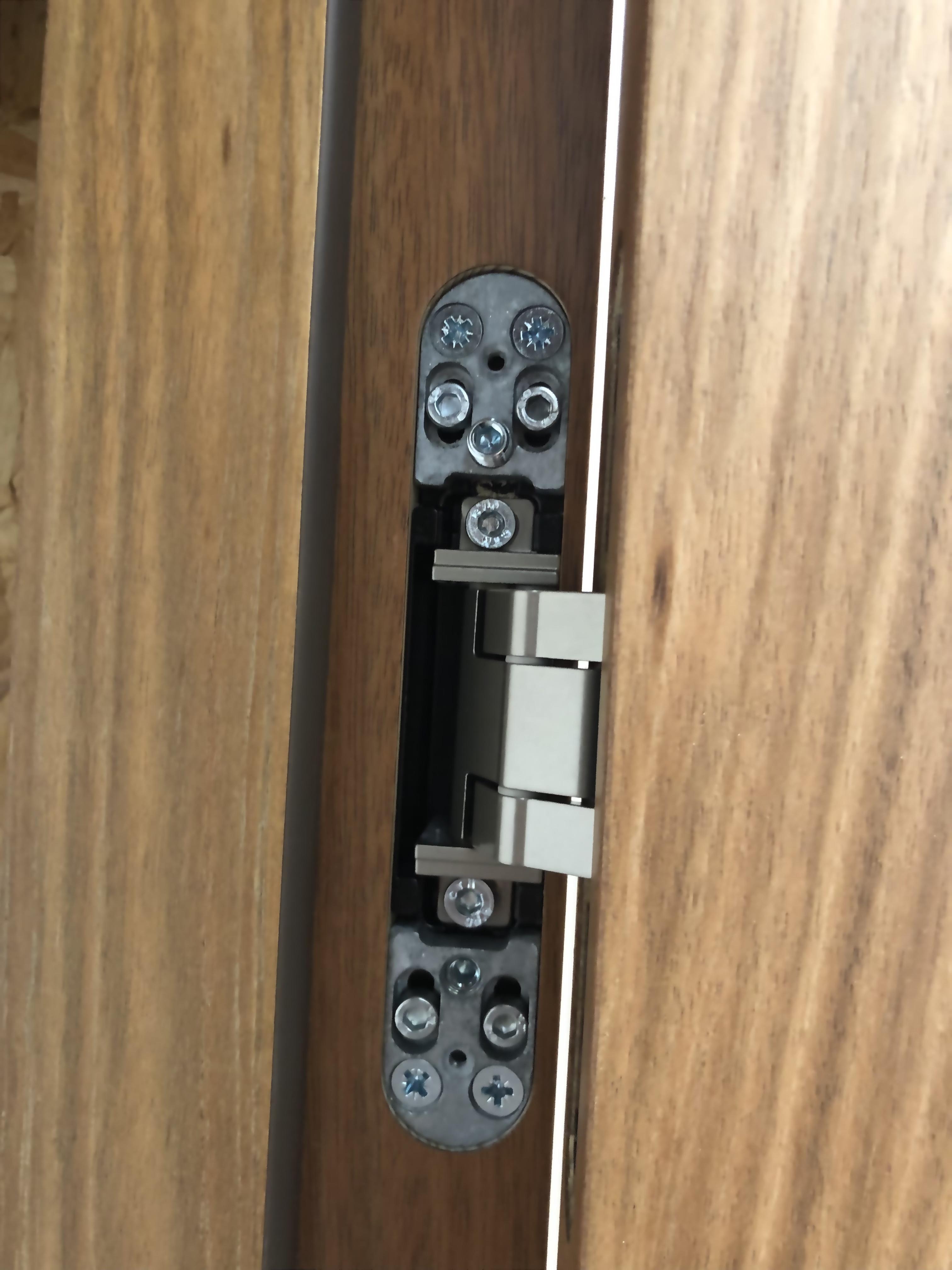

Pocster Posted September 14, 2021 Posted September 14, 2021 Struggling with this hinge . Want to simply raise the door a few mm . But just can’t get it to do it . Loosen everything as it states , put air bag under door …. Ends up lifting the door frame !! . Don’t get it ?
saveasteading Posted September 14, 2021 Posted September 14, 2021 Have you tried the four sprung door technique? 1 1
ProDave Posted September 14, 2021 Posted September 14, 2021 You are not supposed to jack the door up with an air bag. Loosen the screws shown then turn (3) to raise / lower the door. Remember to loosen the screws on ALL the hinges and adjust (3) on all the hinges the same amount. 1
saveasteading Posted September 14, 2021 Posted September 14, 2021 (edited) It says to adjust using screw 3. seems a lot of work for one screw, but the air bags will lift the whole assembly. Then you may have your Turflugel properly in passende Position. Edited September 14, 2021 by saveasteading irrtung mit screw nummer
Pocster Posted September 14, 2021 Author Posted September 14, 2021 (edited) 1 hour ago, ProDave said: You are not supposed to jack the door up with an air bag. Loosen the screws shown then turn (3) to raise / lower the door. Remember to loosen the screws on ALL the hinges and adjust (3) on all the hinges the same amount. Ok . Did try without an airbag . But of course will try again . Been a long day and perhaps I was too tired and not thinking straight . Feel a bit sapped lately as I plough on trying to get us moved in by the end of the month …. ??? ? Edited September 14, 2021 by pocster
Mr Punter Posted September 14, 2021 Posted September 14, 2021 Unscrew one from the door side then try.
Temp Posted September 14, 2021 Posted September 14, 2021 (edited) I reckon just loosen just the 4 hex with slots and try again. Might be stuck, give door bit of a shake. Will need to loosen all the hinges at same time if that's not obvious. Edited September 14, 2021 by Temp 1

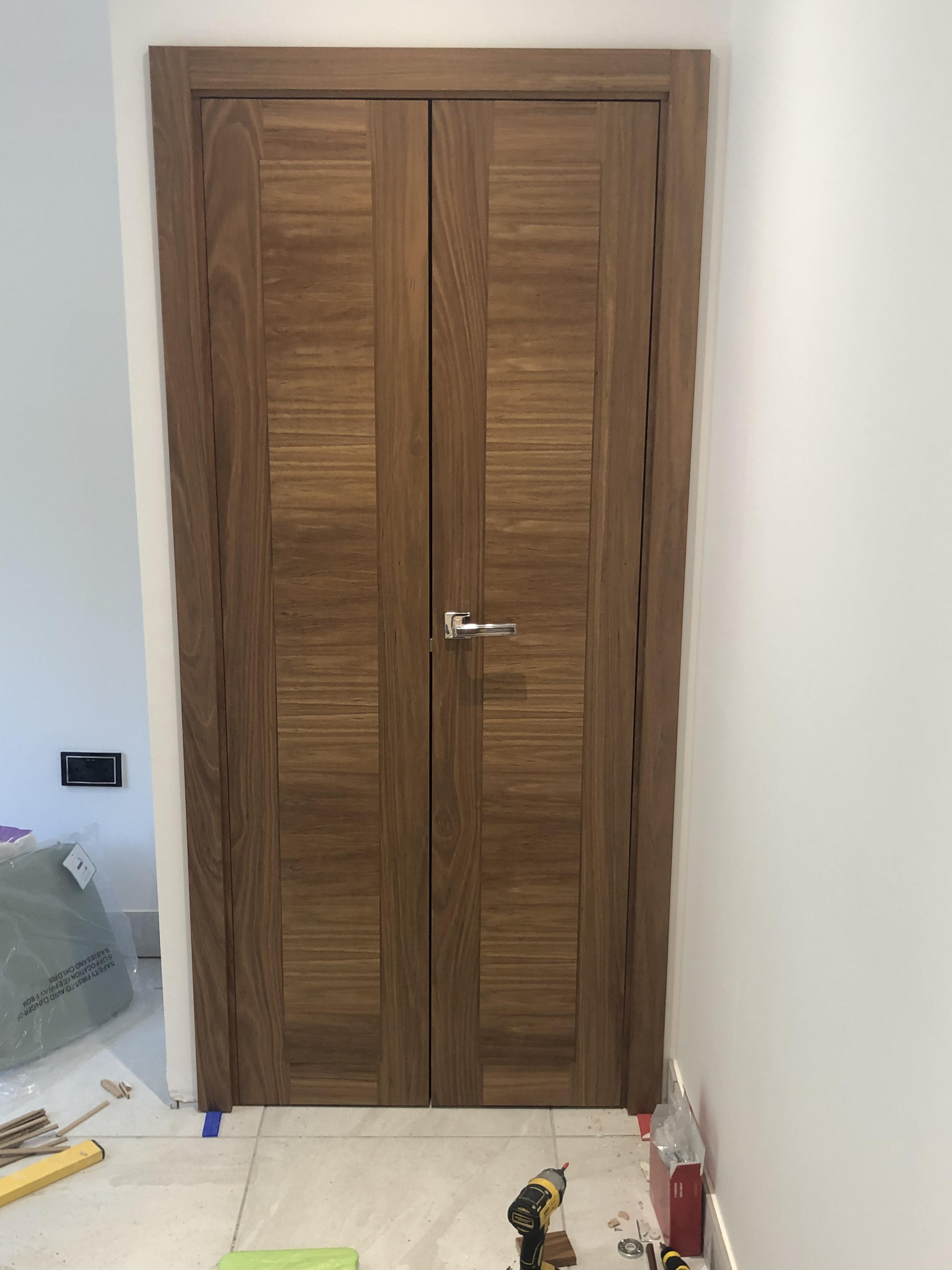

Pocster Posted September 16, 2021 Author Posted September 16, 2021 Pre hung doors look great ! . Still a lot of work . How many hours can I spend trying to get the doors aligned to near perfect . Not quite there and yes handle not straight …

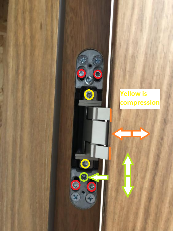

craig Posted October 6, 2021 Posted October 6, 2021 (edited) Did you ever resolve this @pocster? It's not as straight forward as some might think but it's not difficult either tbh. You just need to know what you are looking at. The four red are effectively hinge securing screws, you can loosen these to increase/decrease height, then adjust the greeen circle for the height increase/decrease requirement. Tighten the red again. Yellow are compression against the frame, you can increase/decrease this without having to loosen the hinge. The Orange is left / right movement but is actually on the door side of the hinge. If you look closely, you should see the arrows on the hinge (repeat steps for height adjustment). Edited October 6, 2021 by craig 1
Pocster Posted October 6, 2021 Author Posted October 6, 2021 (edited) 1 hour ago, craig said: Did you ever resolve this @pocster? It's not as straight forward as some might think but it's not difficult either tbh. You just need to know what you are looking at. The four red are effectively hinge securing screws, you can loosen these to increase/decrease height, then adjust the greeen circle for the height increase/decrease requirement. Tighten the red again. Yellow are compression against the frame, you can increase/decrease this without having to loosen the hinge. The Orange is left / right movement but is actually on the door side of the hinge. If you look closely, you should see the arrows on the hinge (repeat steps for height adjustment). After playing around I did pretty much get all my doors near perfect . It sounds a simplistic task but it took me a few hours on some doors just altering one component a fraction which might fix one issue but may cause another . Another pita was the magnetic catch . To get that just right so it’s doesn’t flick out to early but equally not to late . Hours of frustrated fun ? Edited October 6, 2021 by pocster
Pocster Posted October 6, 2021 Author Posted October 6, 2021 I do recommend these pre hung doors . Not cheap - but finish is great
