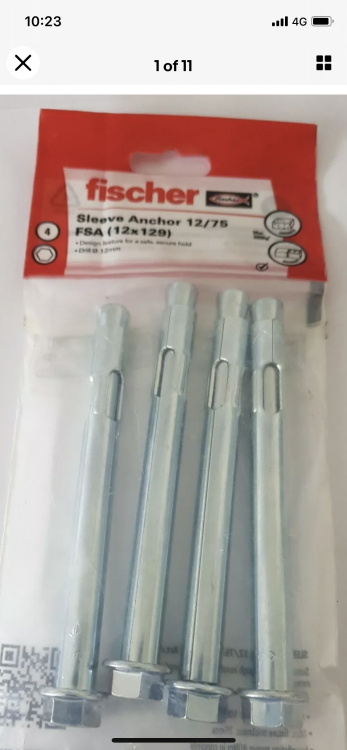

markc Posted September 13, 2021 Share Posted September 13, 2021 (edited) 17 minutes ago, pocster said: Ok Not used resin ones before ? Recommendations ? . Can I have bolts that are resin and anchor ?? If you want a bolt head then you are into sleeve anchors. place piece, drill hole same diameter as the sleeve, puff dust out, back bolt out as far as is practice, insert into hole and tighten. https://www.screwfix.com/p/fischer-fsa-sleeve-anchors-silver-12-x-81mm-m10-20-pack/68793 Edited September 13, 2021 by markc 1 Link to comment Share on other sites More sharing options...
markc Posted September 13, 2021 Share Posted September 13, 2021 Or you could use masonry screws. They work well and have bolt head Link to comment Share on other sites More sharing options...
Pocster Posted September 13, 2021 Author Share Posted September 13, 2021 3 minutes ago, markc said: If you want a bolt head then you are into sleeve anchors. place piece, drill hole same diameter as the sleeve, puff dust out, back bolt out as far as is practice, insert into hole and tighten. https://www.screwfix.com/p/fischer-fsa-sleeve-anchors-silver-12-x-81mm-m10-20-pack/68793 More comfortable with those . The stringers heavy and awkward . So want to place it - drill holes without moving it away I.e drill in situ . Assume this is ok still ? Link to comment Share on other sites More sharing options...
markc Posted September 13, 2021 Share Posted September 13, 2021 Just now, pocster said: More comfortable with those . The stringers heavy and awkward . So want to place it - drill holes without moving it away I.e drill in situ . Assume this is ok still ? Yes, that anchor will work well and bolt head is neat 1 Link to comment Share on other sites More sharing options...

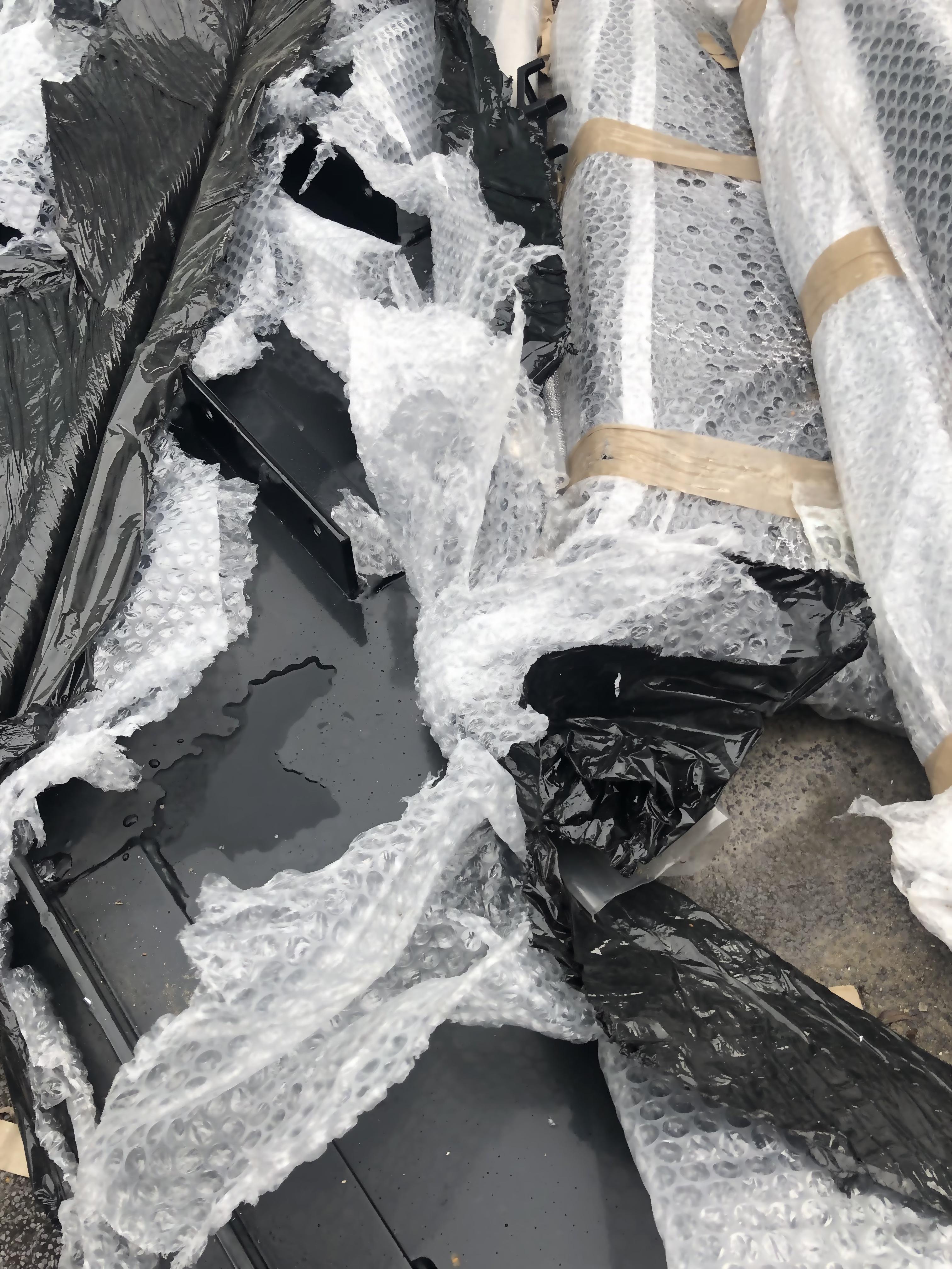

Pocster Posted September 13, 2021 Author Share Posted September 13, 2021 (edited) What is surprising is the lack of fixing holes along the stringer . Though not fully unpacked I can see just 2 at the top . Nothing along it , then 2 for the base plate to the floor . Would of been happier with a few holes along the stringer ? Especially as when I pick it up it bends …. Edited September 13, 2021 by pocster Link to comment Share on other sites More sharing options...
markc Posted September 13, 2021 Share Posted September 13, 2021 It’s amazing how floppy steel stairs are until they are fully bolted up. 1 Link to comment Share on other sites More sharing options...
joe90 Posted September 13, 2021 Share Posted September 13, 2021 Drill more holes if you want but there is not much load on it as it’s resting on the floor at the base and wall at the top and will be stiffer once all bolted up. ? (I prefer resin bolts, stainless threaded rod from screwfix cut to length, nuts, washers, resin) but as said above the hole must be dust free or the resin won’t grip the concrete. 1 Link to comment Share on other sites More sharing options...
Pocster Posted September 13, 2021 Author Share Posted September 13, 2021 9 minutes ago, markc said: It’s amazing how floppy steel stairs are until they are fully bolted up. I assumed it would be ridged like a steel lintel . Bends like a boy ! . Hope it doesn’t snap ? The wall lip fixing has to go up first . For reason unknown it doesn’t support the stringer . That would of been really helpful ! But I’ll use some acro’s to position the stringer as I have to lower it into the pit . My internal doors have just turned up - so I can avoid this task for now ? Link to comment Share on other sites More sharing options...

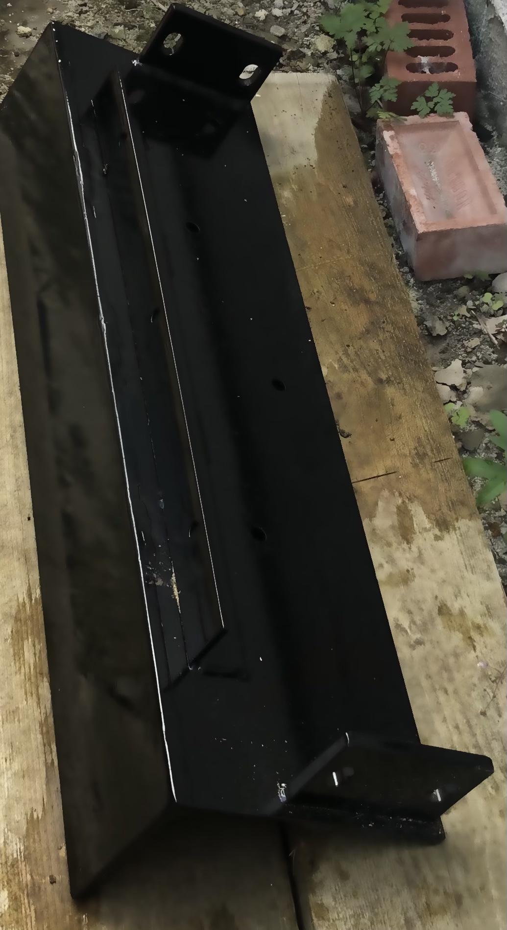

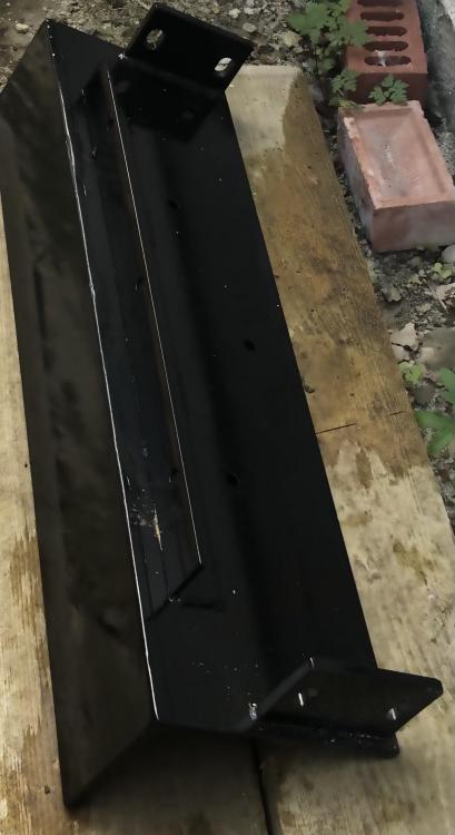

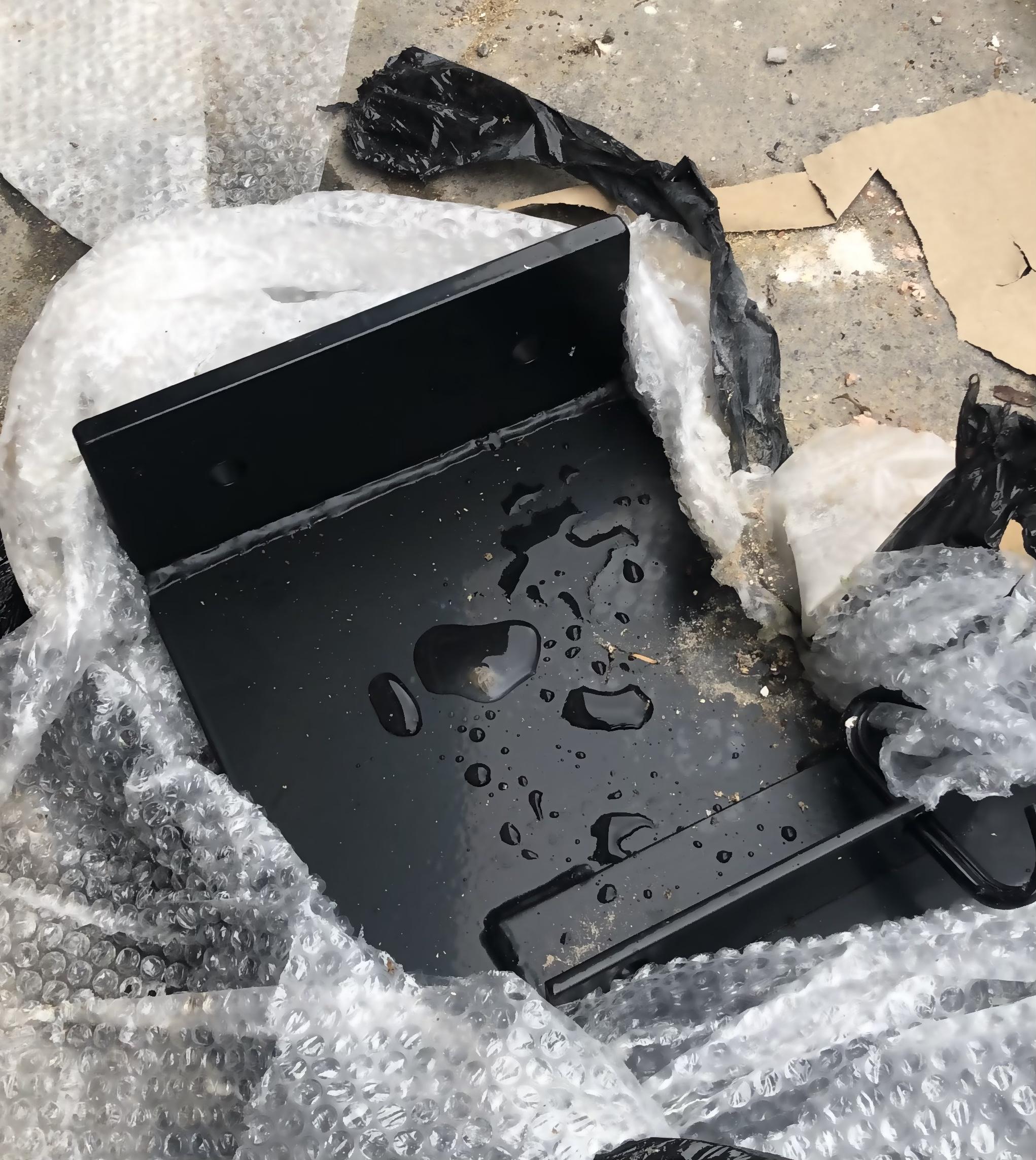

Onoff Posted September 14, 2021 Share Posted September 14, 2021 18 hours ago, pocster said: Doesn't the above "hook" over the concrete lip at the top? Are there any holes so you can fix in place? The stringer tops then connect to those slots don't they? What's the finish? If powder coat over plain steel without the steel being zinc flame sprayed or galvanised then that's not the best finish for longevity. Link to comment Share on other sites More sharing options...
markc Posted September 14, 2021 Share Posted September 14, 2021 (edited) Looks like a fairly standard top lip. These usually get fixed vertically after lining and levelling. and powder coat only will chip and peel off, I would have had it galv first. Edited September 14, 2021 by markc Link to comment Share on other sites More sharing options...
Onoff Posted September 14, 2021 Share Posted September 14, 2021 (edited) 24 minutes ago, markc said: Looks like a fairly standard top lip. These usually get fixed vertically after lining and levelling. and powder coat only will chip and peel off, I would have had it galv first. With the top lip I was getting at there don't appear to be any pre drilled holes for fixing to the lip. If you drill anything powder coated you'll break the skin and water will get underneath. I've seen it so many times, PPC just lifting in sheets and rusty steel underneath. If you do have to drill extra holes @pocster then you need to clean the steel where you've drilled and touch up the coating. They may have given you a touch up pot? Tbh I'd pack round the hole with grease and just wipe off when nutted up. For all other fixings I'd be smearing the threads with aluminium based anti seize paste and dropping the torque settings a tad. Edited September 14, 2021 by Onoff 1 Link to comment Share on other sites More sharing options...
