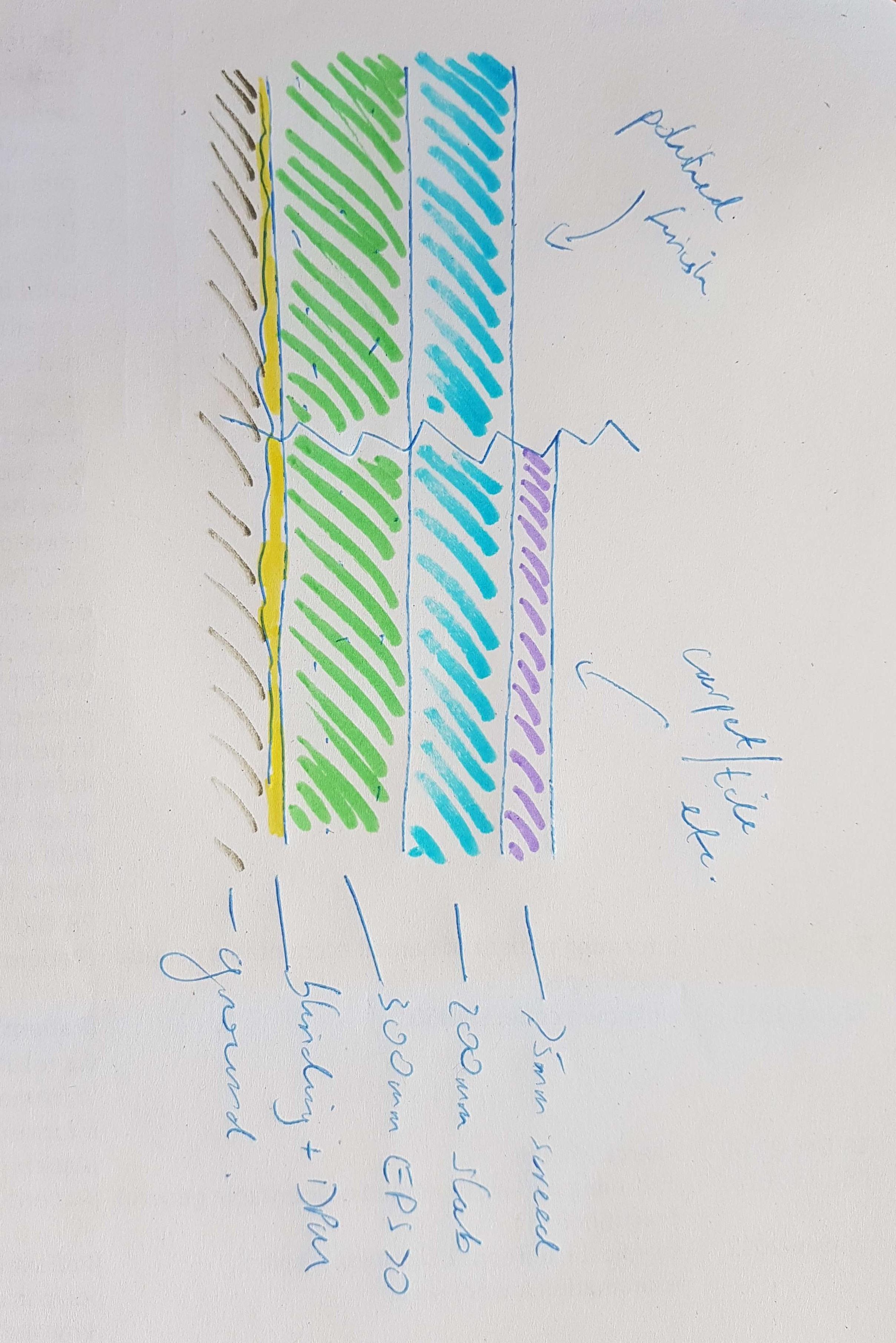

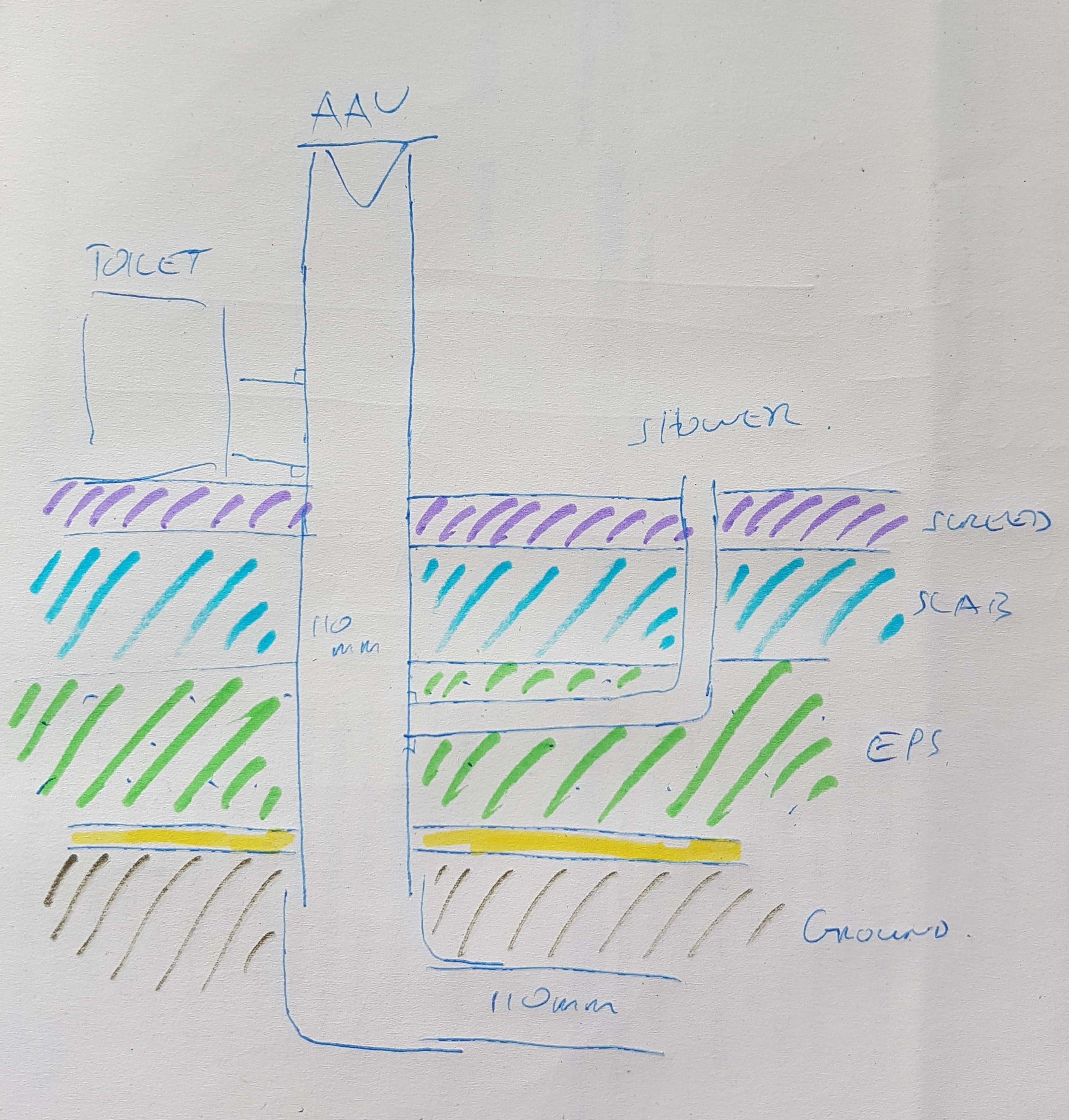

Tom Posted September 8, 2021 Share Posted September 8, 2021 My (proposed) floor make up is: ground - blinding-DPM/radon-300mm EPS70-200mm concrete- 75mm screed and my builder wants to run the 110mm drainage runs through the EPS layer rather punching through the DPM and running through the ground. Is this acceptable? I guess I'm worried about the loss of insulation in these areas (albeit less than half of the 300mm thickness). He is also saying we need to do the same for the narrower drainage pipes from showers and basins and T in to the 110mm in the insulation layer. Again, is this what's done? Seems to me too many joins with potential leaks somewhere I will be able to do naff all about once the slab in poured. I'm rapidly losing faith in my builder - not least as we have yet to get above floor level and he has already managed to pour one ICF wall in the wrong place. Not a good week this week ? Link to comment Share on other sites More sharing options...

saveasteading Posted September 9, 2021 Share Posted September 9, 2021 It might work. The loss of insulation is very small. My worry would be that this is an experiment. The pipes would have to be carefully laid to gradients. which could be tricky. On a concrete bed, and probably surround too. Then the upper insulation is sitting on a bed of concrete very locally and there could be differential movement. So no, I think this is a bad idea. Link to comment Share on other sites More sharing options...
Tom Posted September 9, 2021 Author Share Posted September 9, 2021 Thanks mate. Is it an experiment? I got the impression from the builder that it would be normal to do. The pipes would be in the insulation, at worst resting on the DPM/oversite and the concrete slab above is suspended rather than ground bearing, so the weight would not be taken by the insulation/pipes. Link to comment Share on other sites More sharing options...
saveasteading Posted September 9, 2021 Share Posted September 9, 2021 Explain please. If the concrete above is suspended, is it not still sitting on the insulation? Link to comment Share on other sites More sharing options...

PeterW Posted September 9, 2021 Share Posted September 9, 2021 @TomTrying to work out why you have 200mm concrete then 75mm screed on top ..?? Have you got a section drawing to share ..? Link to comment Share on other sites More sharing options...

Tom Posted September 9, 2021 Author Share Posted September 9, 2021 4 hours ago, PeterW said: @TomTrying to work out why you have 200mm concrete then 75mm screed on top ..?? Have you got a section drawing to share ..? It's' a long story.... well not that long actually. We have a suspended slab over the whole build and in the main living area are having this powerfloated and polished as the finished floor surface. In the rest of the build we have the slab but will be having other floor coverings but it was too much of as ask to get the builders to sort the levels out for different floor finishes, shower tray formers etc, figured it would be just simpler to add a screed. I don't have a section drawing unfortunately! Link to comment Share on other sites More sharing options...
Mr Punter Posted September 9, 2021 Share Posted September 9, 2021 You will need to be taking the pipework outside the building as soon as you can, but I don't see a big issue with it running in the insulation. It may be good to wrap it in compressible material so it is properly supported and does not deform. Link to comment Share on other sites More sharing options...

PeterW Posted September 9, 2021 Share Posted September 9, 2021 2 hours ago, Tom said: powerfloated and polished as the finished floor surface Never seen anyone powerfloat and polish a sand and cement screed. It doesn’t polish the same way as concrete as far as I am aware. Has this been shown to you ..? Link to comment Share on other sites More sharing options...
saveasteading Posted September 10, 2021 Share Posted September 10, 2021 16 hours ago, Tom said: I don't have a section drawing unfortunately! Can you sketch one then please, then attach as a scan or photo, as i am not understanding this. Where is the insulation for one thing. Link to comment Share on other sites More sharing options...
Conor Posted September 10, 2021 Share Posted September 10, 2021 (edited) We've a few short runs in through the screed insulation, but majority are below the slab in the hardcore layer. Make sure you tape the dpm well to the pipes. I'm assuming building control approved your drainage design? Edited September 10, 2021 by Conor Link to comment Share on other sites More sharing options...
Tom Posted September 11, 2021 Author Share Posted September 11, 2021 Massive thanks for the replies, all is very much appreciated. Sorry for the delay in getting back, bit of a crazy day yesterday. On 09/09/2021 at 19:24, Iceverge said: It sounds like a roundabout way of doing things. How thick are your other floor finishes? Haven't finalised other floor finishes but some rooms will be tiled, others wood and bedrooms carpets - so 20-30mm I guess. I just figured pouring the slab in these areas to take in to account these differences would be too big an ask - easier to do it with a screed at the end. On 09/09/2021 at 20:15, PeterW said: Never seen anyone powerfloat and polish a sand and cement screed. It doesn’t polish the same way as concrete as far as I am aware. Has this been shown to you ..? We're not pwerfloating the screed Peter, we'll be doing this to the slab in the other half of the build. 22 hours ago, saveasteading said: Can you sketch one then please, then attach as a scan or photo, as i am not understanding this. Where is the insulation for one thing. OK, have done the best I can with the children's felt tip pens! And also a diagram of what I think would be better than everything in the insulation: the 110mm passing through the DPM into the ground. The wastes from showers can T in to the vertical 110mm and travel through the insulation. The toilets can T in above floor level and be boxed in. Does this look reasonable? Link to comment Share on other sites More sharing options...

saveasteading Posted September 11, 2021 Share Posted September 11, 2021 The sketches are a great help. I am thinking that we have different understandings of what a suspended floor is. Your concrete slab appears to be sitting on a bed of polystyrene. Suspended would normally mean spanning freely from one structural support to another, and so is unlikely to be on top of polystyrene, especially an exact contact. If the slab depends on the insulation for support then, I would not be happy with cutting lumps out for the drainage. Your second sketch is more normal and appropriate. I would also question why the builder does not want to put the drains in the ground, which is normal and easy, and proven. What stage is construction at now? Link to comment Share on other sites More sharing options...
Tom Posted September 11, 2021 Author Share Posted September 11, 2021 Thanks mate. I was initially confused a bit by the proposed floor make up but it is a suspended floor as you describe above, in that it is supported on the perimeter by blockwork. The slab itself is spec'd to have two layers of A393 rebar mesh in it. It is designed to take internal blockwork walls laid directly on it with no need for extra footings etc underneath. The EPS is the lowest compressive strength available (EPS70) as it will not be taking any of the load from the slab. We went down this route as the ground we are building on is pretty much all made ground and this way we take all of that uncertainty over what is underneath out of the equation. It also means we can add/move blockwork walls with carefree abandon in the future if we were so inclined. 2 hours ago, saveasteading said: What stage is construction at now? We're just coming up to floor level now and doing the last bit of oversite preparation before putting the blinding and DPM down. One more question, where should I be aiming to bring the shower waste up - how close to our proposed shower location? I'm guessing we will run a shallow fall of pipework from this to the shower trap itself within the screed? Link to comment Share on other sites More sharing options...

saveasteading Posted September 12, 2021 Share Posted September 12, 2021 If the made ground settles, then the insulation will go down with it, and you will have a gap between insulation and floor. If this gets any draught at all through it then you will have lost the insulation effect. I am really surprised that this is being allowed by BC but more importantly, you should reconsider the whole thing for your own heat economy and comfort . Perhaps you can tie the ins up to the floor with wires. I'm also a bit confused by the drawing attached by Iceverge. Perhaps this is much simplified by the company producing it, (to sell insulation or pipes?). There is no mention of stone base, on which there would be blinding. then normally dpm on that before concrete/insulation/screed. Getting pipes through the floor at exactly the right position is tricky. what seems very precise at foundation stages can be annoyingly approximate when you find that a vertical pipe is too close to/too far from a wall. There is a lot to be said for keeping boxouts around the penetrating pipes, and adjusting/infilling later. Link to comment Share on other sites More sharing options...
Tom Posted September 12, 2021 Author Share Posted September 12, 2021 The ground isn't going to settle now, we've built back up and compacted well, there will be no possibility of ventilation under the slab either, so I'm sure it'll be fine. I think that's a good idea re keeping boxouts around the pipes. I think we'll do that when we pour the lab so we have greater scope for adjustment later on. Link to comment Share on other sites More sharing options...

saveasteading Posted September 13, 2021 Share Posted September 13, 2021 19 hours ago, Tom said: The ground isn't going to settle now, Up to you, but I suggest you get this cleared formally by the building inspector. Even 1mm of settlement (or other movement) and a gap will be created. Seasonal movement and drying of the ground could also make this happen, and it is then not resolvable. Link to comment Share on other sites More sharing options...
Tom Posted September 15, 2021 Author Share Posted September 15, 2021 On 13/09/2021 at 11:46, saveasteading said: Up to you, but I suggest you get this cleared formally by the building inspector. Even 1mm of settlement (or other movement) and a gap will be created. Seasonal movement and drying of the ground could also make this happen, and it is then not resolvable. Thanks mate, it's all been passed by our LABC. The ground has been compacted well. A few mm drop would not be enough for convection currents, esp as it's all sealed, and the air gap might even improve U values! Link to comment Share on other sites More sharing options...
