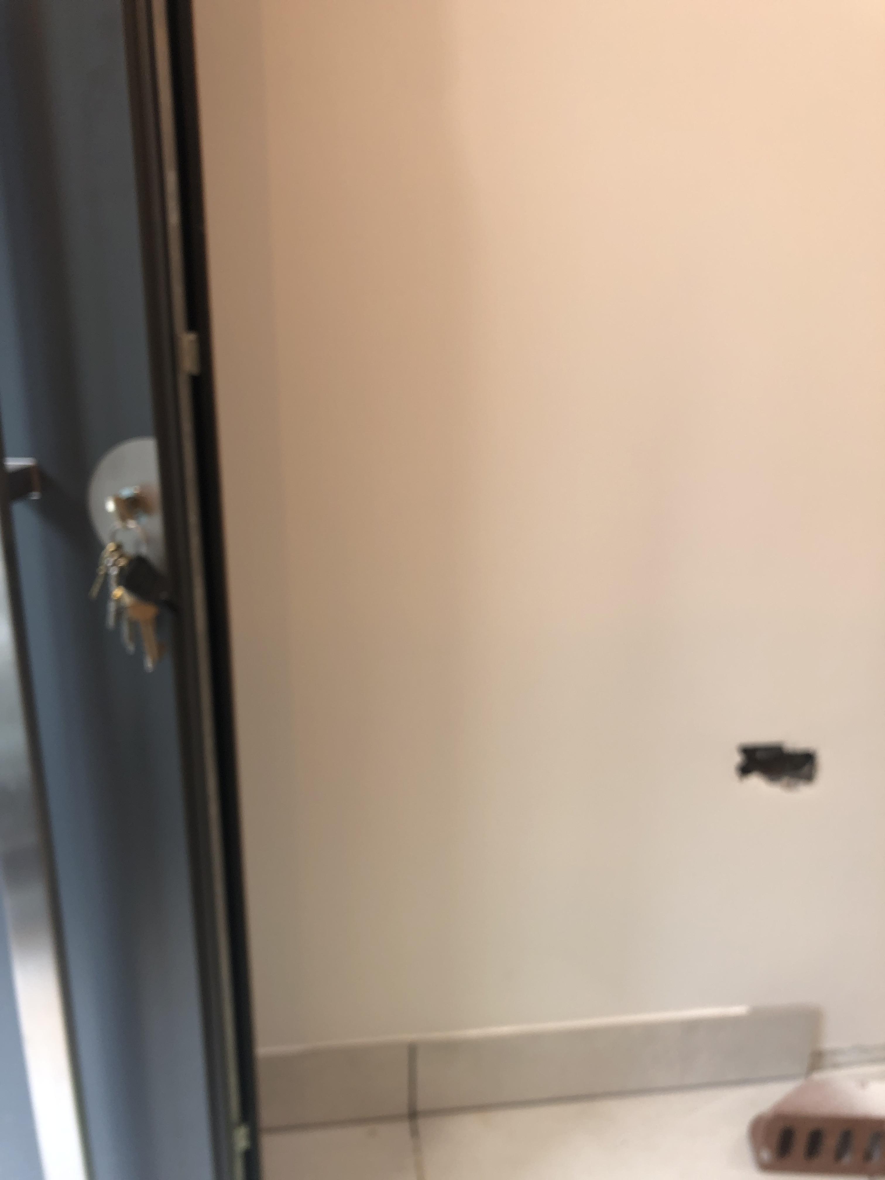

My next question is how to wall mount this . Wall is plasterboard on osb - can’t guarantee where the studs are . I want a no visible fixing ; but don’t want it wobbling / moving . What’s best to use ??
Posted
Keyhole plates on rear of coat hook block, screw into OSB. Majority of load is in shear so no problem with heavy coats
  • Thanks 1
Posted
keyhole hook. They will fit into the back of the board and then fit flush to the wall. If you’re desperate to keep it from moving then use a couple of blobs of cheap silicone at the bottom behind the board and you can remove at a later date.

Well ! As you know ! . I tried every stud detector that exists - they are all crap . The positioning of this rack has to be between the door fully open and a socket - so you can bet a zillion quid there’s no stud in between them . Just aswell I osb ‘d everything precisely for these type of issues ( though I was mocked for doing it )
Posted
8 minutes ago, PeterW said:
No you mount the plate to the back of the wood - recessed - and then you put a screw in the wall.
Oh I see ? I’ll get the company to do that also ! . Presume just 2 recessed hooks near the top is sufficient?
Posted
The company is being really good ! ( must know I’m an inept joiner ) . I can send them 1 hook and the recessed hangers - so they can machine them perfectly! ?
