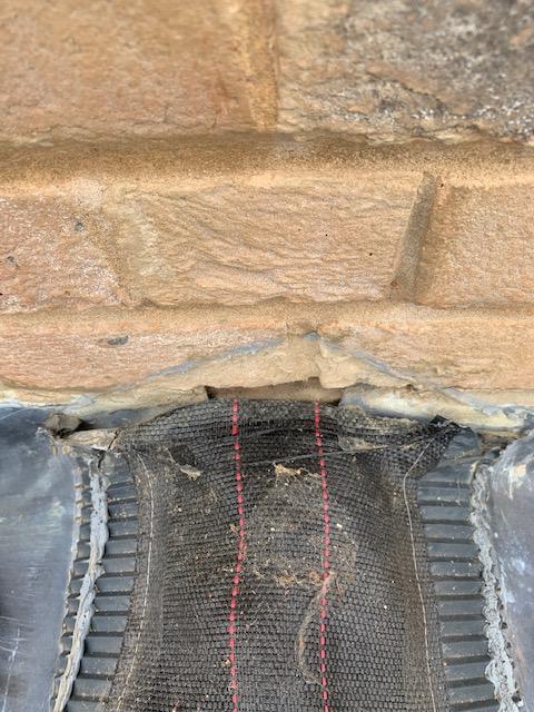

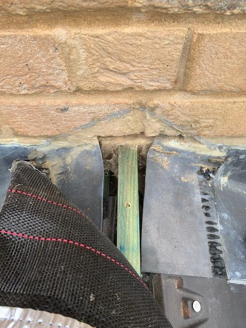

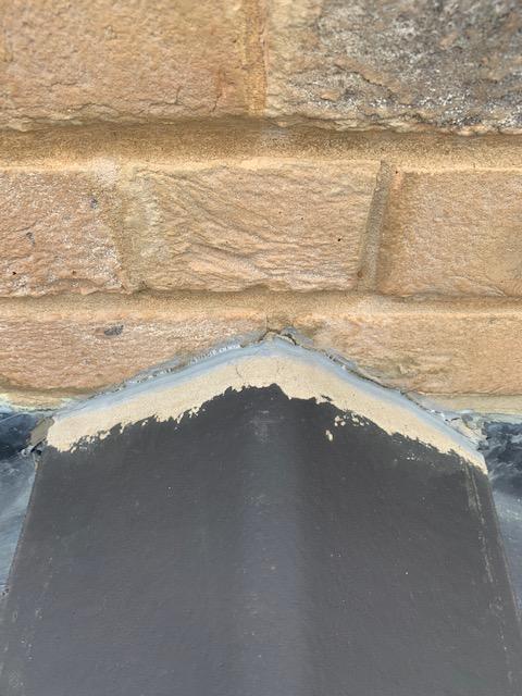

James94 Posted September 2, 2021 Posted September 2, 2021 Hi all, noticed the internal blockwork was getting wet a while ago, only just been able to get a tower up to have a look. Taken a few pictures for you to have a look at and hopefully offer some advice. I have read other posts about lead trays, I know there hasn’t been one fitted as I wasn’t aware of them during the build and the Brickki didn’t have a clue. Do you think The issue would be from the lack of lead under ridge or will the stack have to come down, which I could do without as I don’t have any bricks left. any advice would be greatly appreciated. Regards. James
Declan52 Posted September 2, 2021 Posted September 2, 2021 It needs more lead so the complete pitch is covered. From the pics it looks like silicone was used and that ain't going to last like that on a roof. Cut into the bed of the bricks over the ridge tile and slide a piece of lead and then hammer it down to form the shape needed to go up and over the tile. To hold it in place cut small pieces of lead, 50*20mm and fold these over and over like a Swiss roll and then hammer them into the cut above where you put the lead in. This will hold the lead strip in place. 3 bits would be plenty. Fill the rest with lead mate. Much better than silicone. 1
ProDave Posted September 2, 2021 Posted September 2, 2021 Is this a new build? HAve you just bought it? History / conttext please. As above the bridging piece of lead is missing. Shockingly bad by whoever put that roof on, total bodge that they have done. But a relatively simple fix to put it right for a competent roofer.
James94 Posted September 2, 2021 Author Posted September 2, 2021 Thanks for the response, it was built last year and we noticed it was leaking a while ago, just not been able to do anything until we had finished with scaffolding from round garage. we took ridge of today and we was shocked to see there was no lead bringing the ridge, just assumed it would be there so yeah that will be first job then. do you think this might cure the issue as I know there is no lead tray and I’m half expecting to have to take it down. Only problem there is I have no brick left and not sure if they’d clean up. Regards. James
ProDave Posted September 2, 2021 Posted September 2, 2021 You should not need to take any bricks out, just rake out the mortar one brick up to slot in the missing bit of lead and then re point it. And send the bill for the remedial work to the roofer that "forgot" to fit it?

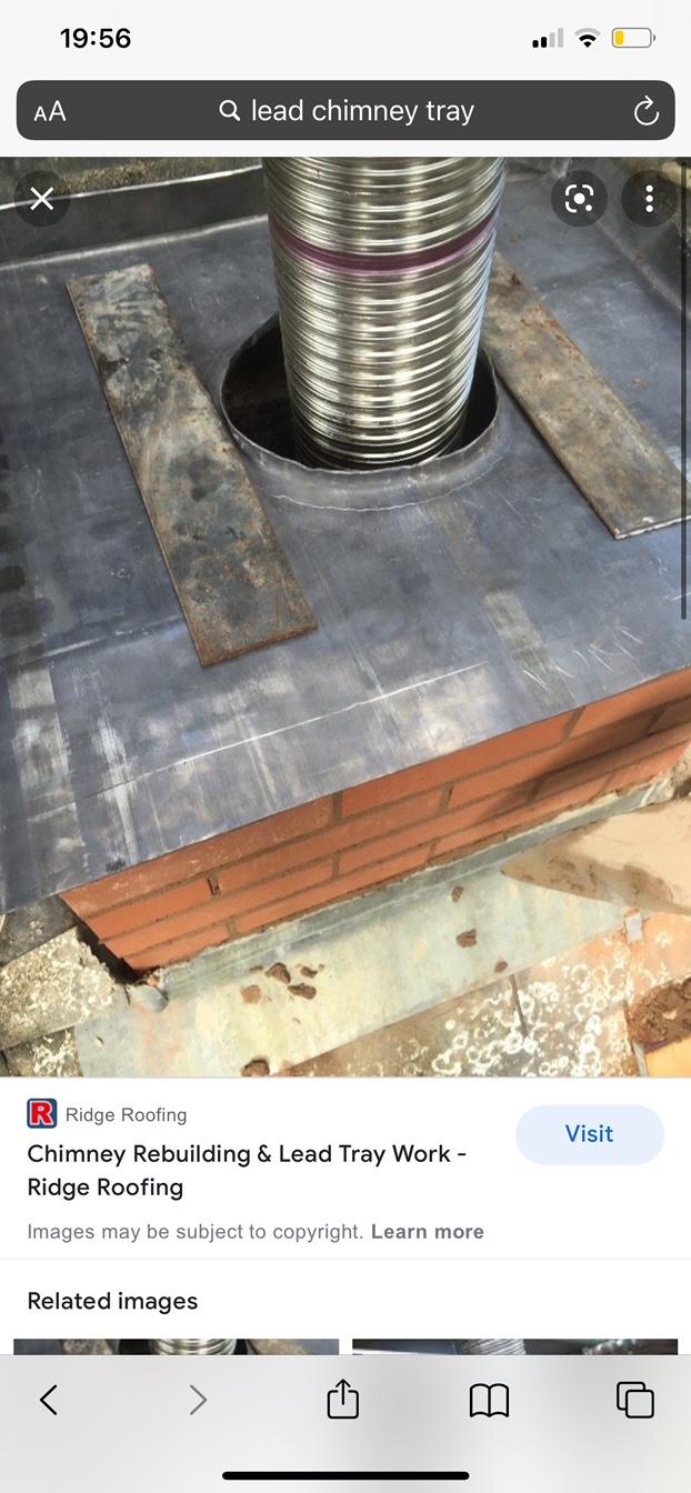

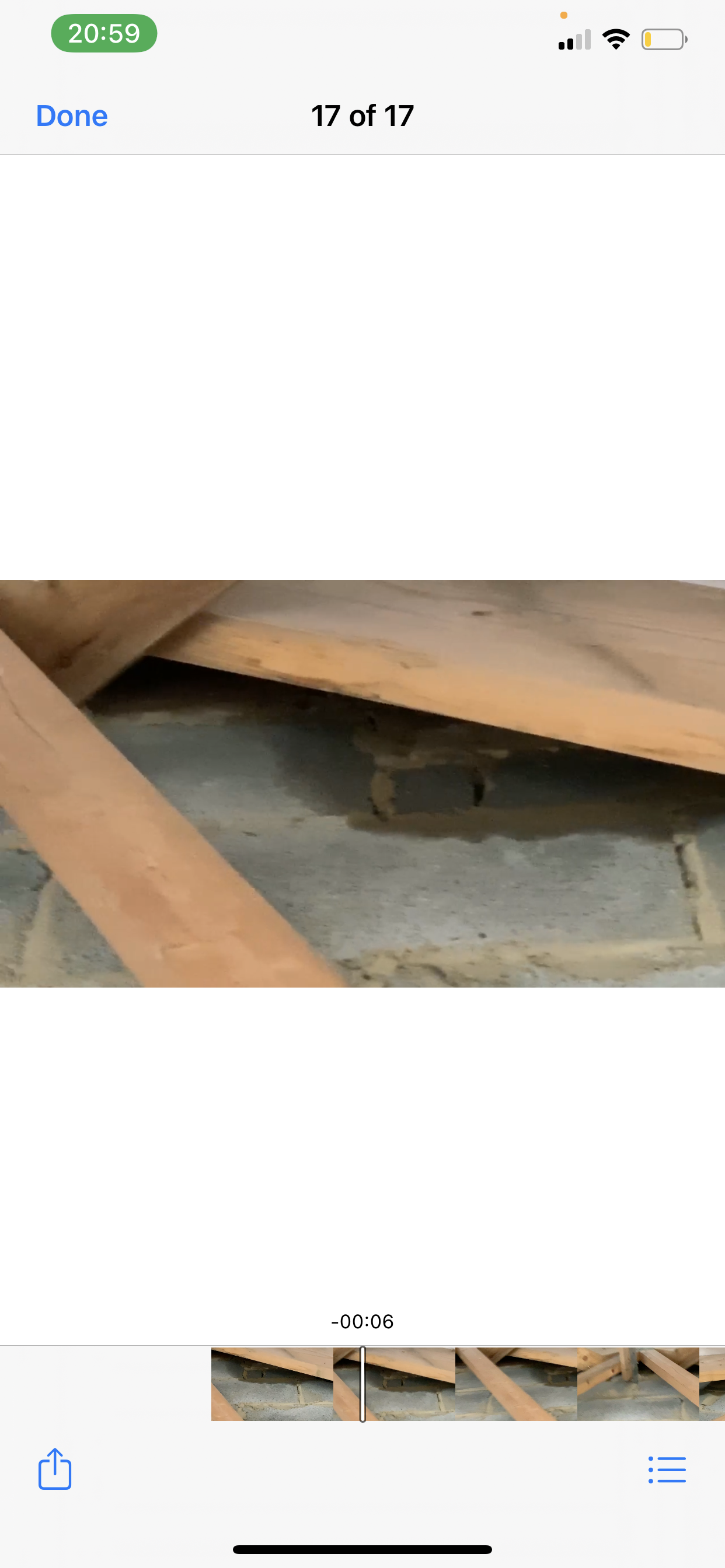

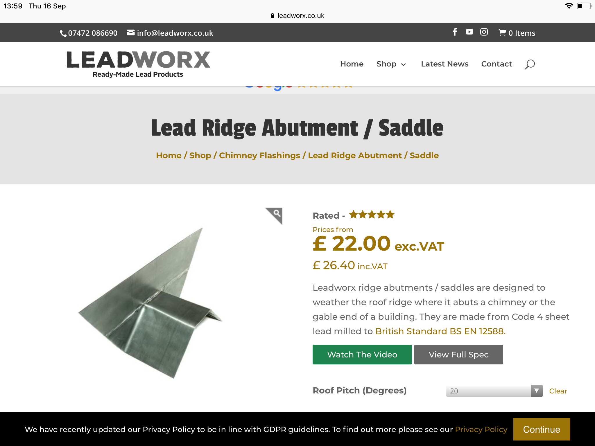

James94 Posted September 2, 2021 Author Posted September 2, 2021 Thanks for your reply, we are either going to buy a lead ridge abutment or get a section and mould it into place. Since I noticed the damp (see pic)almost a year ago I assumed it was because the bricklayer hadn’t installed a lead tray(see pic). So whilst I have a tower up should I take the chimney down and put one in? Or do you think the lead ridge abutment will cure this dampness? Regards james
tonyshouse Posted September 2, 2021 Posted September 2, 2021 I would like to see a lead saddle under the ridge tile that abuts the brickwork.
James94 Posted September 3, 2021 Author Posted September 3, 2021 Thanks for the advice, so first job is going to be lead saddle, hope this cures the issue would hate to have scaffold taken away and it still have the damp issue. Regards. James

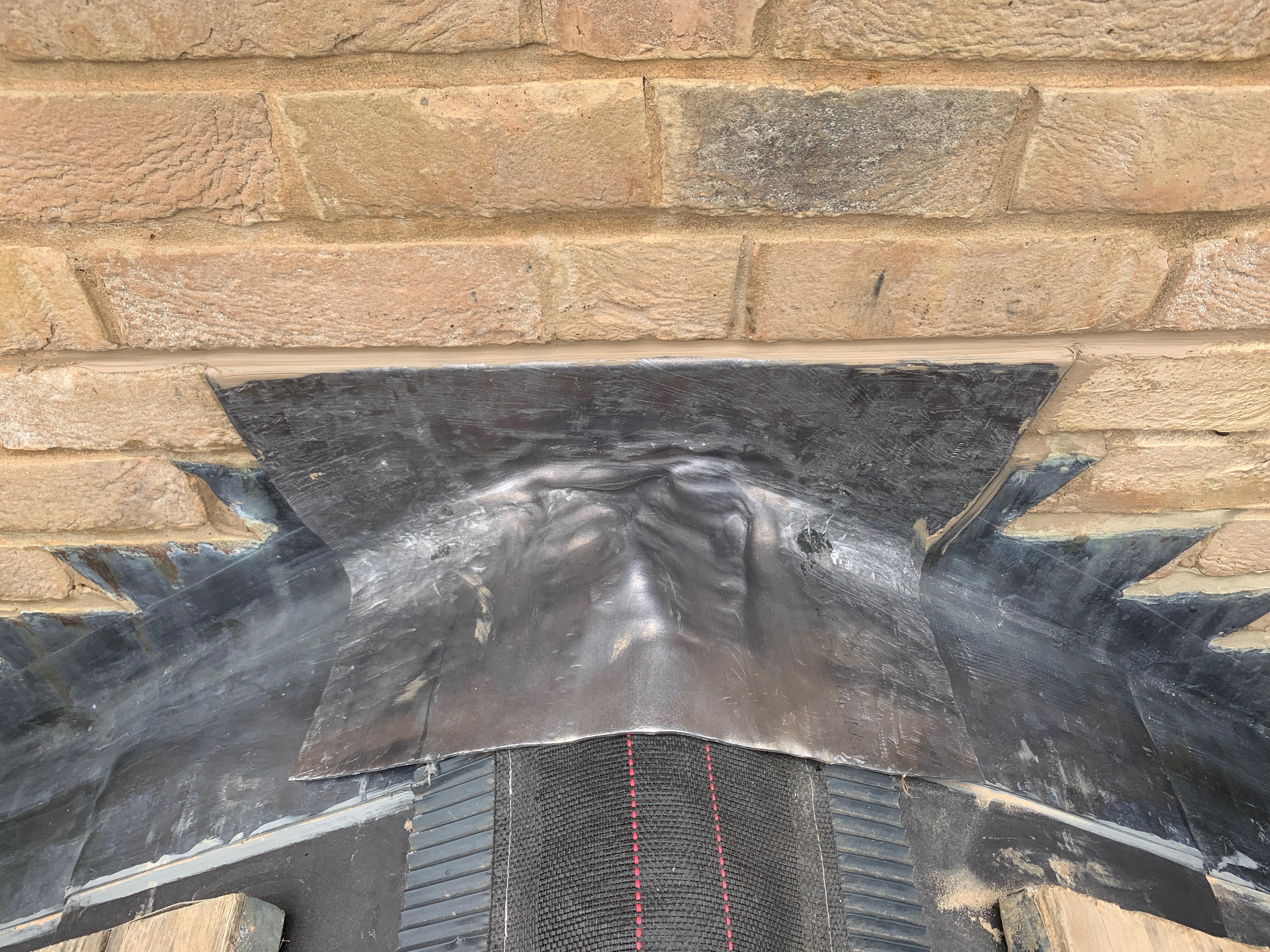

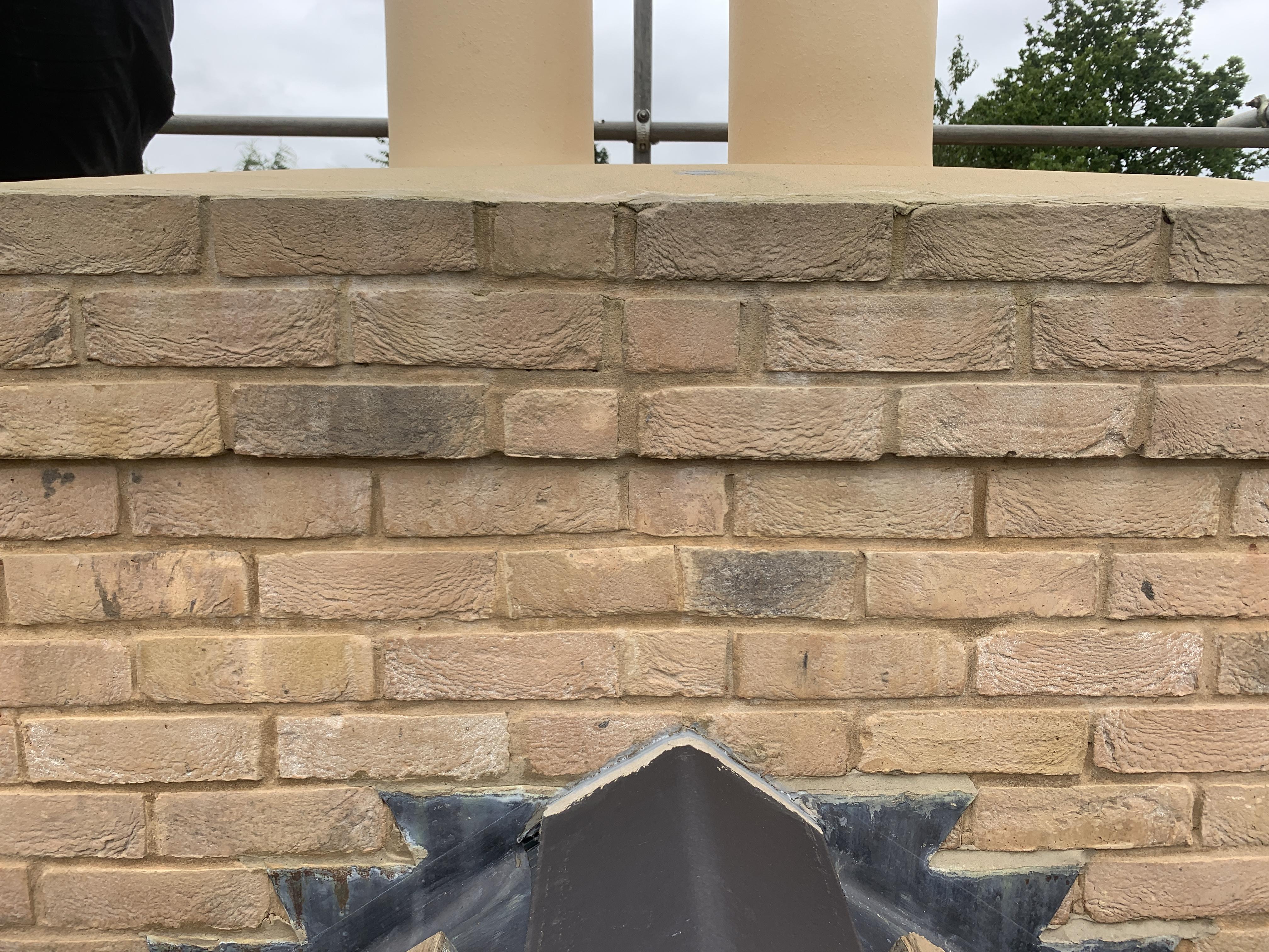

James94 Posted September 16, 2021 Author Posted September 16, 2021 Just an update, picture of what we have done a little crude but seems to of worked ok, had quite a bit of rain and wall seems to be dry for now. thanks for everyone's help. Regards. James
Mr Punter Posted September 16, 2021 Posted September 16, 2021 16 minutes ago, markc said: That looks much better Although it does look a bit like marzipan. Be fine when the ridge tile is on.
markc Posted September 16, 2021 Posted September 16, 2021 9 minutes ago, Mr Punter said: Although it does look a bit like marzipan. Be fine when the ridge tile is on. Haha, that’s why I said better, not good lol
James94 Posted September 16, 2021 Author Posted September 16, 2021 Marzipan? I can’t see any difference between the two?
