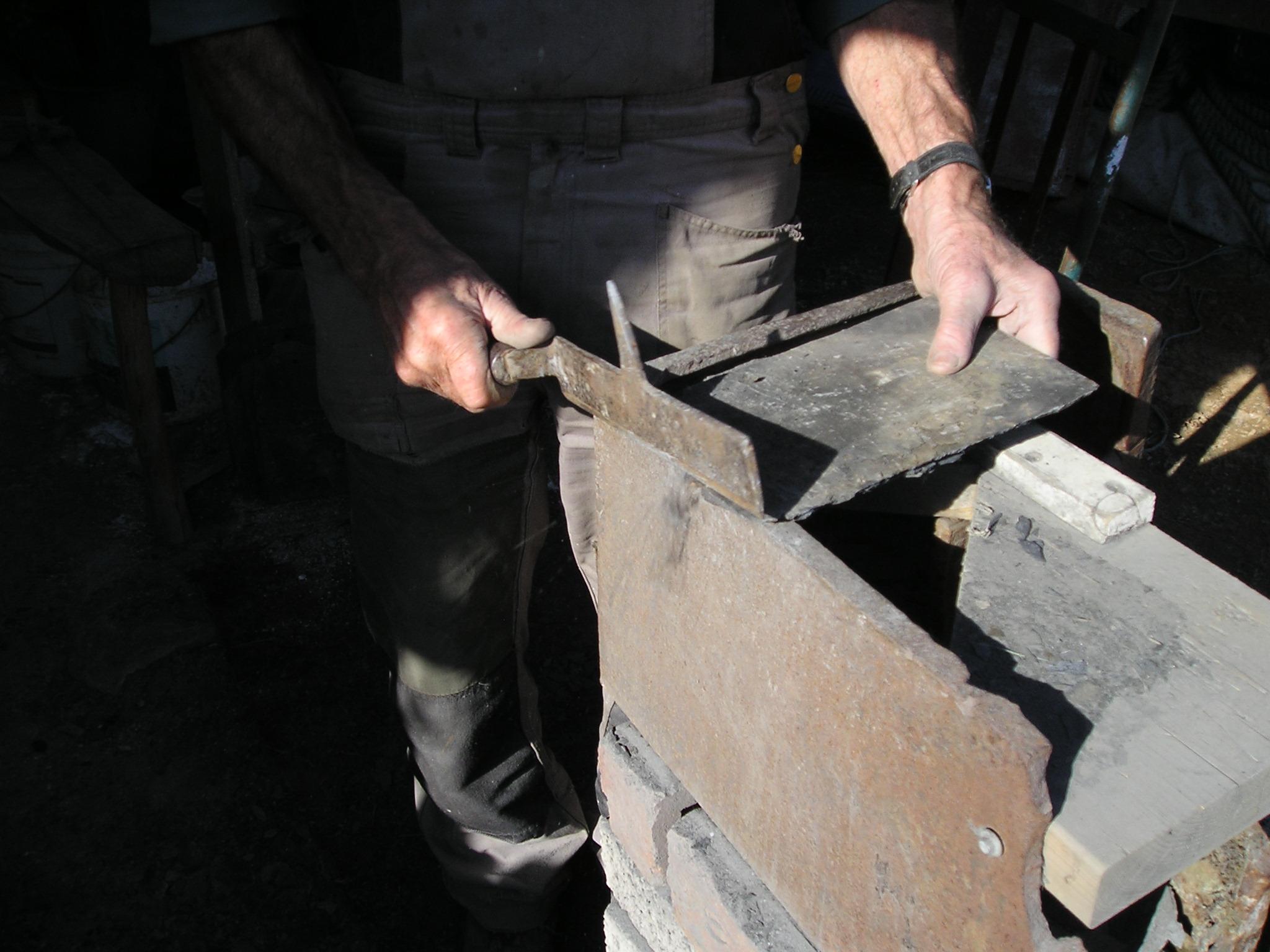

scottishjohn Posted September 1, 2021 Share Posted September 1, 2021 Just about to do my first slate roof on the old explosives building .as soon as I get walls+ gables back up and rafters made etc never done slates before - was going to go for tin roof -- but seems a shame not to keep it as it was including a 200year old refurbed sky light skylight was made in dumfries when there were iron works al over - any suggestions for a good slate trimming cutting tool? Link to comment Share on other sites More sharing options...
ToughButterCup Posted September 1, 2021 Share Posted September 1, 2021 Morning John . . . Have a look at this channel . Helped me no end 1 Link to comment Share on other sites More sharing options...
Conor Posted September 1, 2021 Share Posted September 1, 2021 Our Slater's only use a Stihl saw for cutting slates. For trimming corners etc they use snips. 1 Link to comment Share on other sites More sharing options...
Roys Posted September 1, 2021 Share Posted September 1, 2021 When I did mine, I used a 9” angle grinder with a diamond disk, hot knife through butter. 1 Link to comment Share on other sites More sharing options...
joe90 Posted September 1, 2021 Share Posted September 1, 2021 (edited) I use one of these (well similar anyway) they leave a Proper edge (you cut the tile from the back) and leaves a ragged edge like they come with. https://www.ebay.co.uk/itm/114928777104?hash=item1ac249f790:g:6KMAAOSwgZJf-zuR Yes an angle grinder is good but leaves a “cut” edge. When I had my roof done they used hooks and not nails, I was not sure about this but at least you can replace a slate whereas when nailed it’s very difficult. Try watching this….. I would not use nails again ? Edited September 1, 2021 by joe90 1 Link to comment Share on other sites More sharing options...
makie Posted September 1, 2021 Share Posted September 1, 2021 Use a slate knife, anything else will not leave a good finish. Never use a stihl saw or grinder either, those are for people that can't slate. It will go through them but it leaves a very poor finish and wont look good. 1 1 Link to comment Share on other sites More sharing options...
Roys Posted September 1, 2021 Share Posted September 1, 2021 The angle grinder cut edges on my roof are hidden as they are either under the ridge tile or under the slate gable edge trim, I also used slate and 1/2 so that the alternative row ends had a larger slate as I didn’t want the wee 1/2 cut slates. Scottish roof so it was nailed directly onto sarking boards with a breathable membrane. 1 Link to comment Share on other sites More sharing options...
scottishjohn Posted September 1, 2021 Author Share Posted September 1, 2021 9 minutes ago, Roys said: The angle grinder cut edges on my roof are hidden as they are either under the ridge tile or under the slate gable edge trim, I also used slate and 1/2 so that the alternative row ends had a larger slate as I didn’t want the wee 1/2 cut slates. Scottish roof so it was nailed directly onto sarking boards with a breathable membrane. thats how mine will be --no batons Link to comment Share on other sites More sharing options...
Cpd Posted September 1, 2021 Share Posted September 1, 2021 (edited) Slate knife all the way. Edited September 1, 2021 by Cpd Link to comment Share on other sites More sharing options...
