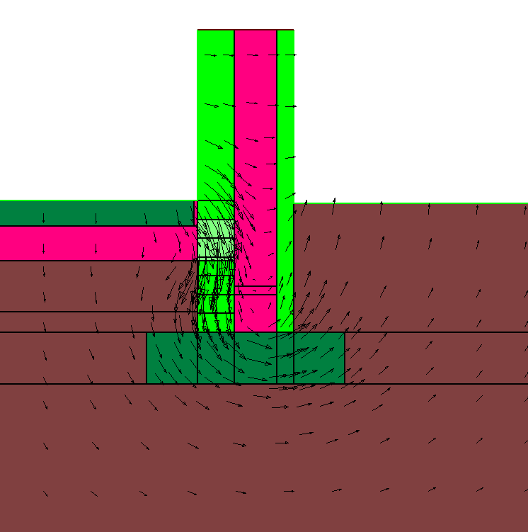

Iceverge Posted September 1, 2021 Posted September 1, 2021 Our foundation detail. Note our insulation in the cavity extends a good distance below the floor level and this design mitigates the worst of the bridging on it's own. In a narrower cavity omitting the thermal blocks is likely to be more significant. You could add a thin layer of EPS below ground level outside the wall if you're concerned, or even top up your roof insulation to compensate. However the difference to the total heating load of the house is still likely to be in very low single digit percentages. It'll be completely negligible compared to airtightness and your choice of windows etc. On a non passive house you'll never notice. 1

ADLIan Posted September 1, 2021 Posted September 1, 2021 Moving from aircrete to dense concrete will increase U-value from approx 0.25 to 0.28 (exact wall construction not known). As an area weighted average for the whole wall area the impact is probably negligible. The effect at the floor/wall junction can only be estimated if the psi-value is known and this will depend upon the thermal properties of the materials and the exact geometry of the junction. Only if you know the psi-value that was used in the original energy assessment can you estimate the effect of the different block type. 1
WWilts Posted September 1, 2021 Author Posted September 1, 2021 (edited) On 01/09/2021 at 10:16, ADLIan said: Moving from aircrete to dense concrete will increase U-value from approx 0.25 to 0.28 Expand Thanks. What would be the U value difference for the perimeter upstand + inner leaf only please, aircrete vs concrete? Probably a negligible point, but interesting to nerds like me. The mortar of the inner leaf probably offends as much as anything else. Edited September 1, 2021 by WWilts
ADLIan Posted September 1, 2021 Posted September 1, 2021 It's not a U-value at that point it is a linear thermal bridge or psi-value that is calculated using 2D thermal modelling. Doubt the thickness of the perimeter upstand insulation would have any effect. That detail looks to be very similar to the Accredited Construction Details giving an 'approved' psi-value of 0.16 W/mK. You need to check what psi-value was used in the energy assessment 1

ADLIan Posted September 1, 2021 Posted September 1, 2021 The ACD figures for linear thermal bridges are worst case so would use dense block inner leaf at the floor/wall junction so the 'mistake' is covered in the energy assessment. The use of aircrete would improve things slightly. 1
